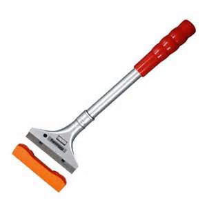

never use a heat gun on a glass window! one of these (see photo) works great. us a good sharp blade and a little windex with it. if there is a tint applied to the glass, it might be an issue put for regular glass it won't hurt it in anyway
