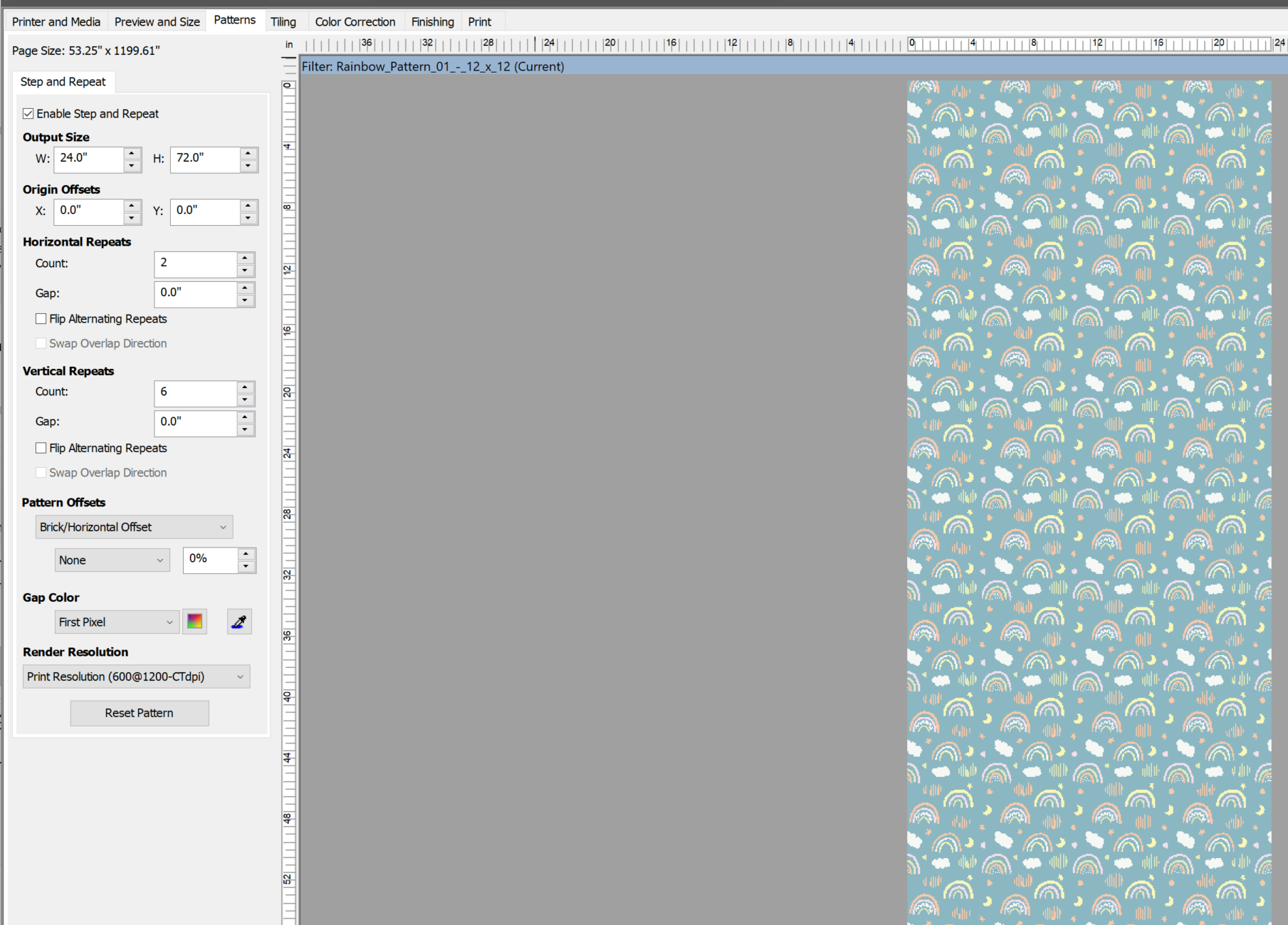

I dabbled in wallpaper for a bit. I'm guessing youre talking Etsy... Most people on there do 27" wide - a 26" Pattern and then 1" overlap. This is because most use 30" rolls... And that gives enough space for cutting marks. it works with any size width you want - When I did it, I'd have a large repeating pattern that can be up to 50" wide by whatever tall... but I'm used to installing wide panels - give a customer a 50" x 120" Repeating pattern and watch all the cussing you get in your e-mail.
Setting it up in onyx is super easy.
Attaching a 12" x 12" file for simplicity stake... It's a crappy free wallpaper I downloaded from a stock site... so it looks kinda trashy, but for this example it'll work perfect.
I have it setup as 12" x 12" - Then you just goto step and repeat... And so long as you work in increments of 12 (The file size) Every side will always match and repeat with the other side.
Now since you want to overlap... you tell it to do 25 for output size", and it'll add an extra inch for bleed. Just always keep the height in 12" increments - IF someone has a 92" wall, they can buy a 96" roll and cut 4" off the top.
Now you can get fancy - You can goto finishing > marks and generate cut lines for your graphtec / summa, so you're not hand cutting. And all this can be setup in a quickset so it's all automatic, and you just go in and tell it what output size to use and thats it.
Its very easy to do in onyx. Obviously it works with bigger graphics so you dont have so many repeats. and it doesn't look as trashy as the below one.. lots of floral patterns on etsy setup as 24" wide by 24" tall, or 36" tall, etc. same concept... just need to change things a bit - and obviously if your pattern is 24" tall, you have to sell in 2 FT increments rather than 1 FT increments.
