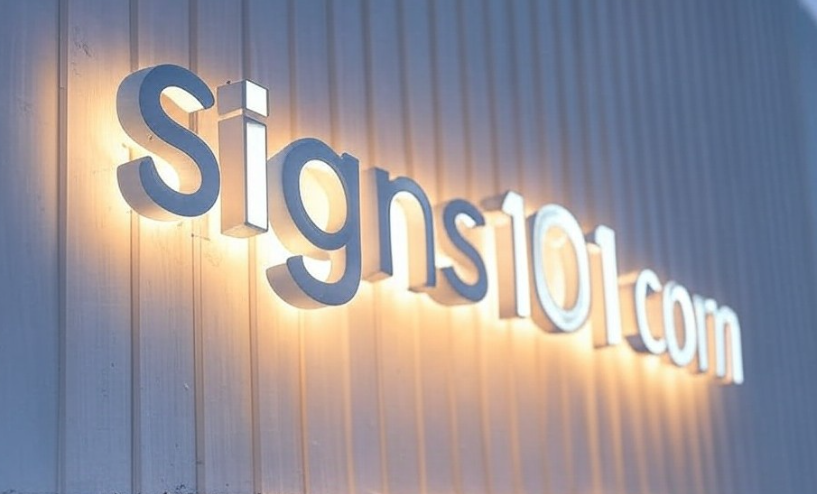

Wondering if the light does weird things when you install Reverse Channel Letters on Corrugated Steel Wall? They are 38 inch tall letters if that makes a difference.
You could always put a backer of some against the corrugated wall to catch the light on an even surface. Probable would need to outline the letters a bit. If you did one solid piece you could mount the whole thing in one shot.
MikePro
i like it. its no secret the wall is corrugated, so why not show it off with some killer deflections?
*tip: map out the high spots, 4-6"spacing/etc., and utilize for your mounting pattern so you don't have to jump around between highs/lows or the cursewords that come with having to drill out the corner of one of the ridges.
