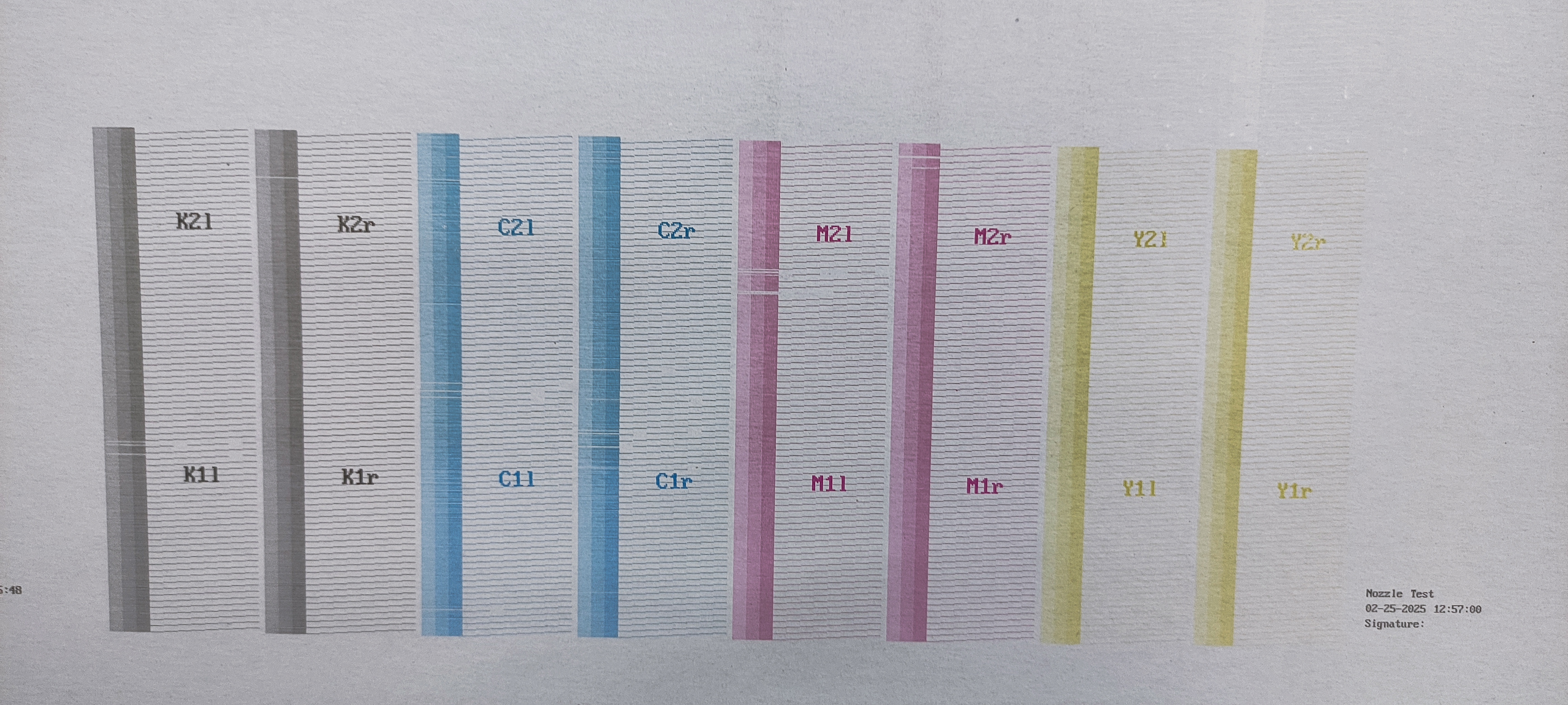

Vasilis
So the machine is the Handtop UV flatbed i have no idea about the model exactly i am working in this machine about 5 months now and they bought it 2019, the one magenta-yellow is 1 week old(M1) the other one(M2) is about 3 months and the black-blue(K1-K2) is the first from 2019. So everything was fine until last week Monday we had some power issue at the building but no problem occur, them the next morning that we start and all the PH was a mess exept the W1-W2. So we spent a full day cleaning then we change the M1 with a new and the K-C is the best i did without flushing. I think about the power because they said to me that the UPS was to expensive to buy:banghead:

Smoke_Jaguar
I recognize that nozzle check pattern, never heard of the printer brand, however. Control electronics are definitely HosonSoft or a copy of that. Check your capping station and make sure everything looks good. Probably not going to be an electrical fault in the head itself but might be air in the head. Gen5 heads have 2 ports per channel, are they connecting both ports to the same supply line, or is one port blocked/capped off? To purge a head, sometimes they have a port you can put a syringe in to pull ink through the head to prime it.
Gen5s tend to be pretty robust, check your filters as well if there are any. Also, try a head soak and wipe down the nozzle plate thoroughly. Make note of the nozzle checks throughout the day and see if the blocked nozzles are moving, or staying the same. If the missing nozzles move, things like ink starvation and air in the lines are more likely. If it's static, might have chunks of ink lodged in the head.

There is certainly some issues with the K1 & K2 l, both C and Magenta M1 & M2 L Heads, probably what is causing the issues. Although I don't have a UV printer, I would imagine these would have a capping station like our Eco-Solvent Printers, what is the condition of it / them and how old?

Thank a lot for all your answers!!! The machine don't have capping station it is just the waste tray and on top is the PH, the way that they told me to close the machine at the end of the day is that i clean the nozzle plates with the cleaning solution and the clean wipes then i do the daily test to check the results and i purge so it will have drops of ink at the nozzles to hang and thats all.
The K1-K2 is not much of a problem because the jobs that we do doesn't require very good quality especially wehn we print on a packing paper that from its nature is not smooth.

The missing nozzles stay at the same spot so as everyone suggest they are clogged. But now the problem is that they don't let me do the flush because they scared for the worse and we accept it as they say for now. :rolleyes:
