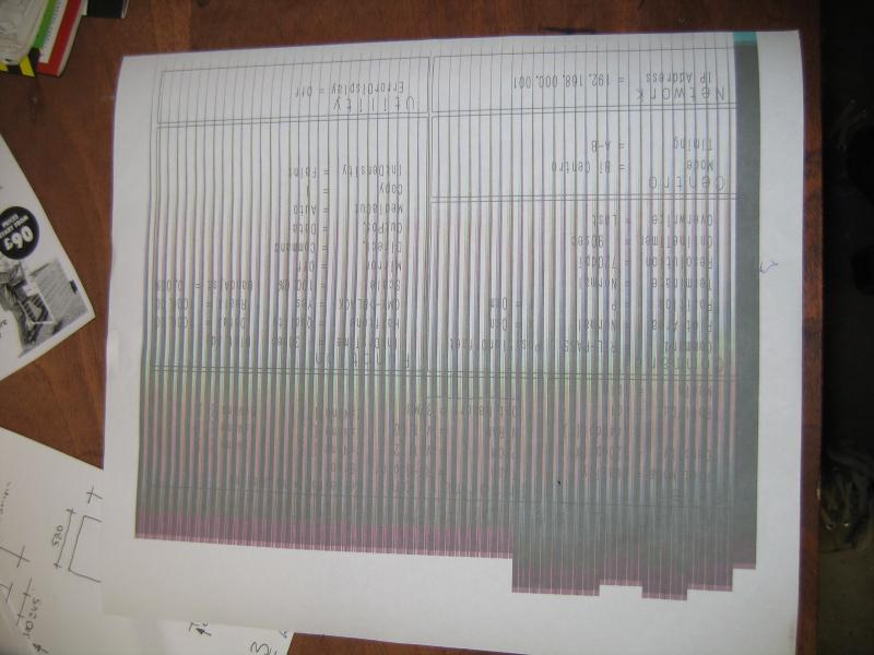

I bought a used Rockhopper 62 that was meant to have been converted to ecosolvent. Turned out that in the conversion the pump had not been changed, this lead to an ink spill and a cooked motherboard. I have no recourse with the seller.
After replacing motherboard, heads, dampers, pump and capping station and most other bits I now have the printer turning on.
Started to get the error e072 and e074, Y-current and Y-timeout. I tried all the fixes suggested in the forums (yes i have looked through all 54pages) and eventually contacted Randya direct. He suggested a few fixes but it was reseting the home that did the trick!!!!!
Now I have a printer that turns on but the nozzle check is very dodgy, can anyone help with this????
