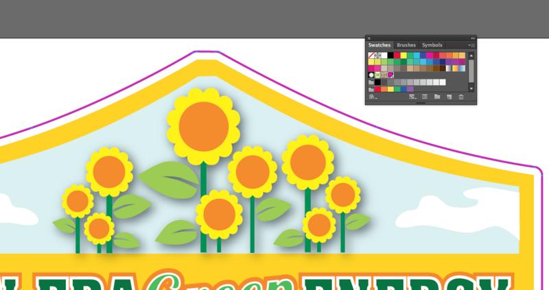

I have been using Illustrator to create my art and have loaded in the VersaWorks CutContour. i make my image, then i make the outline and place it in the back with a fill of none, stroke is CutContour. When i bring it to the Roland I don't get the marching red ants that usually indicate the cut line. I've done it before, but this project refuses to cooperate. Any suggestions to my dilema? Thanks so much for any insight.

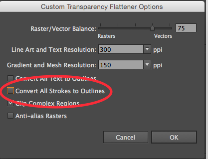

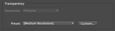

Are you saving as an .eps file? If so does the "Custom" dialog appear as clickable? If that is the case then make sue "Convert Strokes to Outlines" is not checked. If that doesn't work try placing the Cut Paths on their own layer.
