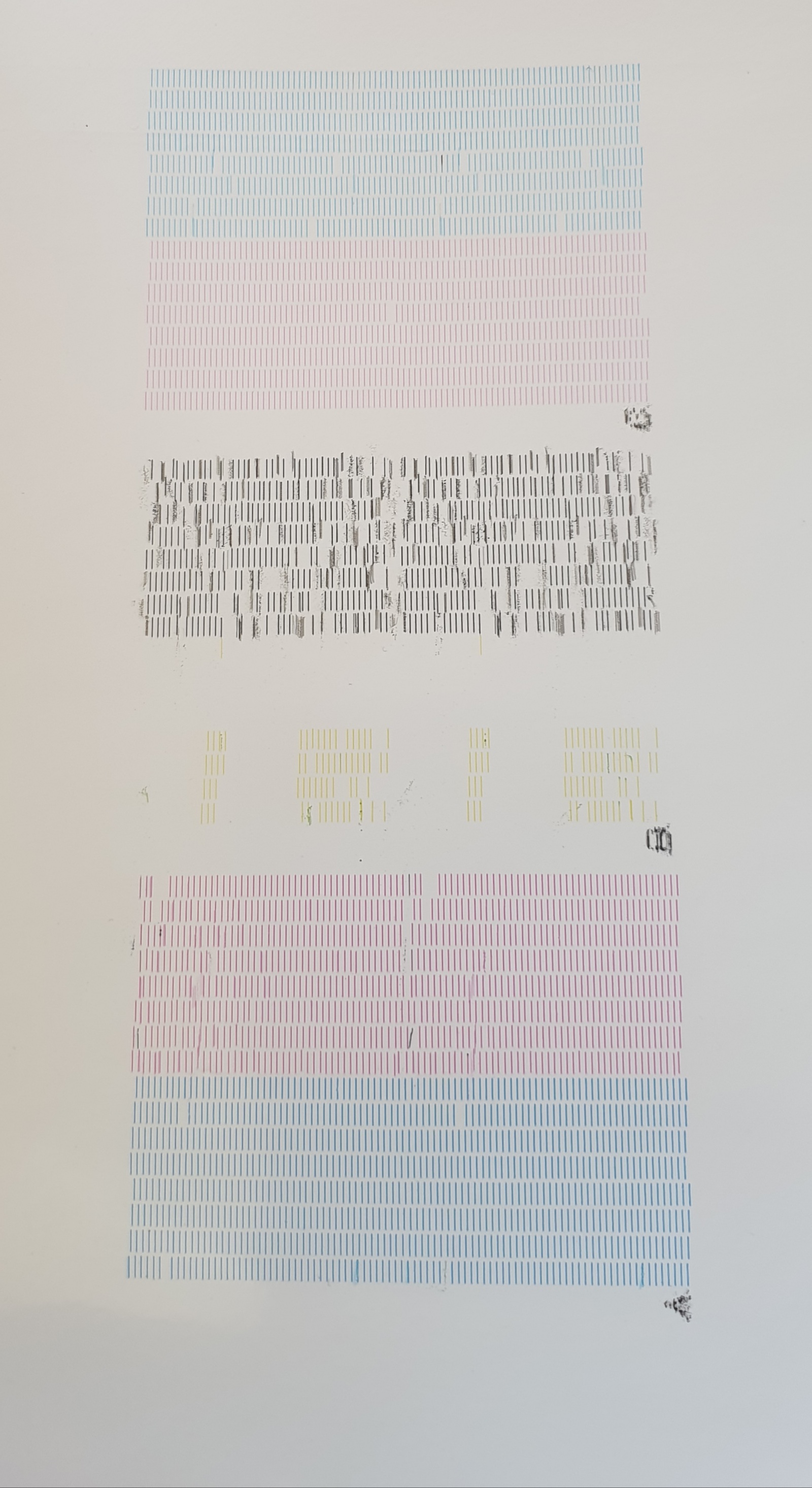

I'm having print issues with my Roland Pro 3 XC 540. The black and yellow are not printing correctly. I've tried all the cleaning methods but didn't fix it. I did the test print and it proved likewise. Please any suggestions on how to fix this issue would be greatly appreciated.

Remove the Lc and Lm heads and swap them in the black and yellow positions. Do a realignment and use a cmyk icc profile when printing. Doing this will get you up and running and then look at replacing those two heads later. Alternatively replace the two heads now
Anointed
Thank you for the quick response. I have a Tech guy giving me a quote to fix it and if it's reasonable I will let him do the job but if not then I will do as you have suggested. Thanks again!
