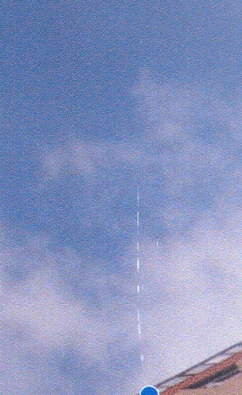

We have a Roland SC-500 printer, using Roland ColorChoice 4.5 v2 on a Windows XP machine with 256mb of ram.
I was playing around yesterday trying out different profiles and I couldn't get rid of the grainy dithering in the prints. I've seen this type of printer on youtube doing some lovely prints and was wondering why this one isn't.
We normally print on glossy vinyl on a role, and sometimes heavy duty banner materials. The banner materials seem to absorb the ink better, but you can still see some graininess in the print.
When I was testing out different profiles some of them looked like the areas were cracked. Some of the solid colours were no longer solid but had other colours mixed in, I wouldn't expect to see so much red mixed in with the blue.
Also, when I was doing different patches, with different profiles I noticed that the ink was smudging on the text so it has little lines going off of it.
When I was printing with one profile, I changed the settings from Normal through to Super and Photo, the ink was just placed on thicker, it still had the graininess.
The black seemed to be very thick and layered heavily compared to the rest of the colours too.
Other factors:
The room isn't heated constantly.
Before we print we turn on a heater, which warms the room within 10 minuets.
We do have a heat plate, but if it goes past 30 degrees it buckles the vinyl.
I would appreciate any suggestions you might have!
