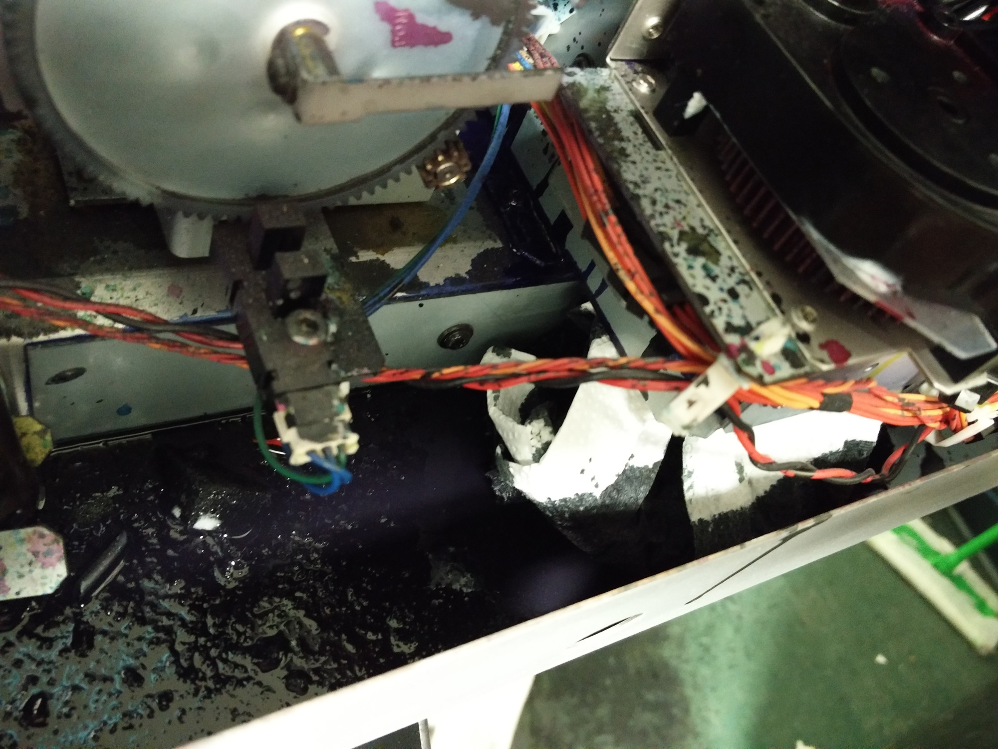

Hey guys and gals, anyone experience ink flood when the change head and fill ink? Its leaking somewhere behind pumps, trays full of black, what stayed behind as it leaked out the holes in case...where to begin looking???? Did I possibly "blowout" a line oor seal while I was clearing ink line?
Thanks in Advance

pump line is probably busted. Install a new cap top and pump and you’ll most likely be in good shape after that.
