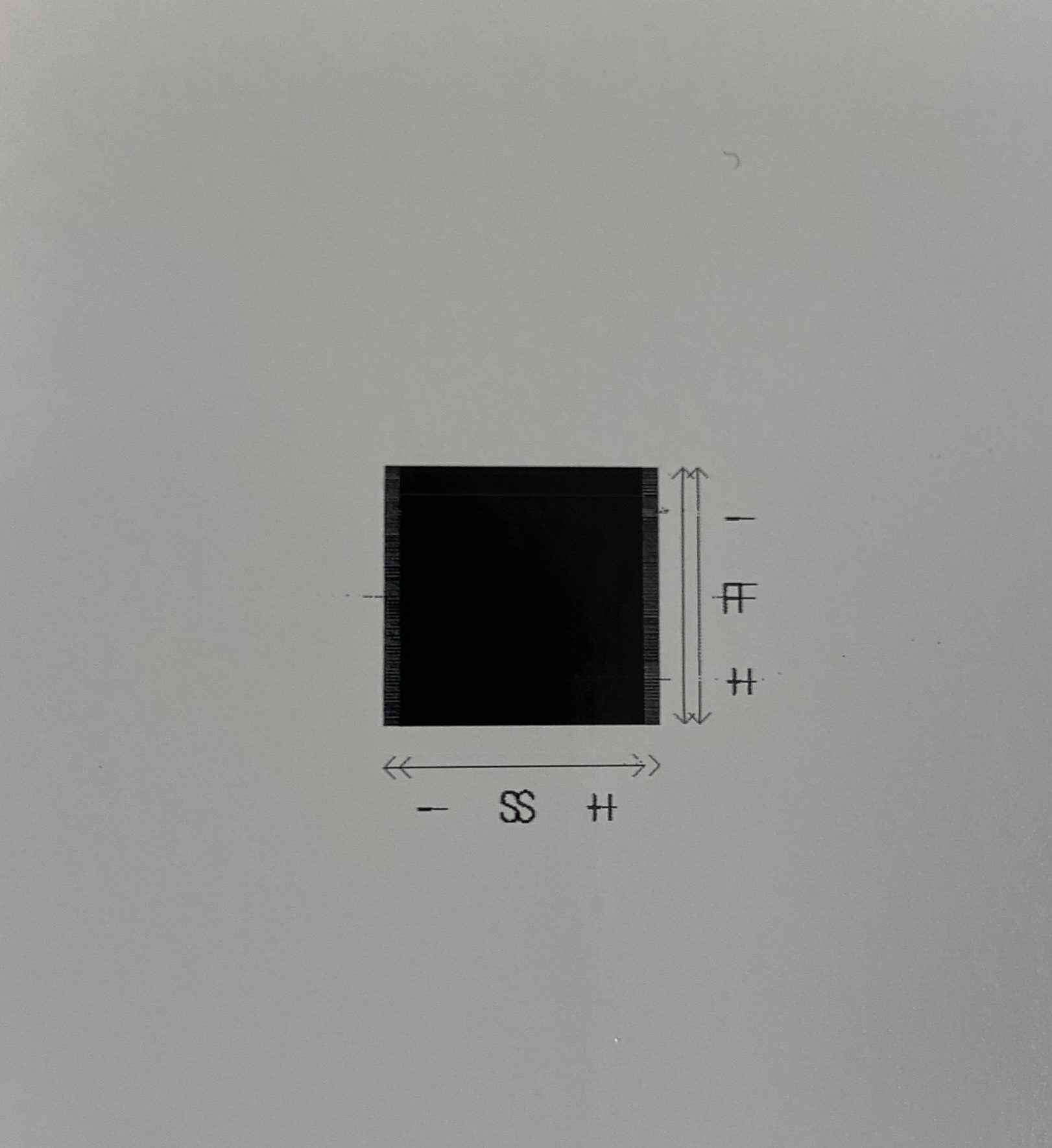

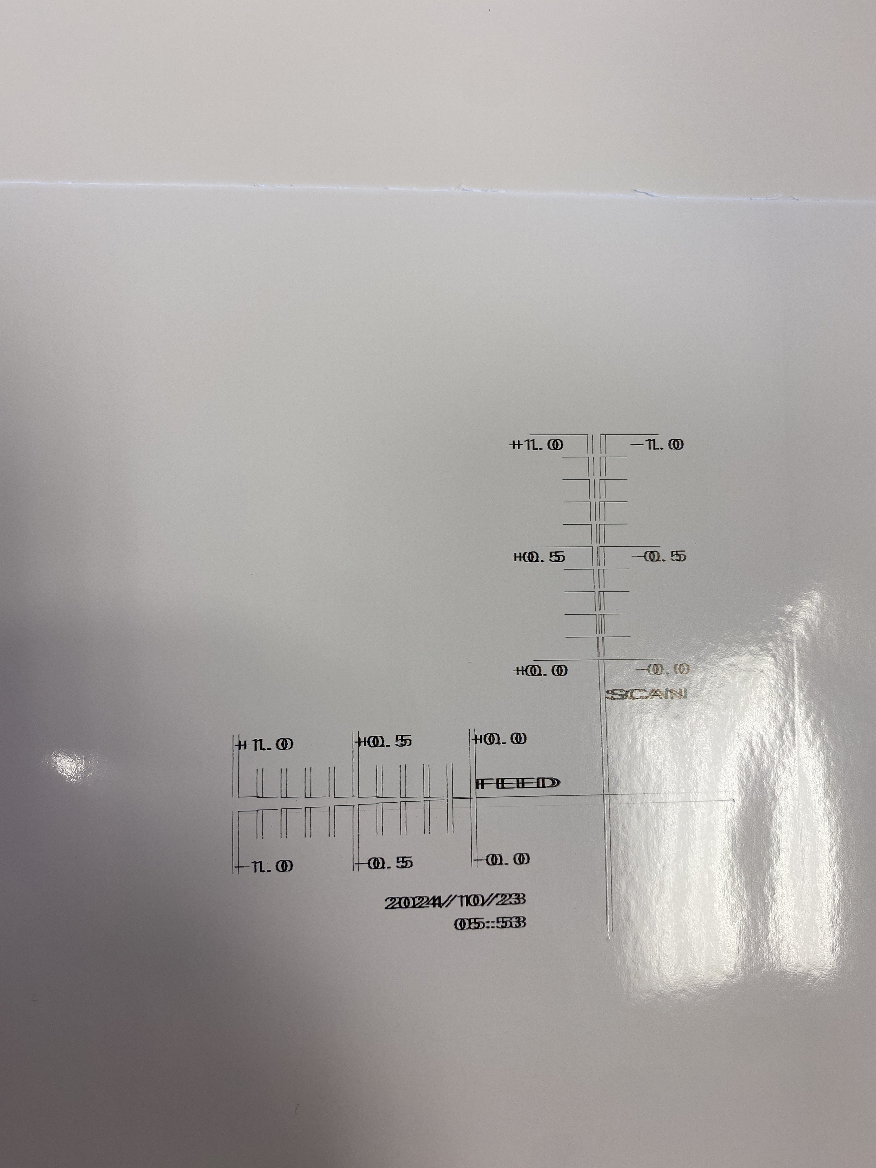

Trying to run print-cut adjustment and I have the attached result. It only does this when I print-cut adjust. I can print detailed images just fine. It's like double vision or ghosing. Anyone run up against this? I factory reset to default, but still happens.

What do your job prints look like? Print a file that has some fine detail and, ideally, something with small text. If you see this same "double" image, you need to run the bi-directional alignment. If you can get into service mode, start there and then do the user bidirectional alignment.
Regular prints are perfect. How do you enter service mode again? Thanks.
