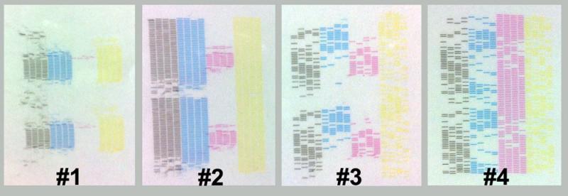

I have a Roland SP-300V that has worked almost flawlessly for 7ish years now. It’s used almost every day for a few hours (5 days a week). The machine sat unused for two weeks and when I went to use it the printer went through all of the motions when I sent a job but no ink was coming out. I ran the standard cleaning mode and did a test print to see many drop outs and smudged ink (#1 on pic).
I did a manual cleaning then another test print with much better results but still a bunch of drop outs (#2 on pic).
Here’s where I may have screwed things up a bit. I ran out of cleaning solution but thought manual cleaning again was a good idea. I used methyl hydrate (same as denatured alcohol?) to clean the heads and did a test print (#3 on pic). It got worse. After, I read something on the internet about not using alcohol to clean the heads as it evaporates too fast and could cause ink to dry out.
So, I ran to my local Roland dealer and bought the insanely overpriced cleaning solution and did another manual clean then test print (#4 on pic). I’ve done several manual cleanings and standard, medium, and even heavy cleanings through the machine and the test print keeps coming up the same as #4.

Is there anything anyone else can think of that I can try now without parts that could fix this? I attached images of 4 test prints.
Image recap:
#1 after two weeks of no use and one standard cleaning
#2 after manual cleaning with proper cleaning solution
#3 after another manual cleaning but this time with methyl hydrate (denatured alcohol) stupid mistake!!!!
#4 after multiple manual cleanings and machine cleanings with proper cleaning solution again - nothing seems to change on this test print after each new manual cleaning

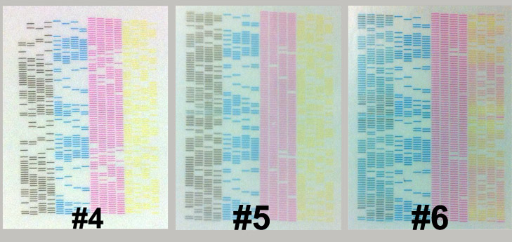

Update and more questions. I've attached an updated image of the test prints.
#4 is from my last post. #5 is after I did the coffee filter trick to soak the heads for 30-minutes. I gained some new dashes for each color.
I then soaked the head in a similar manner as the coffee filter way but I didn't use a filter. I just clamped off the lines from the caps, filled the caps with cleaner, then soaked the heads directly in the cleaner and caps. #6 is after that head soaking and it got worse.
I'm now going to soak the head again using the coffee filter in between.
My question is, does the fact that after soaking with the coffee filter I got more dashes mean that the head is clogged??.. or could it still be the caps that aren't sealing? I'm assuming the fact that the test print changes each time I clean means that some extra jets are being cleaned out?
