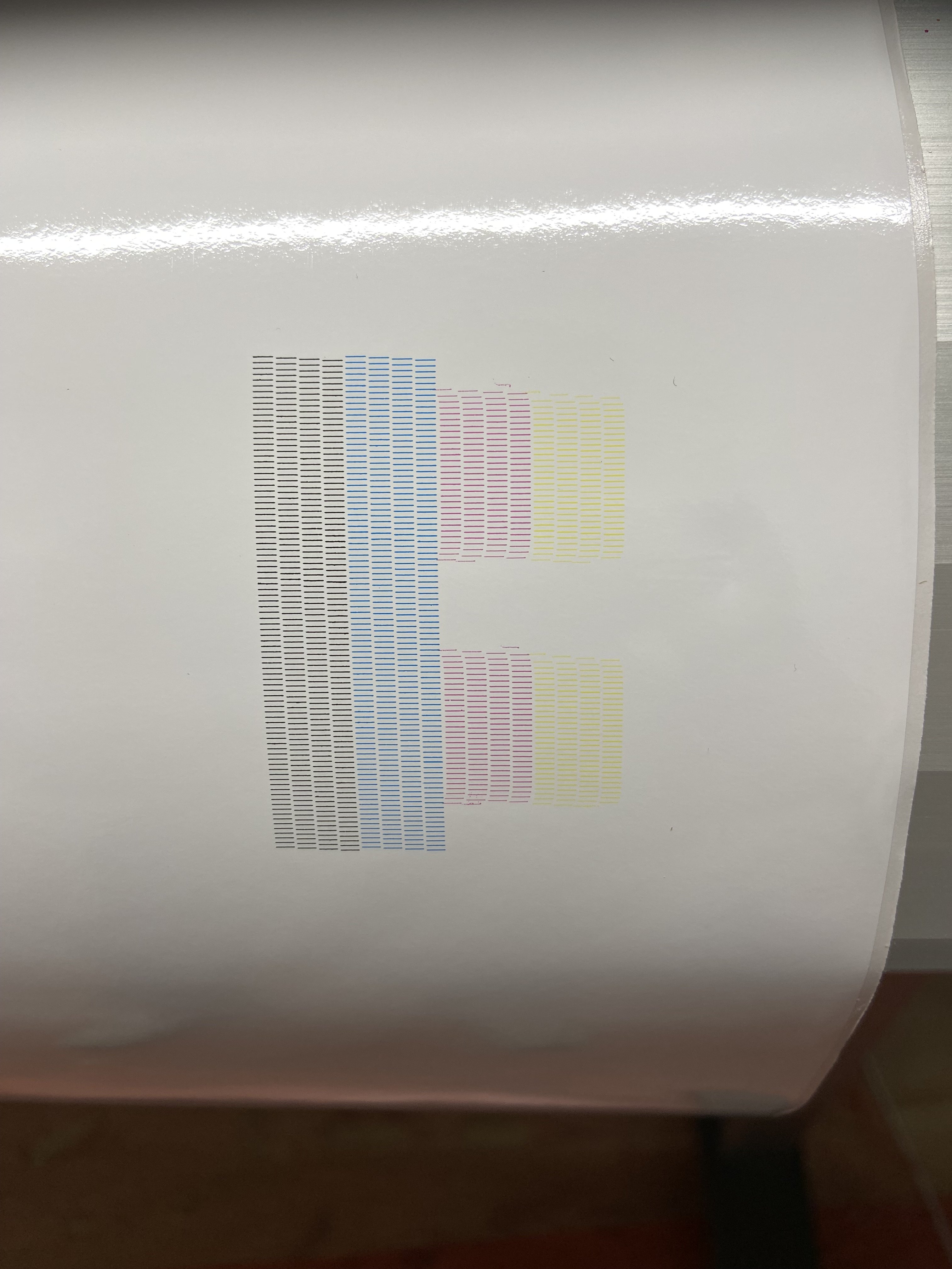

I have recently had a new Printhead but haven’t used it for a week. It has been left on the secondary power but the new Printhead is not firing properly. Can anyone offer any advice of what may be causing this?
Before suggesting a solution, I have several questions. Where did you get the printhead? Did you install new dampers with the head? How old are the cap tops? I do initially suggest reseating the head ribbon cables, with the printer unplugged...
