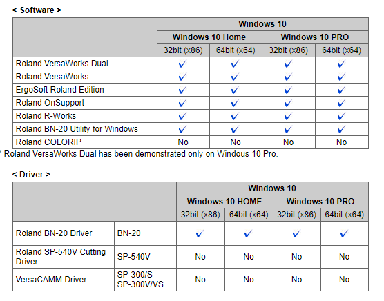

Solventinkjet, Are you talking about running Versaworks as admin? Or installing the driver as admin? The problem that I see is that the SP300v connects as a USB device, not a network device and the USB driver is not compatible with Win10.
Joe House
Sign Equipment Technician
From Roland's website:

I did purchase a new printer (only new to me, the printer itself is apparently 13 years old and has no support). According to what I am seeing on the Roland site, Windows 10 is not 'compatible' with the SP300V printer. I did order the older version of the VersaWorks software (DISK,CD RSP-040 VERSAWORKS WIN / VER. 5.50) which said it will work for the SP300v. What I am trying to decide is if I will have to install windows 7 on a computer just to run the printer (driver), or if I will be able to make the printer work with ver 5.50 Versaworks and Windows 10. I haven't been running Windows 7 for about 3 years now. I was just reaching out to see if any of the people that currently run the old SP300V printer have been successful at running it with Windows 10. I have read conflicting answers in my searches and I know the people on here are extremely knowledgable. :)

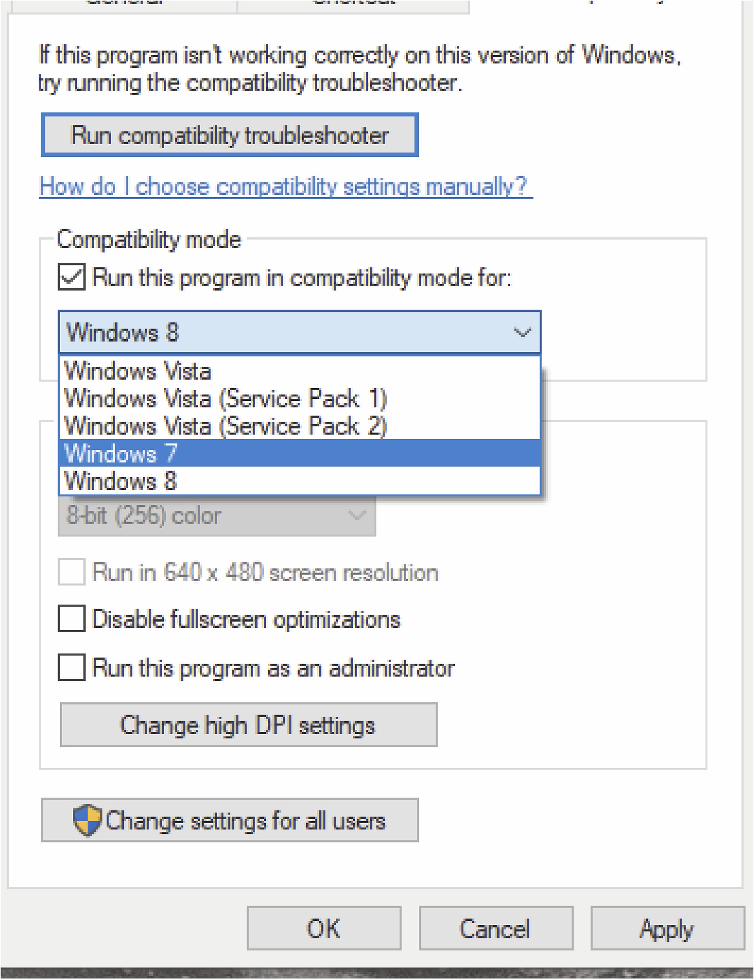

eahicks
I keep seeing Run as Admin being recommended....don't you mean you should adjust the settings to run in Compatibility Mode for whichever back version you want?
Solventinkjet
DIY Printer Fixing Guide
Comparability mode can help with software issues but if you check the "Run as Admin" box below those options, it will open as admin all the time. If you don't, the program doesn't recognize the CutContour spot color.
