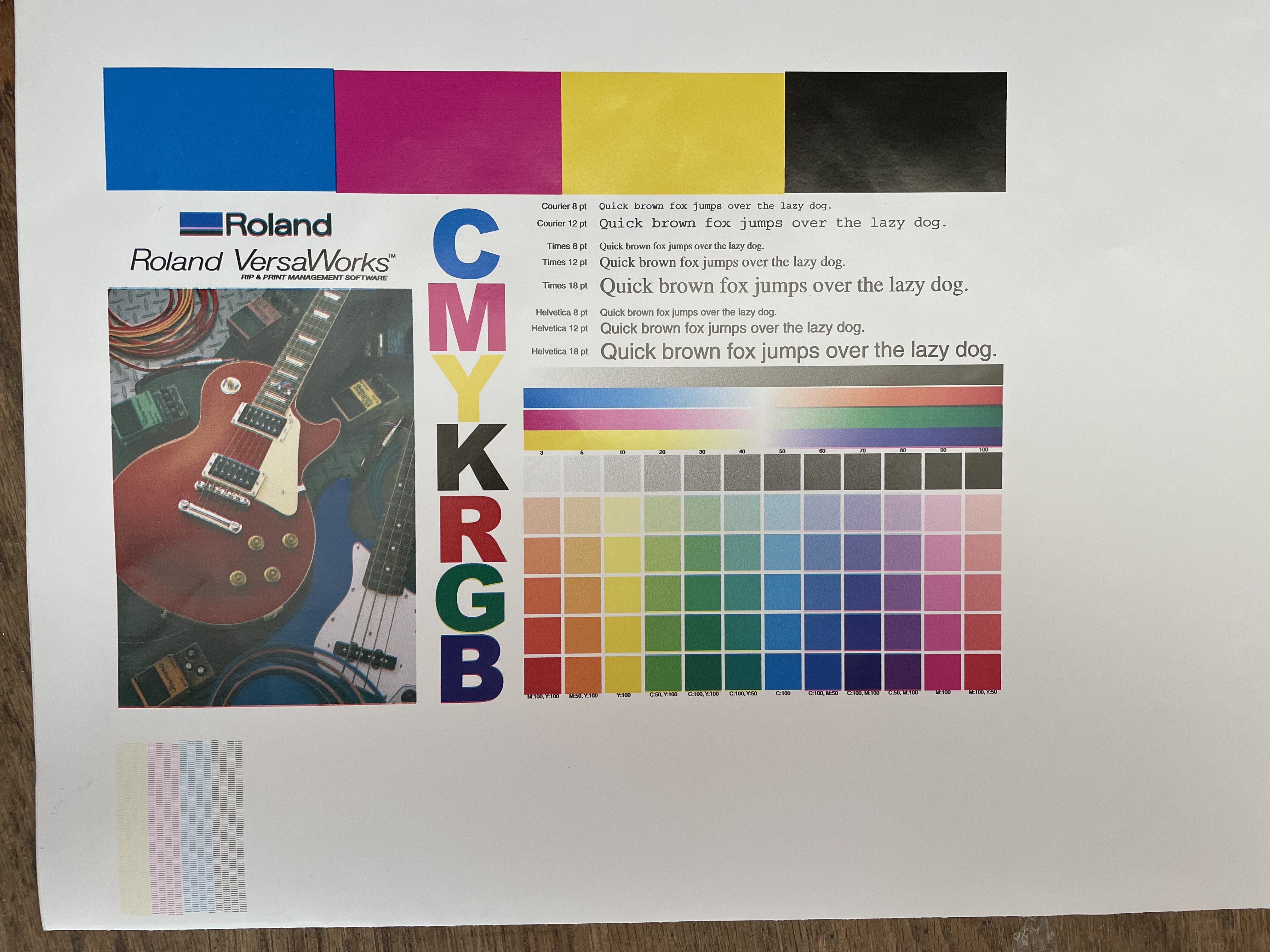

Thank you all for your time and the valuable advise! I am still with no black. I have rechecked and re-soldered the fuse.
STRATMAN2
It depends on the exact model. Later versions had replaceable fuses. I also agree they are testable in place but I have had many customer say a fuse was good when in reality it wasn't.
This turned out to be the case. Checked the fuse again and everything works! Prints like a new machine! The fuse can check good and not be soldered to the board properly. Thank you for all the advise!
