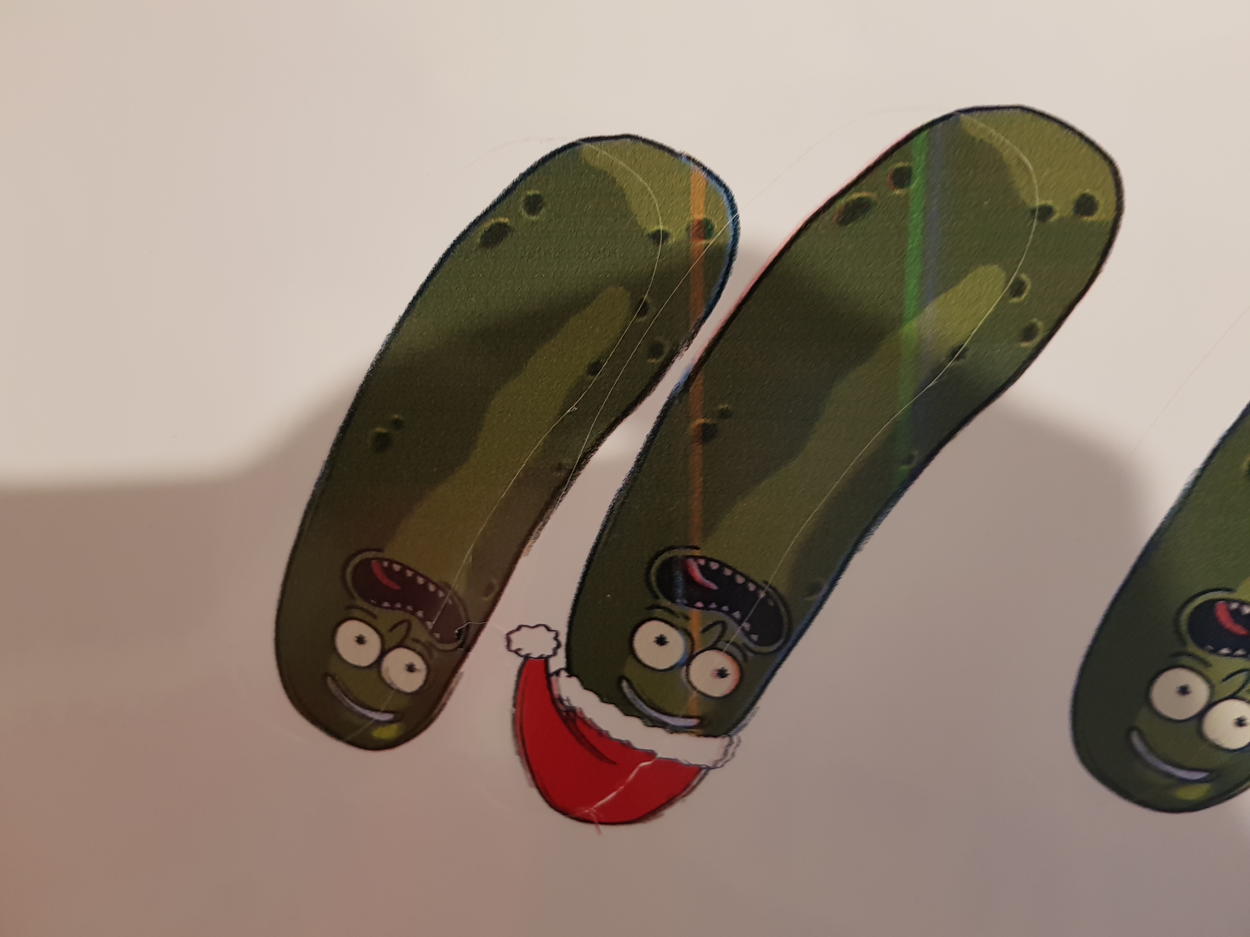

Hello everyone, I have recently purchased a used Roland SP540V. This is the first print and cut printer that I have used coming from a cheap chinese vinyl cutter/plotter.
I haven't yet manually cleaned the printheads and printer itself yet but have ran a few powerful clean tests. The nozzle check showed some gaps but overall the stickers that I have printed looks acceptable. At this moment in time I am still in the early stages of practising as the seller has given me quite a bit of sticker vinyl which I will use to practice with.
So I decided to print out some personal stickers for myself and used a 1320mm roll. Whilst printing at the 1000mm mark I get this strange vertical band as you can see from the photo I attached. This happens in the same spot because I test printed another image. I find it strange that this was only happening at a certain point of the vinyl roll.
Can anyone explain this problem. Thank you

Try cleaning the encoder strip. You may need to replace it if it's bad. John
Thank you John I will give this a go tomorrow :) May I ask why you think it's the encoder strip and why it would cause that problem?

If you do a search you will see a bad or dirty encoder strip will cause all kinds of problems and I've experienced a lot of them. A new encoder strip fixed if for me but you may get lucky if it's just dirty. Youtube will have videos of the cleaning and/or replacing process. John

I see, I had no idea that the encoder strip can cause so many problems as my ink jet printers never had any issues. I suppose there's a lot more maintenance and moving parts for a print and cut machine. In regards to the pinch rollers do you think I need to buy and add more? Right now I am using this for print and cut vinyl stickers and will be doing t shirt heat transfers soon. Thanks
Myster Enigma
Hi John, I have just cleaned the encoder strip and now the prints are perfect :) No more fuzziness and the lines are completely gone. I think the contour cutting is also a lot more accurate now too!! However when I'm print and cutting stickers out at a roll that is 1300mm the contour cut seems to be off by a few millimetres. Using 2 pinch rollers on 500mm roll contour cuts perfectly. As you rarely use more than two pinch rollers and haven't had any problems I'm now wondering what could be the cause of this.
