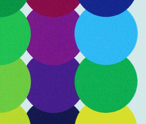

Problem 2: Bi-directional print is ugly please see image

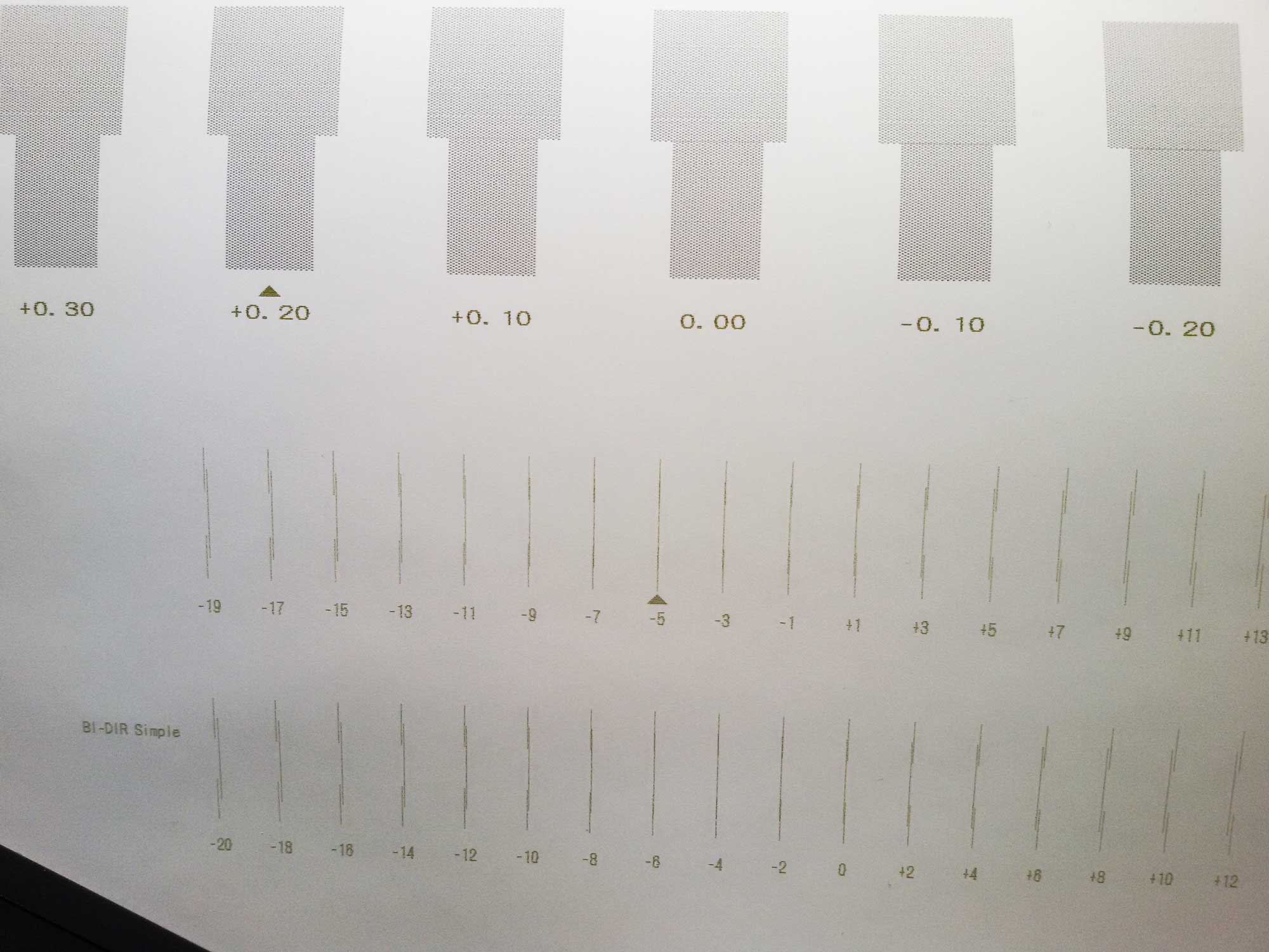

calibration -> perfect
bi-directional settings: perfect on both simple and detailed. Also set in service menu.

As image shows this color "shift" appears on different spots. Part of the print is ok, others are problematic, when reprinted problematic spots appear on different parts, not always on the same place.

I see the simple bi-directional test. Have you done the detailed bi-directional calibration?
I think I would set your feed calibration at 25, but I don't think that's causing the banding. If your nozzle test isn't perfect, then you can't really expect perfect prints.
