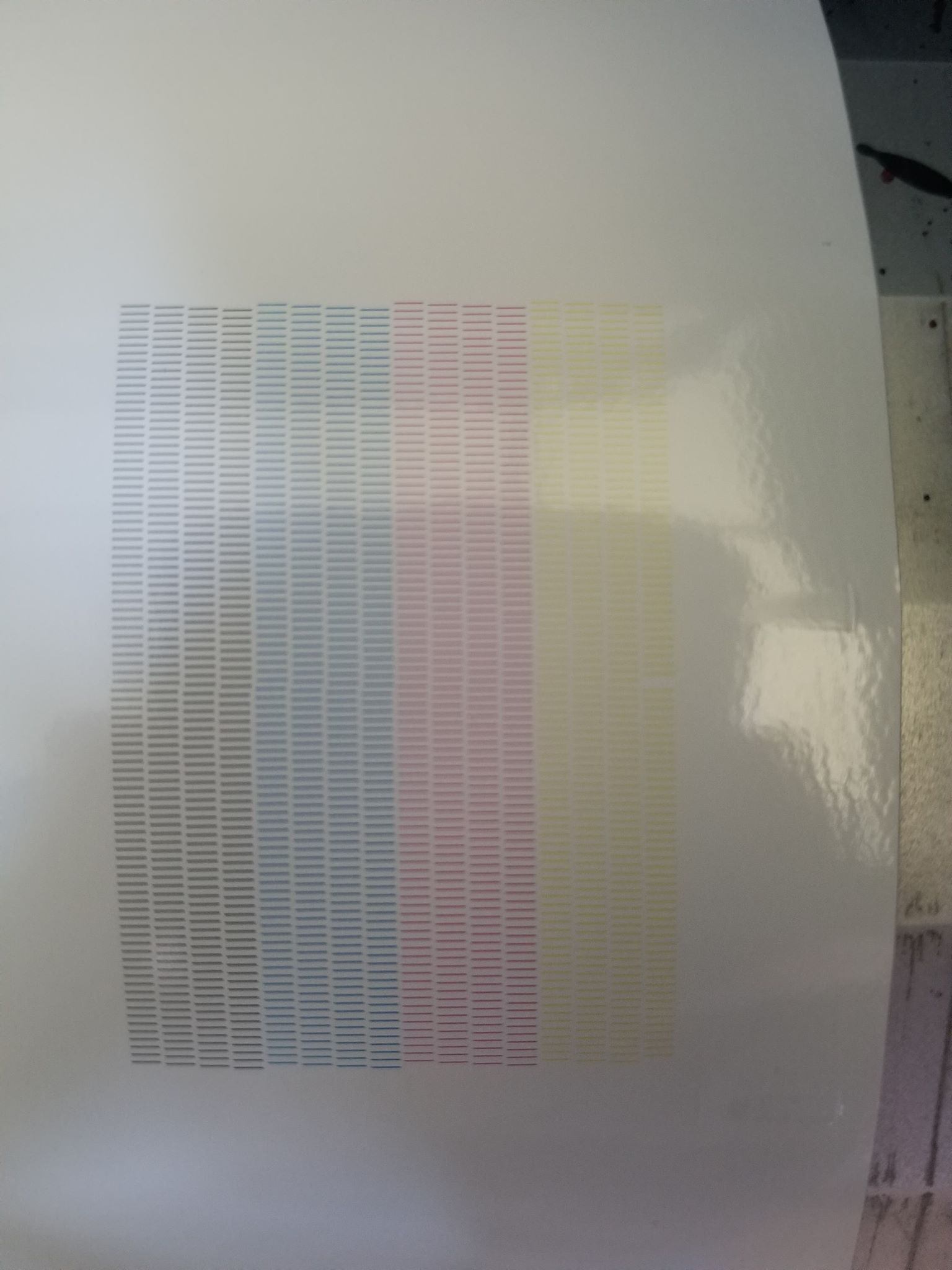

test print seems to be fine

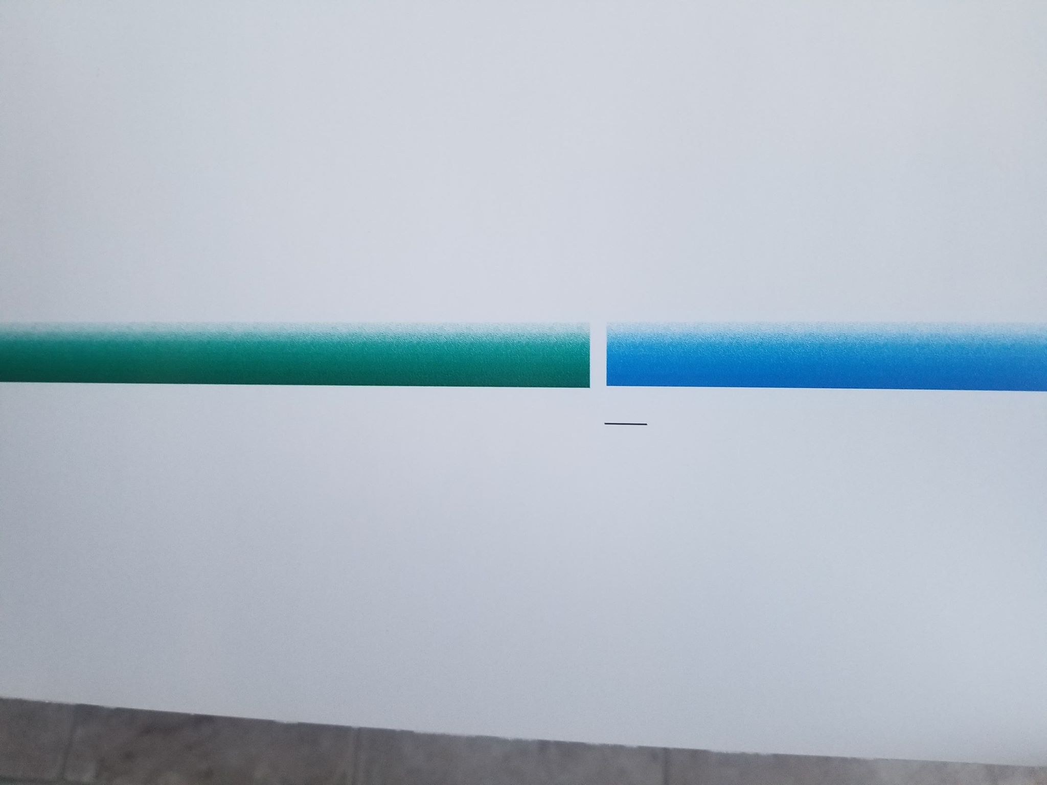

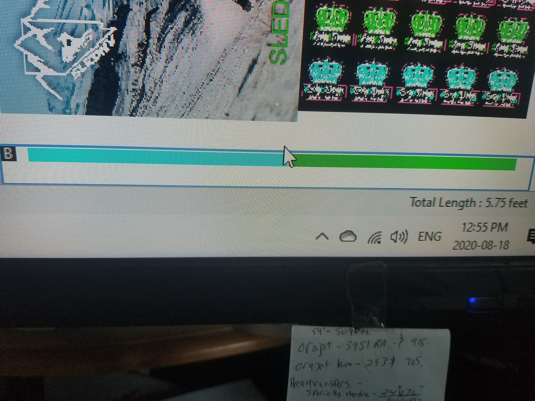

im trying to print a bright teal and lime green, although it doesn't look like it in the picture of the computer screen. and the last picture is the actual print.

Your monitor is rendering in RGB and your RIP is converting RGB to CMYK. As stated above , print the spot color library from VW and choose the colors you want.
We design in CMYK so avoid color shifting as much as possible. We also have everything calibrated to work together. Your monitor will not be perfect match to print the printer but will be close enough. Also you have to design with the output in mind and not what looks good on screen.
