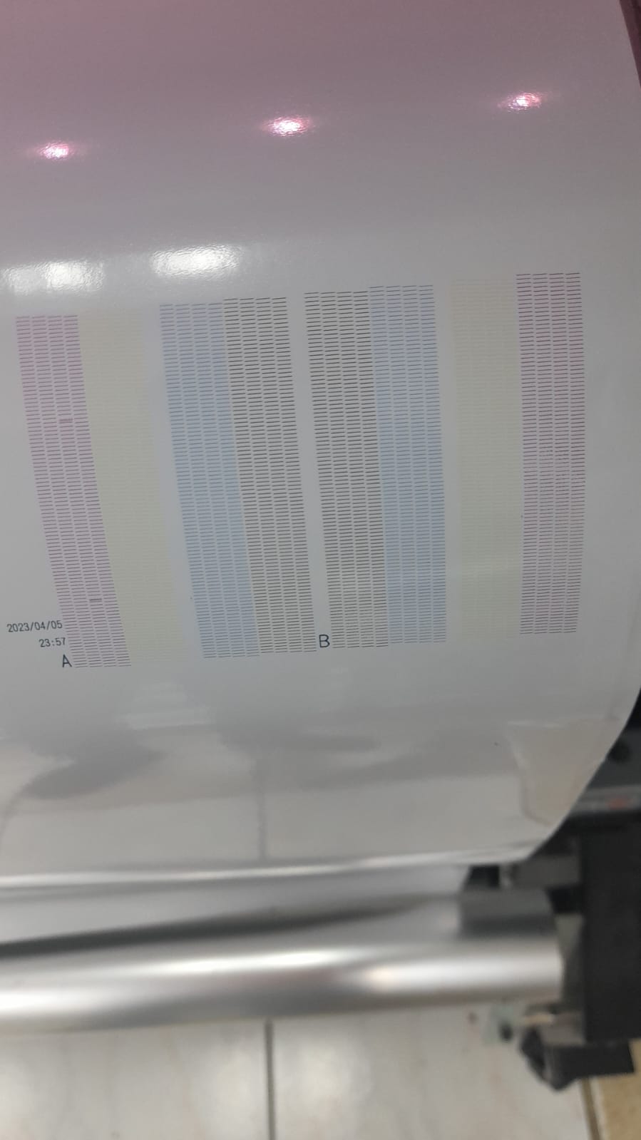

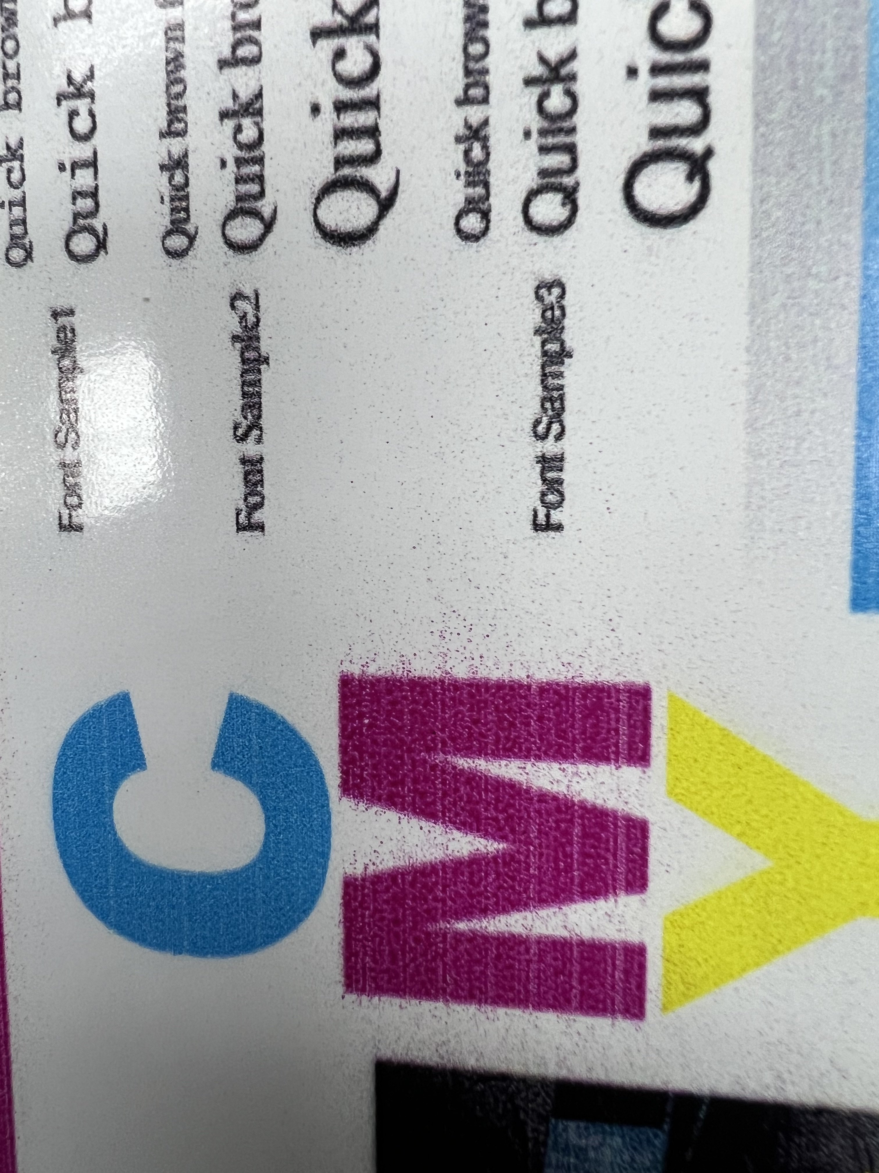

The magenta is acting weird it’s not printing solid and it’s having a misting look on anything with magenta … dispute new printheads change … any ideas?

A Nozzle test print would be more helpful. It looks like your black is misting as well. What head height are you using?
