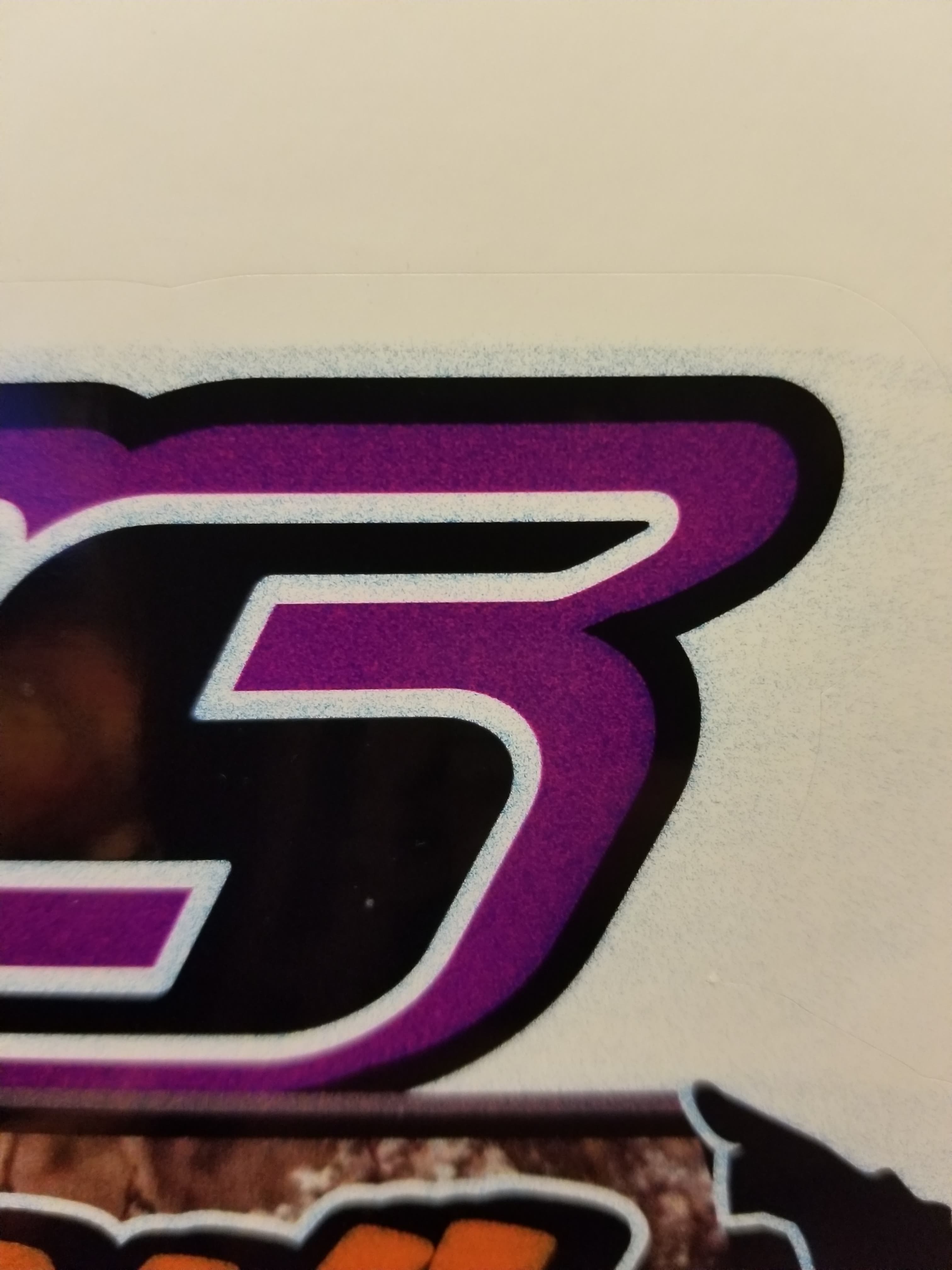

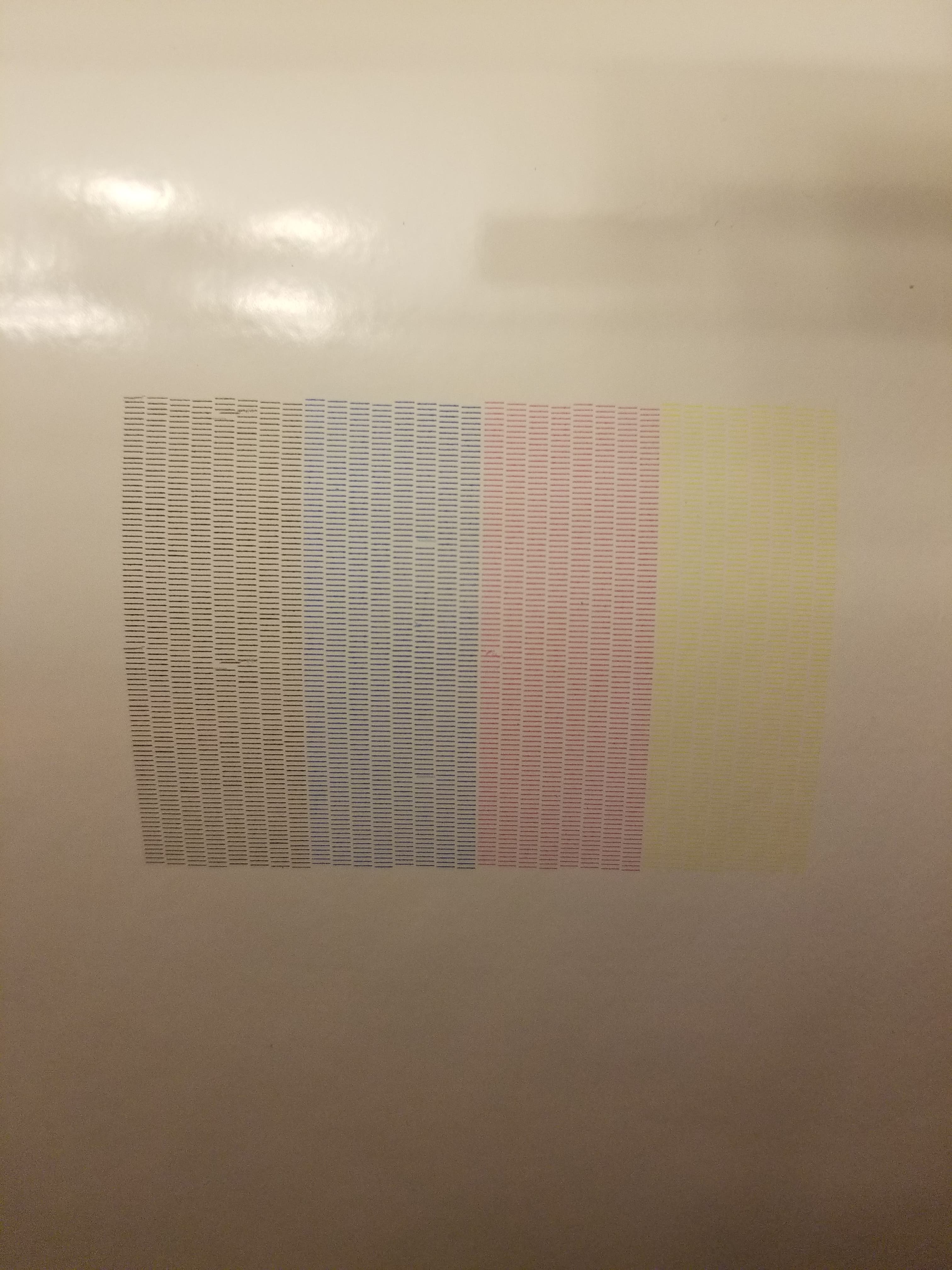

Okay, so I bought a VP540 a month ago or so. don't know too much about them. I have been trying to get it all setup and going, but I am having an issue with the cyan overspraying on prints. I have made sure my head is in the low position, I've done multiple small cleanings and a medium clean. I unplugged my machines power cord for an hour and plugged it back in to see if it was possibly a static issue. I have read up on a few other posts, it seems like some people have fixed the issue by replacing the damper. Some others say they could only fix it by replacing the head. My test print shows just a few drop outs, which I have attached. If anyone has dealt with this issue, I would really appreciate some insight as to what route I should go to resolve this. Also, if changing the damper is suggested, where is the best place to buy parts at? I am new to this. Thank you for your time
