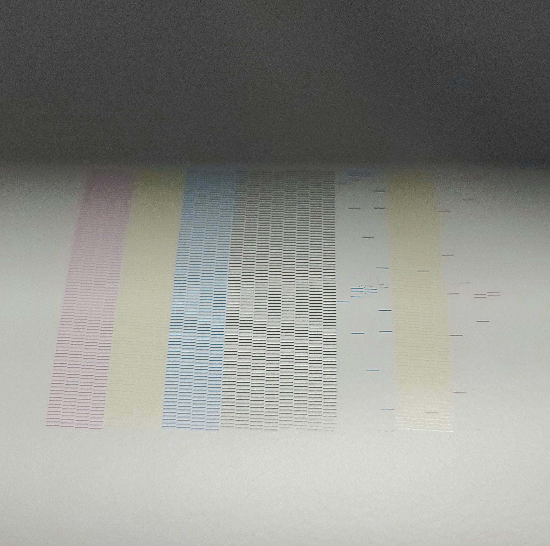

This is how my test prints look - one half totally clean, the other half has clean yellow and black but is totally missing cyan and magenta. Any idea what could be the issue and how to fix it? I'm a novice at this but am not able to find a technician in my area so need to try to fix this on my own.

Maybe check the cap top condition and if it hasn't been changed in the last 6 months, start there and replace it. You could always try a 48 hour head soak.
