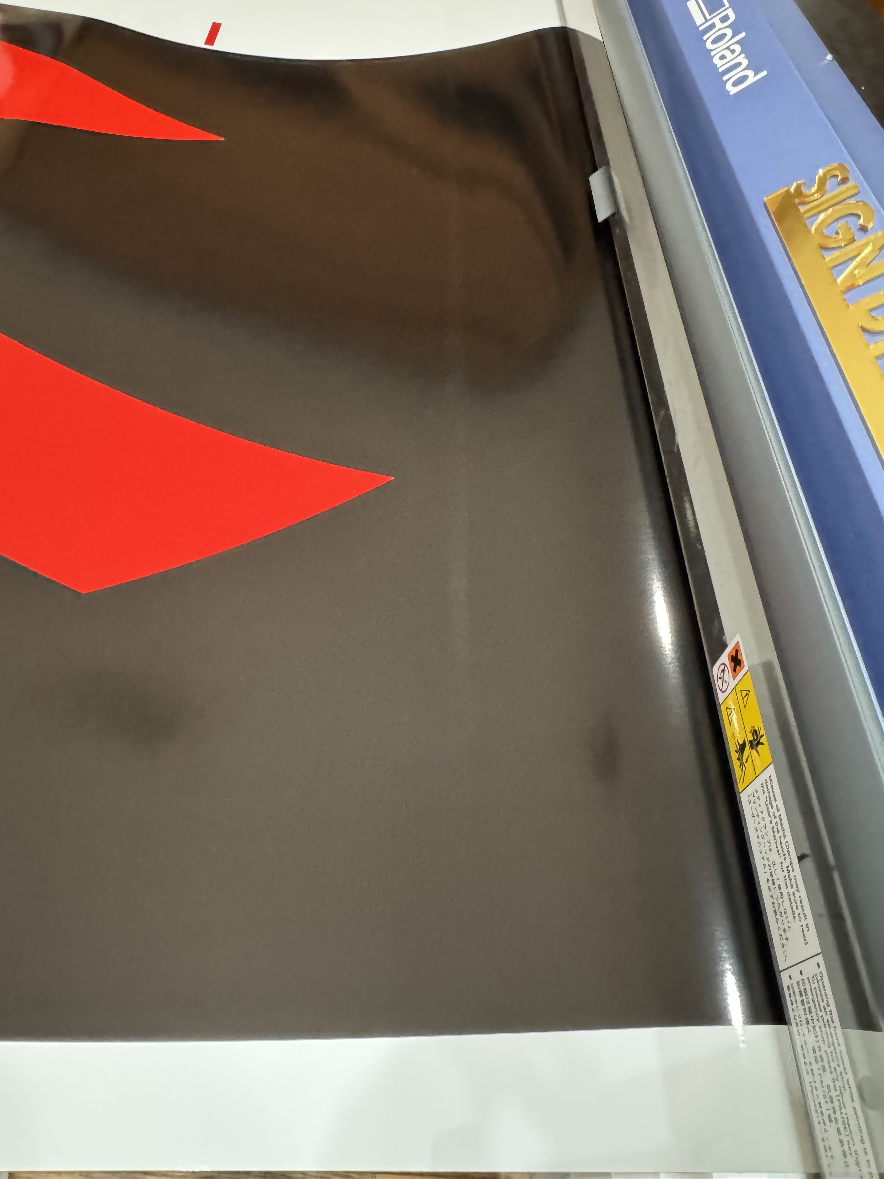

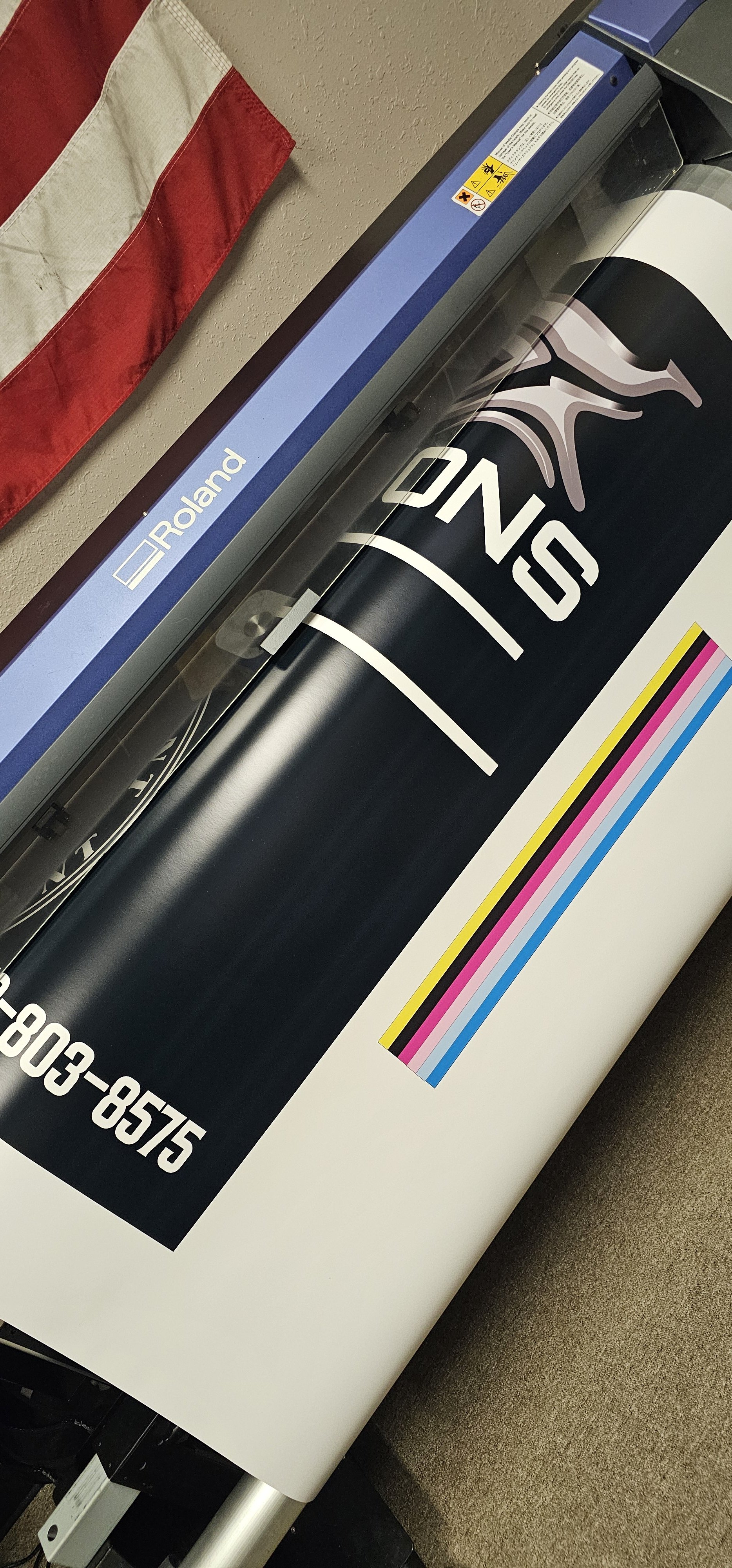

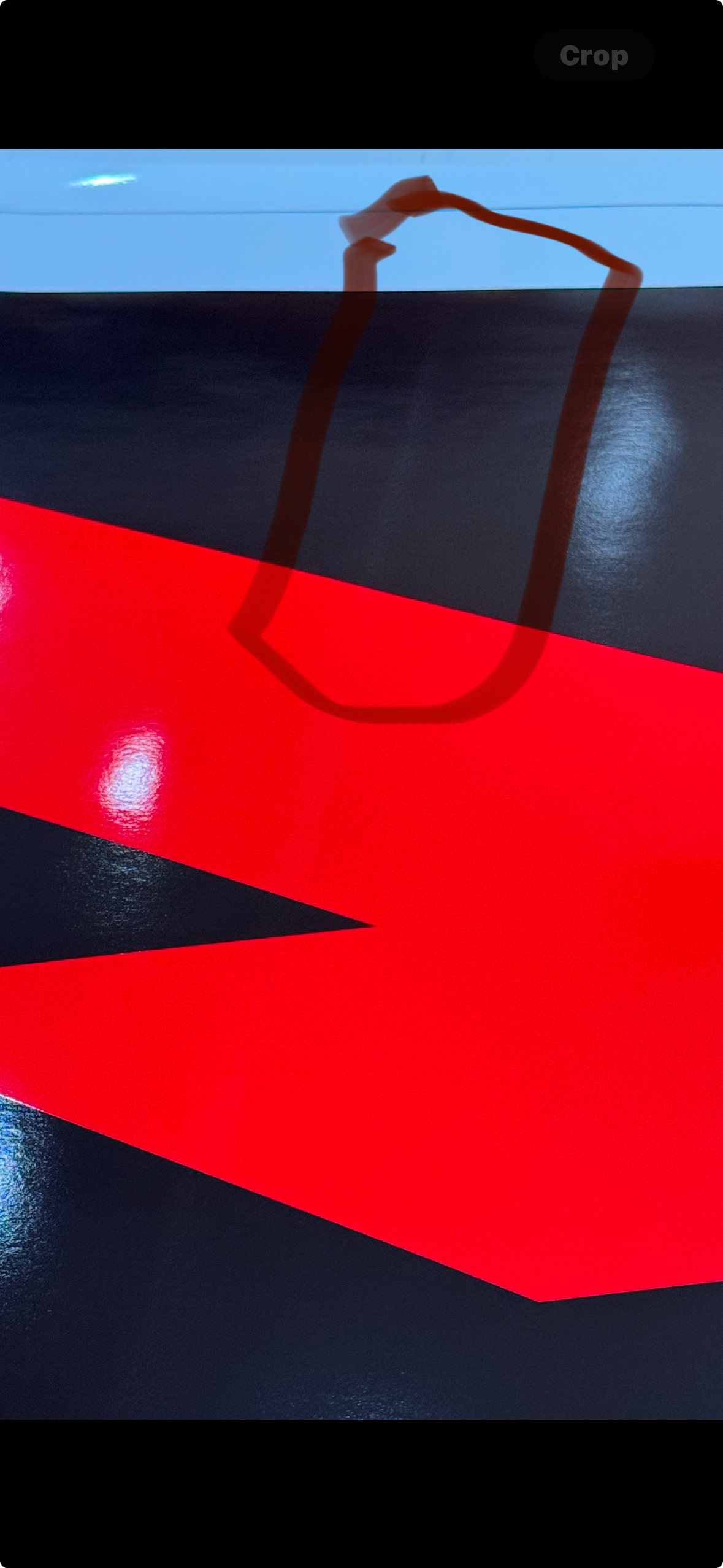

Hey all. I have a VS540 in my shop since 2020. When I’m printing a panel for a wrap, i more than not get a band running all the way across the print. It only happens when printing black and sometimes grey. I’ve cleaned the encoder strip, doesn’t seem to change it. If I run a powerful clean, that seems to help on the next print or as in the photo with the red, it will be be very miniamal. Any ideas on a fix?

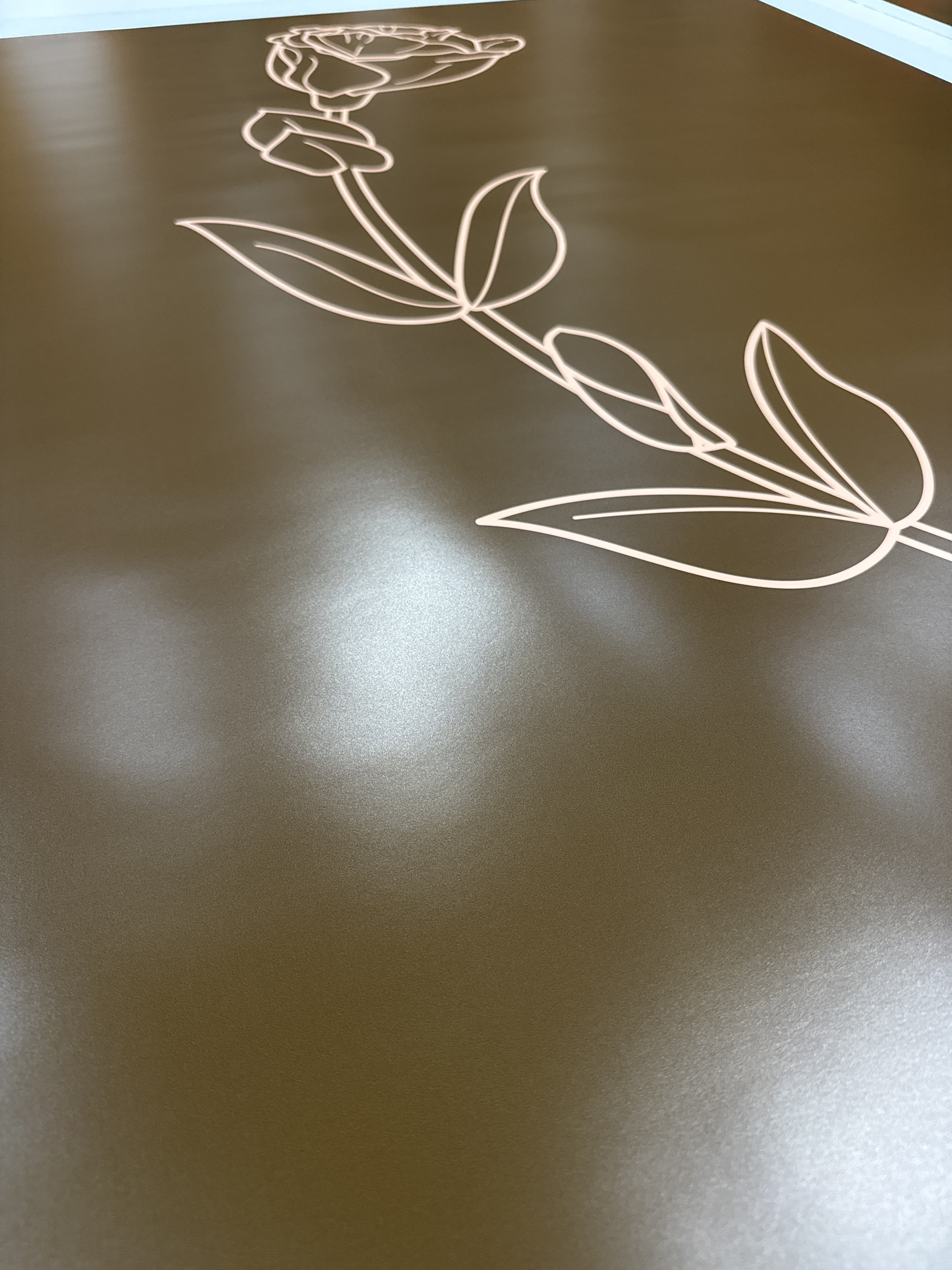

Here is another example. It’s basically on every panel of this wrap I’m printing. It’s done this since I first bought it.

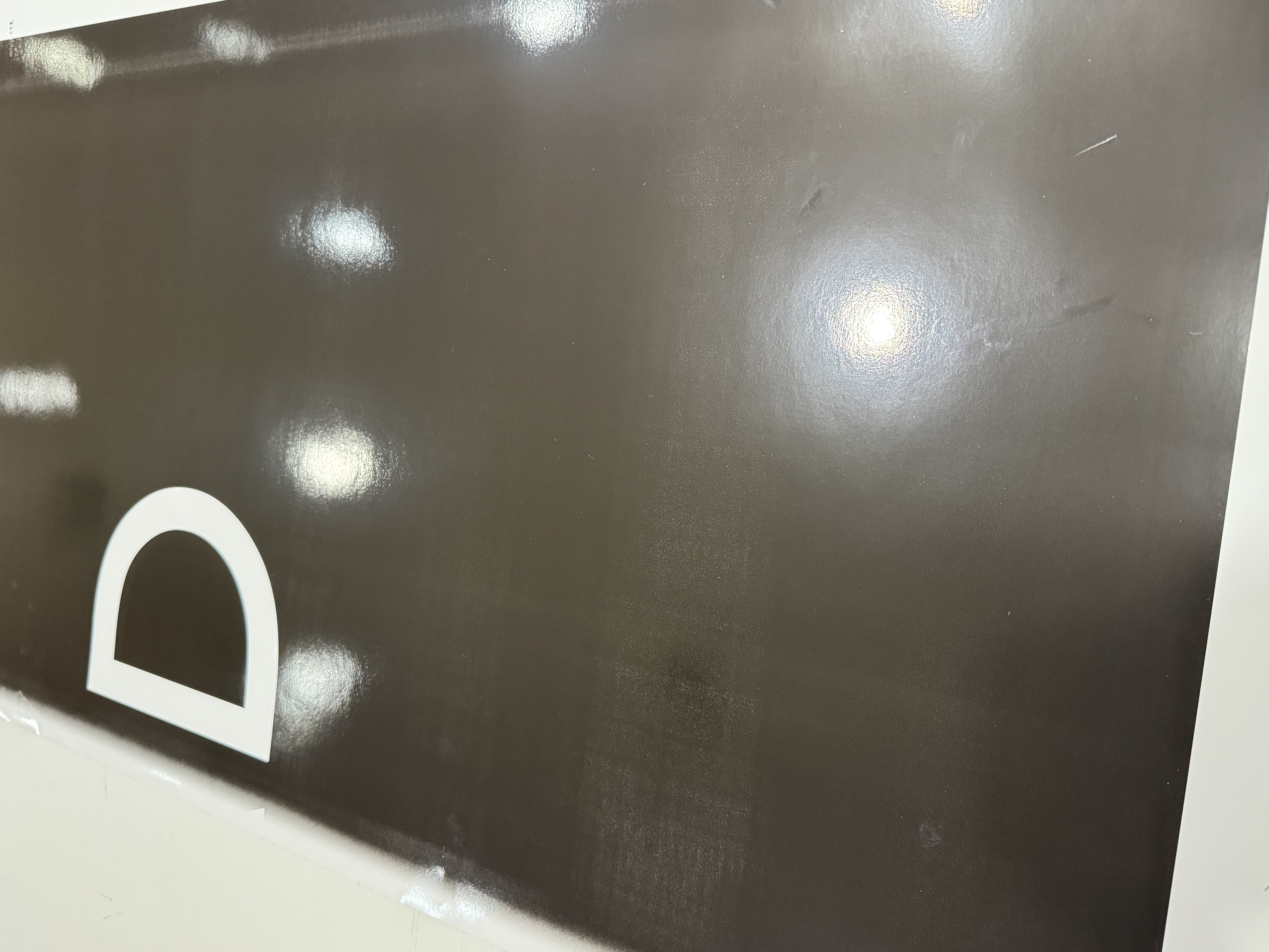

Here’s what the print looks like now. Definitely got worse and there is additional banding running the opposite direction. I’ve never had it run that way. See a few inches below that D. It’s running front to back, along with a thin line at the right side running left to right. View attachment IMG_6599.jpeg

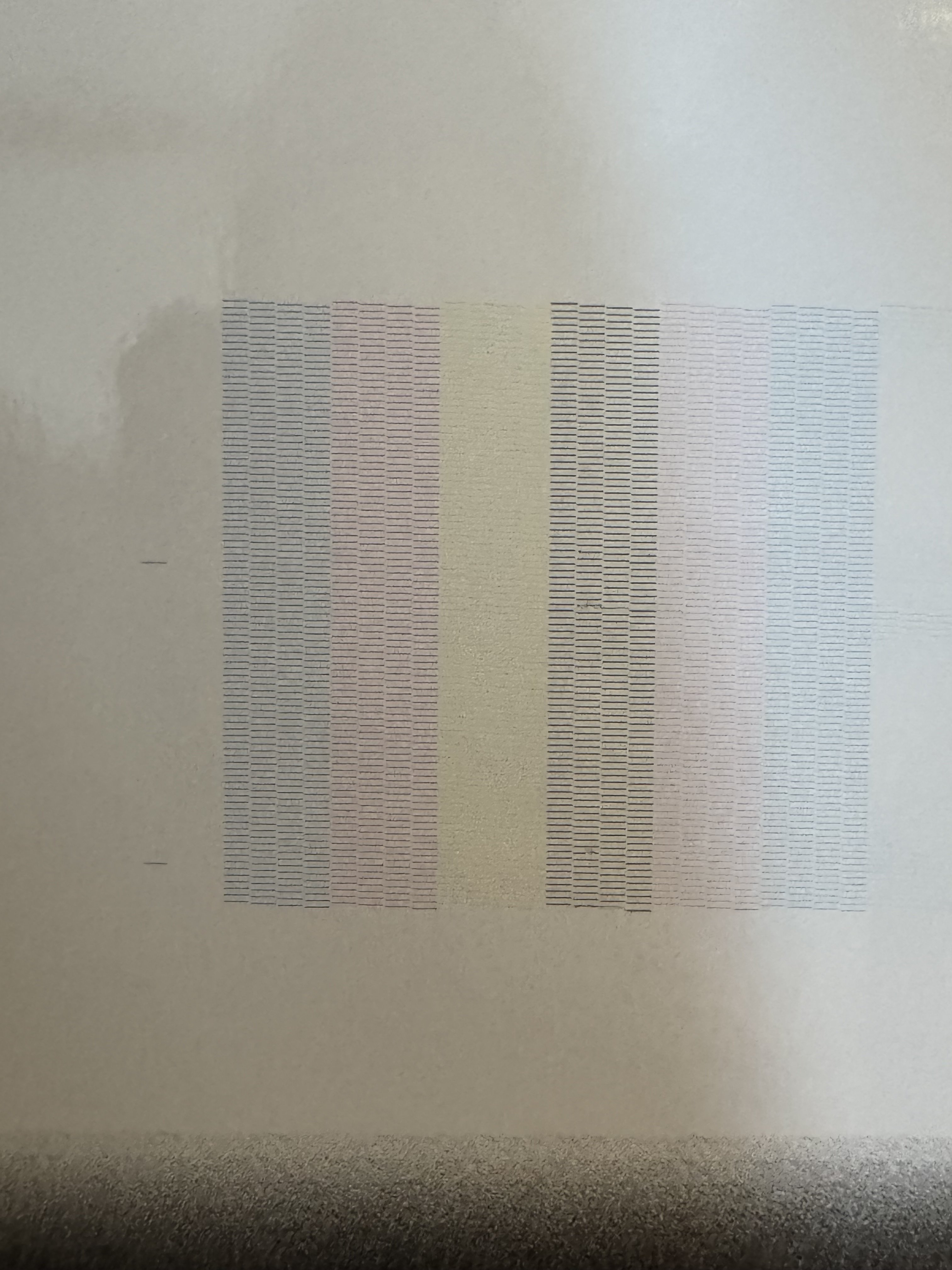

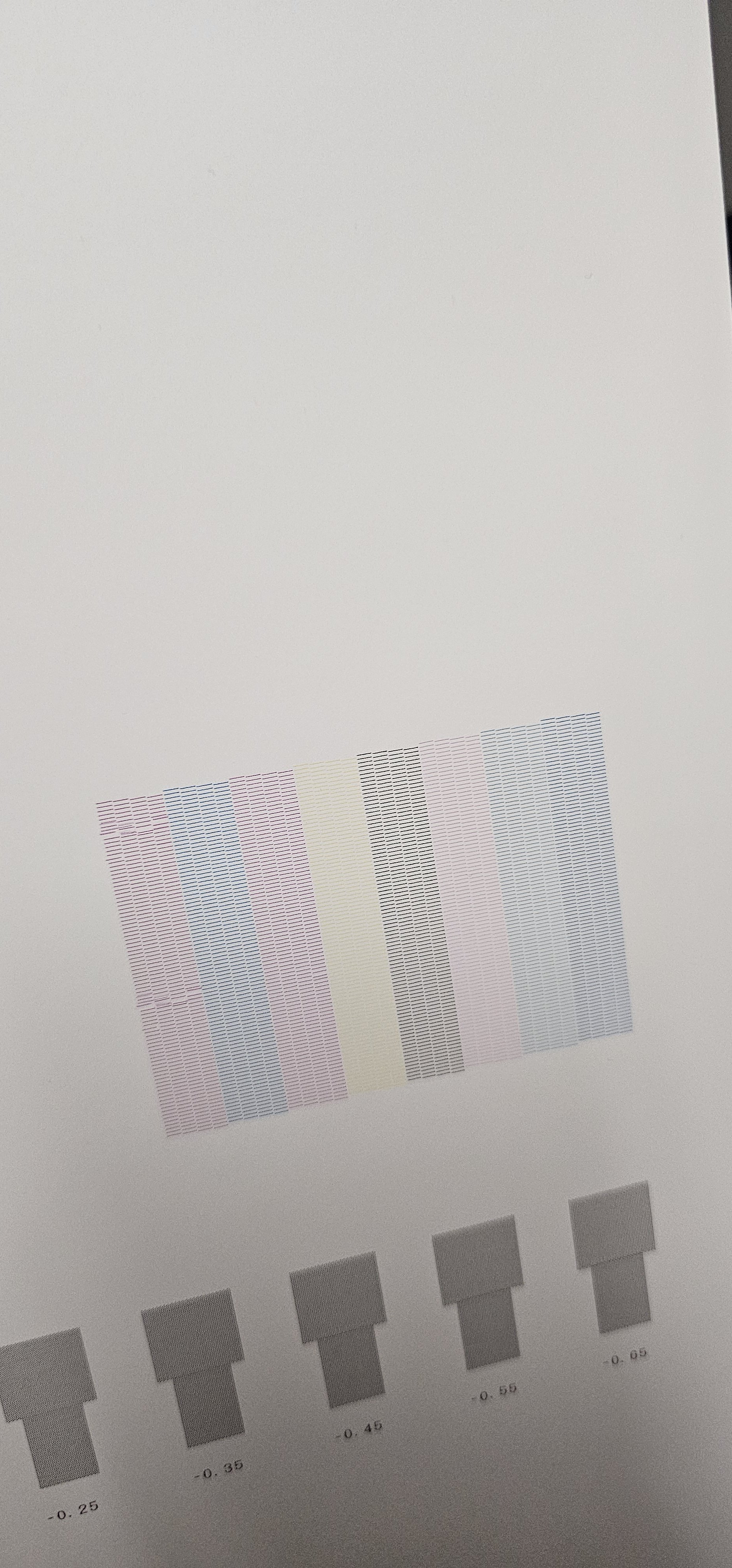

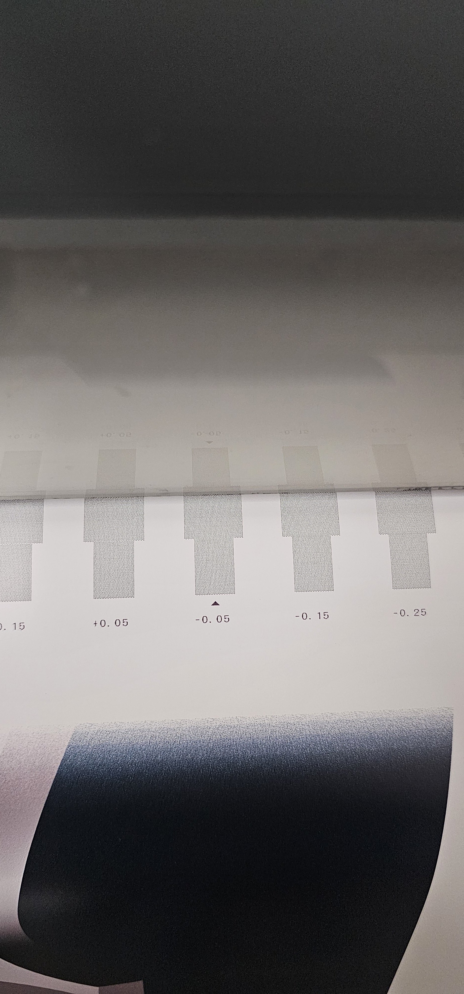

So im currently having the same issue and i was told that my wheels/rolllers could be bad if they are hard. I also just got a brand new head and just replaced the scraper and both wipers. Only happens in black. Cleaned the encoder strip. Calibration prints are amazing and then if I run another test right after there is very noticeable gap between the blocks. I'm about to just replace the encoder strip and disk and see what happens

I’ve replaced most of my rollers not long ago, so I doubt that’s it. I cleaned the encoder disk and it didn’t help. If I print in high quality / max impact, it doesn’t happen. But I’m not trying to print every job like that. It just takes way too long.. I talked to my tech, but he really wasn’t any help. Let me know if you find a solution and I will do the same.

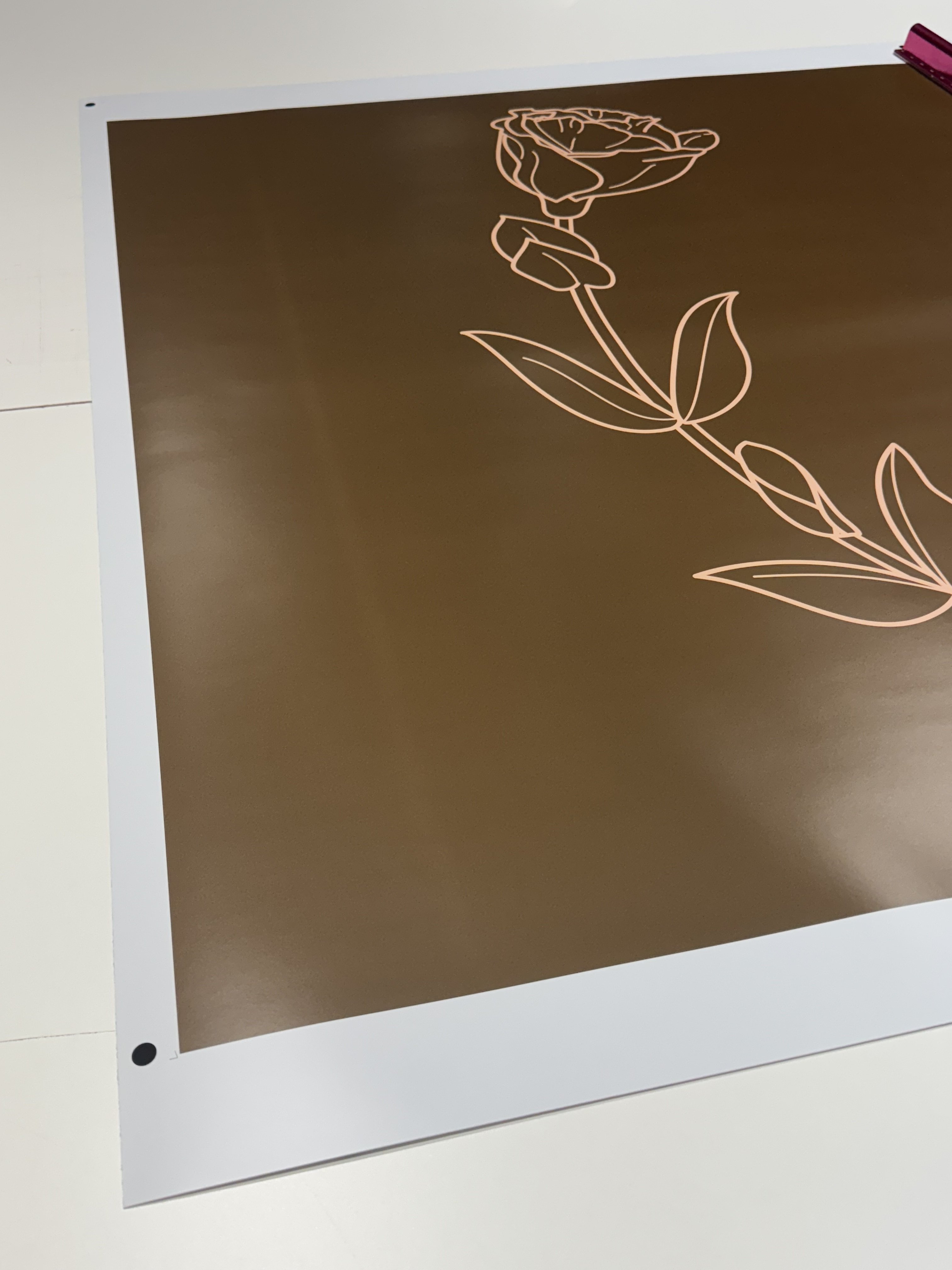

Here is another example with brown. Band is only in one spot running left to right. Printed a second one for the other side of the sign and there was a band in a different spot, it was a lot less noticeable, because I did a powerful clean.
