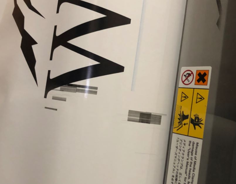

Hello, we have ran this file successfully on a few occasions, but last night our Roland kept inserting these random marks in the artwork.
Has anyone ever had something like this happen to them before, or what could this be a sign of? We had the head replaced about a year and a half ago and it's been running like a top, but this is something I've never seen before.
Thank you in advance for your response to this question.

The black channel on the head is getting bad signals making it turn on when it shouldn't. There are a few possible causes, most common is the long cables from the print carriage board to the mainboard, It could also be the short head cable, the print carriage board or a transistor problem on the mainboard. Try replacing the cables first and see if that fixes it
manlyon
I would also clean the encoder strip (as the black patterns seem to follow the shape of the letter). I recently had this problem with magenta only. Cleaning the encoder strip has fixed it for me.

Thank you for this information -much appreciated. I have new ribbon cables on order and hoping this will resolve the issue.

Thank you so much for providing this information - I have spoken with a local tech and have new ribbon cables on order. Hoping this will resolve the issue.

VS Block Printing. Replace long cables per the RSB.

Hello, and thank you for your response. Much appreciated! We are going to replace all four of the long cables while they're in there, as if one went, I'm sure the others are not far behind. We've actually had this machine since 2012 and have been extremely happy with it. As we are only a couple years out from retirement, new equipment is not an option for us at this time, we'll just have to find a way to keep this one going... fingers crossed :)

Yep, replaced long cables today on a VS and problem resolved. However, you may need the Print Carriage Board as well, to the newer version depending on s/n
Interesting - hopefully this will be all we require as well. Our tech from Spicers (Canada) indicated that it's getting harder to find parts for these now. Sincerely hoping it's nothing more than the cables. Do you happen know at what serial number these machines are no longer upgradeable to the new print carriage board? Fortunately, for the time being we are still able to print using one side of the material, it's a bit of a waste of vinyl but we are still managing to get order out this way. Thanks again for your expertise and feedback - much appreciated!
