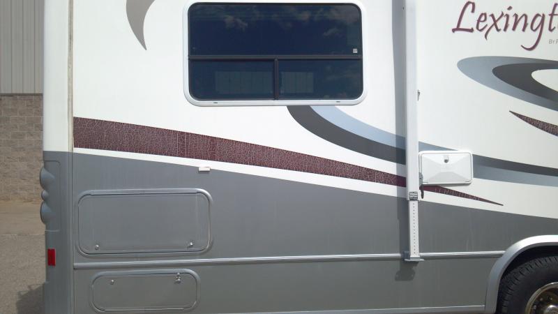

OK guys. How do I remove this without pulling all of my hair out? It's the red strip with all of the cracks. Thanks!

3m woodgrain and stripe remover. Just make sure you don't get any on the remaining decals.
+1 on don't do it unless you have/want to......Did my own and almost fired myself. :bushmill:
The "Ghost Off" did work for clean up on the rest of the coach.

A vinyl zapper may work, or the steamer. Hope your charging by the hour.

There are only 3 of these "swooshes" to remove and replace with new vinyl. (3 too many hey!!) :wink:
I priced the removal as high as the install of the vinyl. I've removed bad but not this bad and I know it's going to suck. I'll probably still end up loosing money but I guess I'll take the chance. It's not like it's the whole RV. I used a steamer on a pontoon that was pretty bad to say the least. Will probably use it again. It was a life saver on full strips but this is cracked everywhere.

Steamer followed by the "never to be recommended lubricated blade" trick if needed.
Minimal hair loss no paint damage if done correctly.

What suks is a full Wrap removal x 2 that is fully crazed. Last 2 days used a steamer, and a squeegee at 85 degress pushed into vinyl HARD and it took all vinyl off and half the glue. The Paint was soo CRAP (a respray that when vinyl was peeled it took paint) to use a metal scraper blade except 1 colour that would not give.
i helped remove a fleet of vans for the arizona lottery that had been on 8+ years it was so baked and cracked it took us at least 12 hours a van we used angle grinders with rubber vinyl off wheels if we didnt have those it would of been a nightmare! DE IDENTIFICATION SUCKS ANY WAY YA LOOK AT IT
