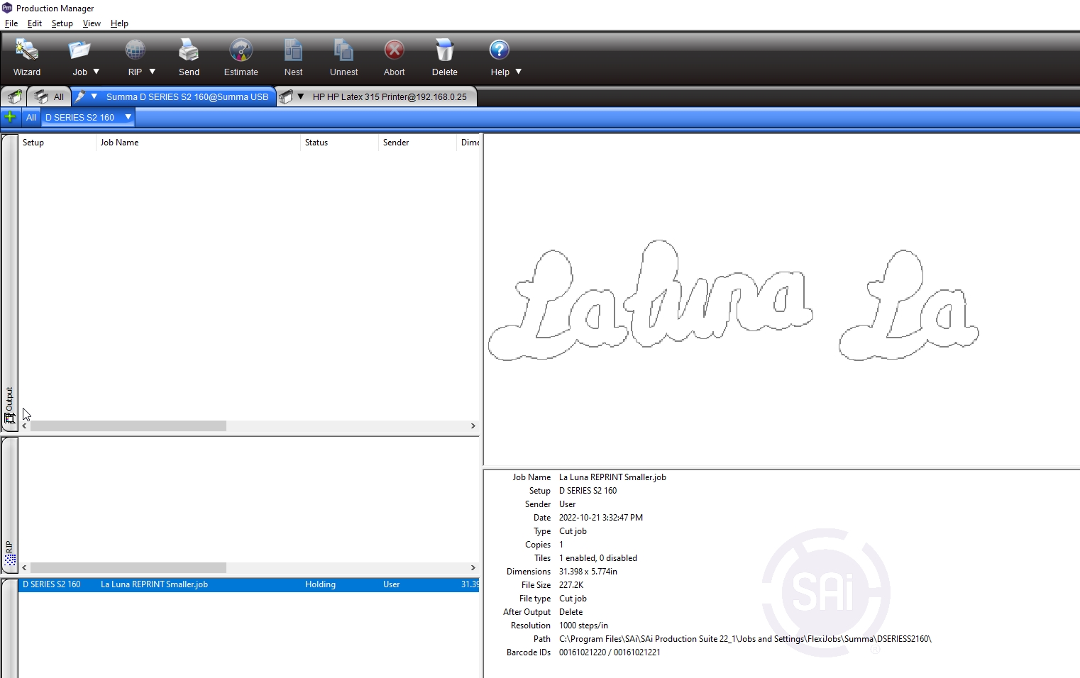

I'm using Flexi to print and contour cut two decals that say 'La Luna' on the second decal the contour cut shape on 'Luna' has disappeared. Attached pic shows missing shape in Flexi Production Manager.
I have had this happen three of four times. Like on a sheet of stickers it will drop two cut shapes (seemingly randomly). You can go back to illustrator and remake your cut shapes, save open the new file in Flexi, make a new contour cut, but the same shape is still missing in production manager.

I would guess that the missing piece either got into a different group or mask. Another strange issue I have had is that the color gets changed after it is made a contour path and then doesn't show up in production manager.

I found something that works. If I open the file in Flexi from an AI file the cut shapes appear in PM. If I open the file from an EPS, some shapes are sometimes missing. I was using an EPS.

This is the solution. Thanks Evan. The EPS had a mask and wouldn't send. I guess the AI imported to flexi with no mask. Solution - right click and 'remove all masks' Thanks again.
