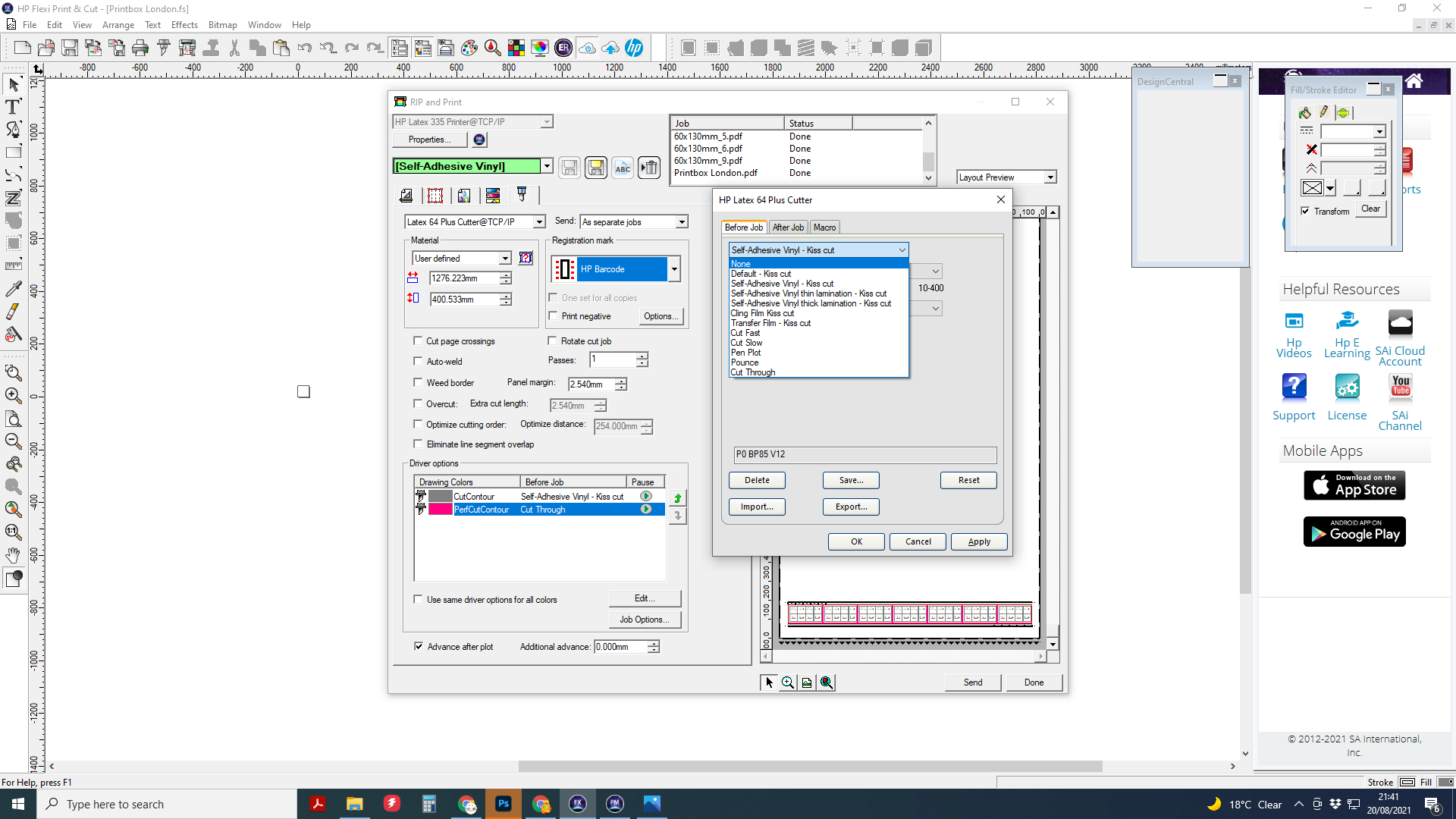

"Self-Adhesive Vinyl- Cut Through" is missig on our HP Flexi Print & Cut 21. (Please, find attached screenshot)
I'm strugling to figure this out for the past 3 entire days.
Our Supplier/ Engineers have no clue about it. I've asked several times during the training, too.
Any advice/help would be greatly appreciated
This is now located in Production Manager > Job Properties > Cut Tab > Job Options button (see attached screen grab).
