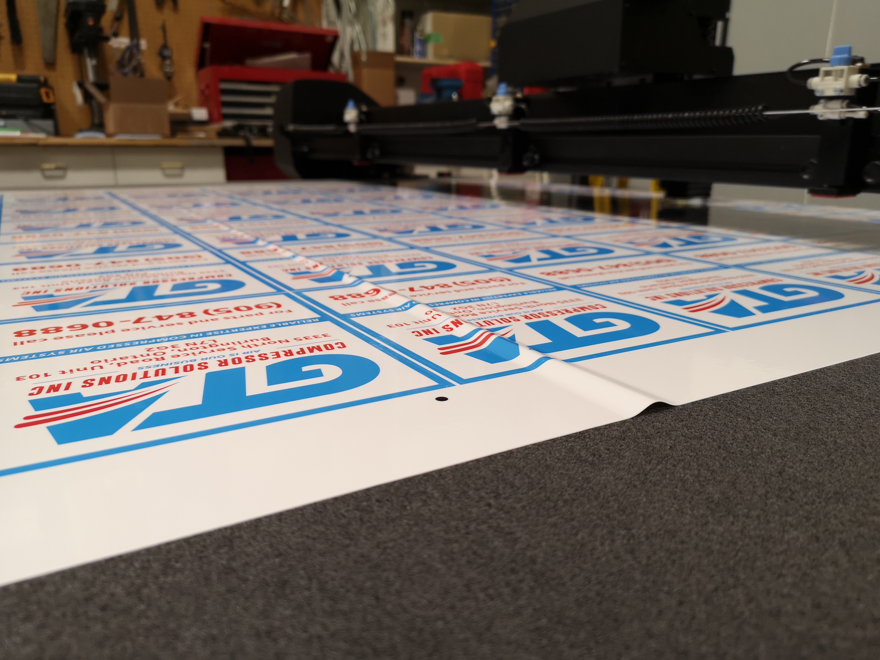

I did finally run into the issue you mentioned the other day when running calendared vinyl w/ cast laminate. (Pic attached) Had a slight buckle on one side only when it would feed it and just like you described before, the vacuum sucks it down and locks that buckle in. Luckily we were through cutting so it didn't wreck anything (the decals along the buckle were salvageable) but definitely not ideal.
I did try adding a little tension to the roll as it was feeding and that eliminated the issue. Again, not ideal but in our case it was definitely related to the lack of tension on the material as it fed forward on the bed.
I'd like to to try and experiment with some kind of tension bar to save having to stand there and do it manually, similar to a dancer bar on a take-up reel.
