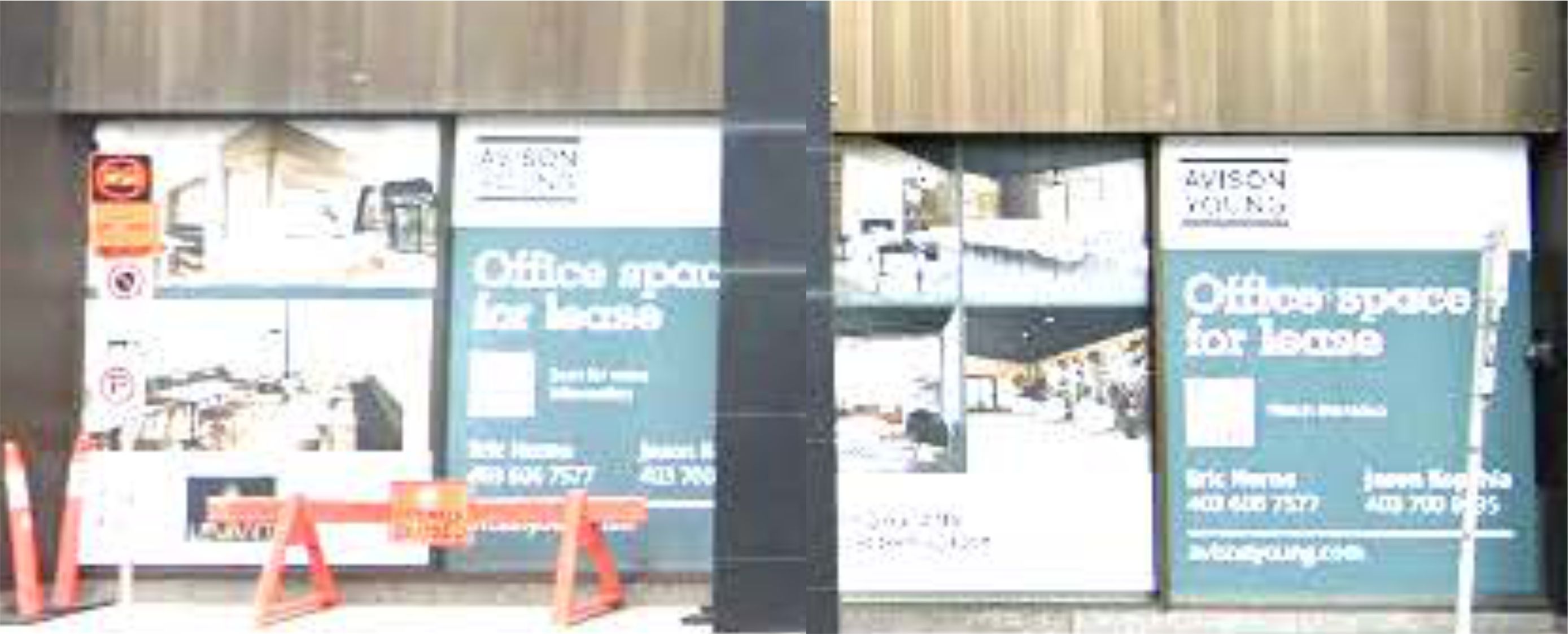

Checking-in to see what the preferred film is for something like this
"commercial FOR LEASE" type signage
- 6 - 12 month on glass
- location: Western Canada, so we're seeing freezing temps - needs to be something I can install just above freezing when it warms for a day or two.
- ideally easy to install tiled panels (in cooler weather)
- ideally easy-ish to remove at 12 month mark
- ideally - cheap
I was thinking unlaminated IJ40c, but I know there's going to be thicker materials up around the 3-4mil thickness that will help aid the install.
I'm fairly familiar with films, but I know there's shops whom print oodles of this stuff and know the way to go.
Thanks in advance.
