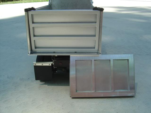

REALLY? your goint to put a flimsy alumipanel............onto a STEEL PLATE DUMP TRUCK BED????hahahahahahaha...........
iam assuming you ONLY PRINT........so you need to learn how to split the print and apply it to the existing panels and also apply the print to the outside surface of the 2" piece of steel that seperates the panels.

I could letter each panel and that wouldnt be a problem but he wants something mounted to make the back panel look flat.

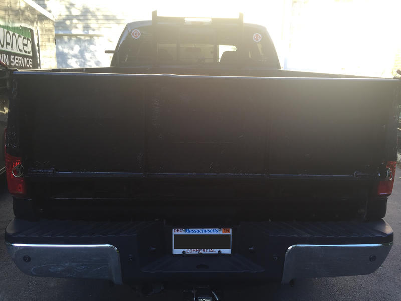

Sorry guys here is the picture.
that is the worst picture ever as no clue what I am looking at. isn't that a regular puck up truck with what might be some vertical angle attached to the tail gate? not sure what you are trying to do. if there is 2" angle, can you make a pan with a 2" return and put it over the vertical angle (that is if that is what the picture shows)
Billct2
Forget what I said, I was talking about a dump truck like OP posted a pic of. That looks like a homemade POS and there's no good way to make it work. Maybe what Marlene suggested, but the best thing it to tell him to break out his welder again and put a steel plate on there.

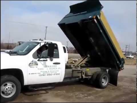

OldPaint
from the crap photo............
i gather its 1 ton pickup frame(maybe a dullie) with a small dump bed addition. see a lot of these. STILL.........
LIKE GINO SAID.......... you a body or a sign shop???? that needs to have at LEAST .60......steel panel WELDED to it. ANYTHING THING LESS........ is STUPID!!!!!!!!!!

Billct2
Must be more than a few stupid sign shops around here. Pretty common to see ACM or aluminum panels with digital prints fastened to a dump truck. Or like one of our customers, 4mm ACM cut out reflective logos fastened to the sides & tailgates of dump trailers, been using them for 15 years. I'll let them know next time I can't do any more because it's stupid.
OldPaint
TRAILERS..SIDES OF DUMP BEDS... are ok..............TAILGATE ON A DUMP BED......STUPID
do em all day long as far as i give 2 schits.........POINT IS......... tailgate on a dump TAKES A BEATING.....when they are loaded bucket driver puts the front bumper of the tractor RIGHT ON THE TAIL GATE......when loading))))

FS-Keith
ITS A 10 FT BOX!!!! any loader can drop the load center of it........FROM THE REAR DUH!!!!!!!!!!!!!!!!!!!
you realize the OP stated a dump insert, which is an insert that goes in the existing bed of an 8' pickup truck.... Also there are no trucks on the road 10' wide without oversize load permits. You also might want to know there are very few loader buckets smaller then 6' wide unless we are talking garden tractors, So as someone stated before most trucks are loaded from the sides unless it is something palletized. Sorry none of this is really relevant to the thread starters question, it just irks me when smartasses try and make a a dik out of someone when they dont know much about what they are talking about
To answer the threadstarters question I would give the customer the option of vinyl on the tailgate and if they insist on a flat panel I would weld some clips on for mounting or even make a thin alum pan sign with a removable subframe and screw or weld the subframe to the back. that would be the nicest look and concealed fasteners, If they are just going to be super cheap then just sell them a .080 or even .125 alum panel and tek screw it right to the ribs of the gate
