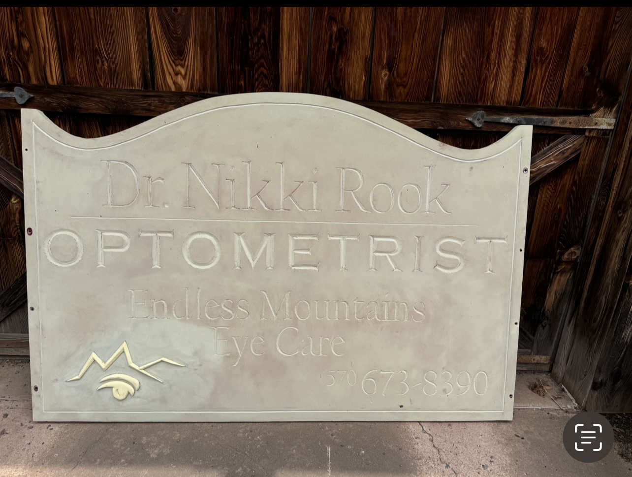

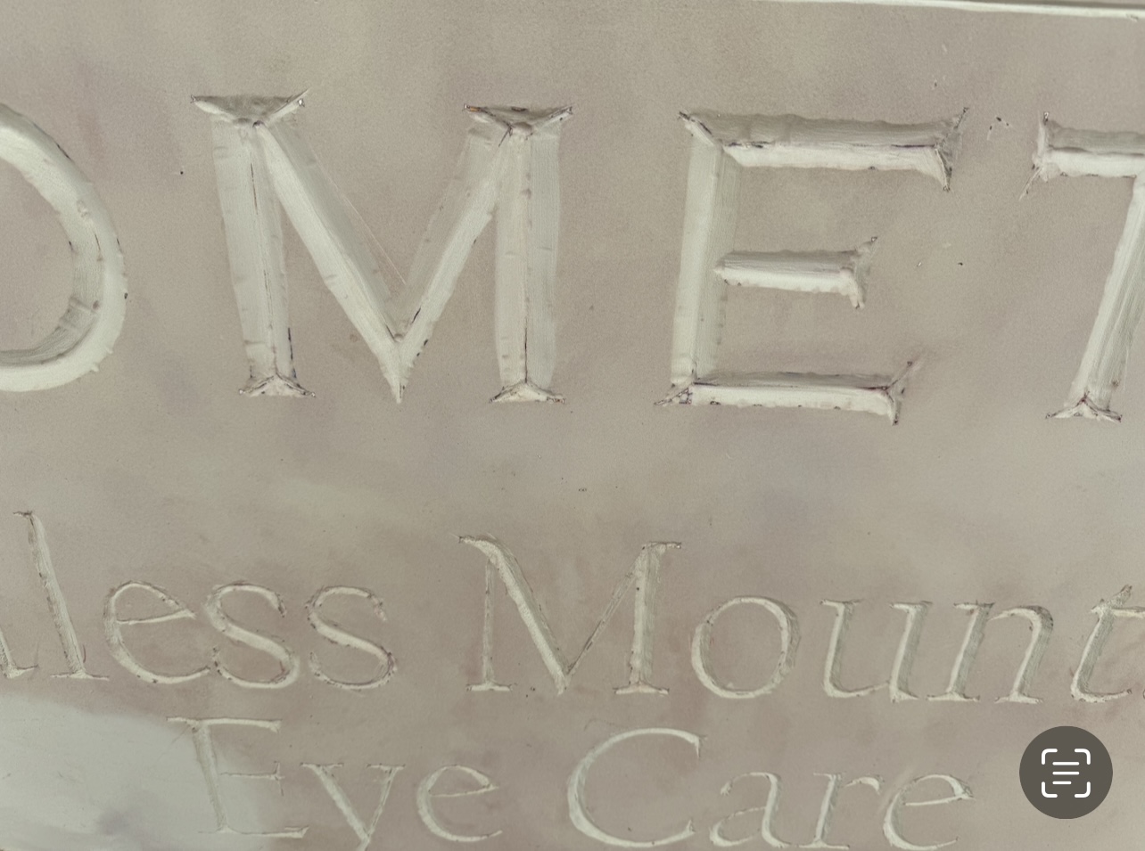

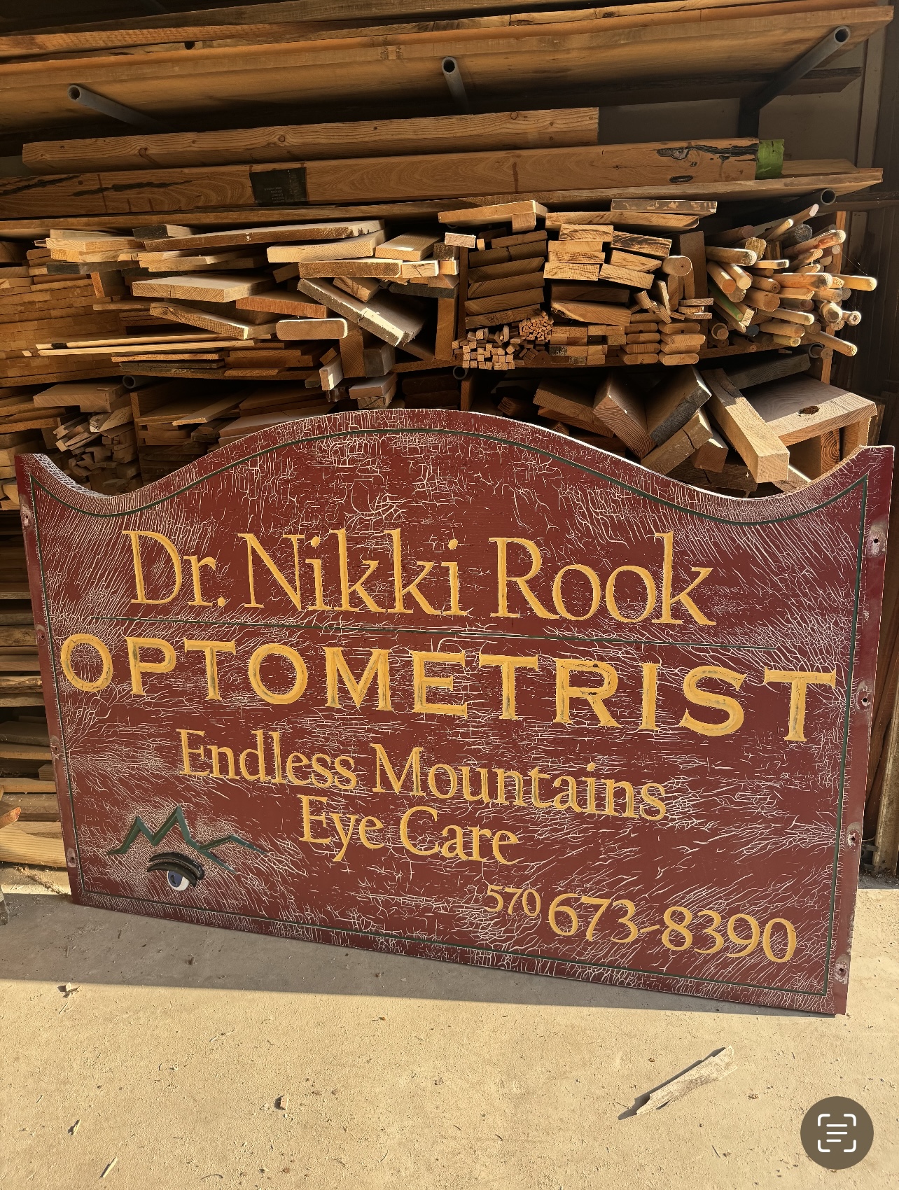

I appreciate your response. The sign was built in 2008 and we had it professionally painted. 2 years ago the sign was taken down to be refreshed and the sign company that repainted it, used a product that did not react well with the original or the prep work was not done correctly (see photo with a crackling effect) Neither of the companies are in business now and haven’t been able to do the painting, they all want to do vinyl. I have previously painted commercially for many years and have no issue with doing the sign myself. Just looking for what products to use on the HDU board. Any recommendations for the products used in the whole process would be very helpful.

Yikes, that's a mess. I get that HDU isn't cheap but I would have personally leaned towards throwing that thing in the trash and hiring a real reputable company to build a new one.
Might be a good opportunity to improve that layout (I'm looking at you, area code)
Sanding the paint down has taken enough material off that the letters are just about wrecked, unless they can be re-traced with a chisel and salvaged.

Yikes is putting it mildly.
I second White Haus's remarks. It may be past saving, economically.
But, for the time you have put into it, and you want to get a few more years out of it,
I suggest just plain, high-quality latex or acrylic house paint. Don't over think it with the paint.
Wash well with the garden hose spray to remove ALL dust that may be embedded in the pores. Simple vacuum and air-hose is not enough. Then prime with a latex primer.
Looks like gold leaf on the original. If so, use some good hiding latex primer and give it 2 coats. Then two top coats of the maroon. Then, gild your lettering.
