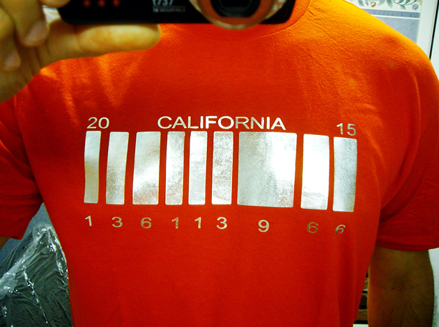

hey all, so i have a project of a Tshirt, requires Gerber Silver Medal (chrome) foil, printed on Gerbers LT transfer. ive read that the medal series should not be printed on the LT series vinyl, and i found out why. when heat transfering onto a T, the foil ink melts to the transfer tape, and starts to pull off the vinyl. you would think that the LT Transfer would have some kind of adhesive backing to create some resistance when trying to pull the transfer tape off the material. anyway, i was able do it with a 95% success rate, but i need that 5% more to be right.
heres the question, has anyone tried this? would using Frogskin over the chrome prevent the chrome from pulling up, by pulling up the Frogskin instead?
