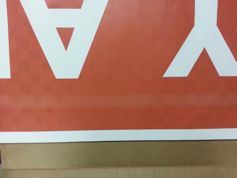

We've just started having this issue with our press. Within the first foot of the print we will get a noticeable horizontal band across the entire width of the print.
The printheads appear to be fine as the test plots show that all but one or two nozzles are firing across all 6 heads. I've cleaned the rollers and vacuum holes in case it's a media advance issue but that hasn't helped. I've also run the printhead cleaning several times with no luck, either. I've wiped down the OMAS sensor in case it was not seeing the media correctly as it passed over. The printhead cleaning kit is at about 50% and all printheads are at 250ml usage or less as I just replaced them all about two weeks ago. I'm hesitant to think it's a media issue as I've been printing off this roll for a couple hours already and it's just now started doing this. It also worked fine yesterday with a separate roll with no issues.
Any thoughts or ideas? I've attached a photo of what's happening.
