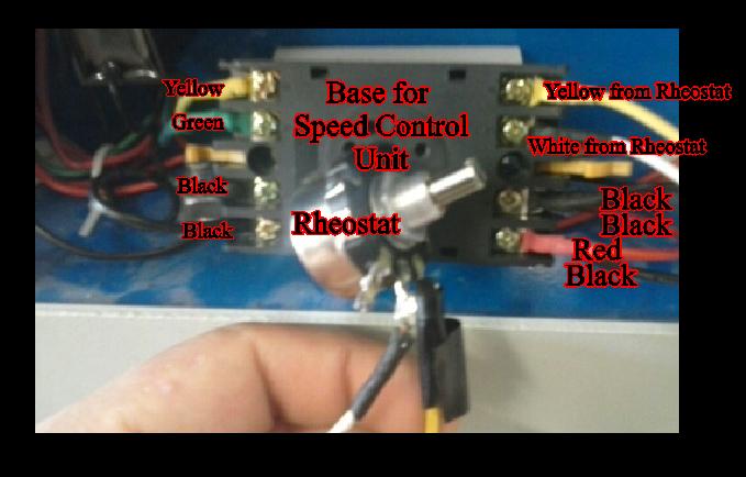

So I have a 54 inch cold laminator that is US TECH. It is an ak model and it is driving me crazy. For starters the thing will work great until it is time to do a 4x8 print. It will laminate about 7 feet and at the last moment it just wrinkles it to no end. My boss and I are at a loss for words. We have tried changing pressure, holding media flat as it goes through, etc. And nothing seems to help. But the wrinkling thing was the least of our problems till the speed control stopped working. No matter what we did the speed could not be controlled. So we called US Tech and spoke to "Dave" an asian man with a thick accent and he said, "buy speed control unit, it work very nice and fix you problem."
So we shell out $118 and buy the speed control unit and the rheostat, we hook it up and still the same problem, no control of the speed. We call "Dave" back and he says, "it you motah, there is speed control in da motah. No worry it only cost 300 dollar."
Yea thanks "Dave." So I tell him I am not spending 300 dollars and something that may not work and I take my problem online. US TECH is possibly the worst company in the world. They have very pathetic and vague manuals, poor tech support, and they are hard to understand on the phone.
So I searched GOOGLE for answers to my laminator woes and nothing came up. I began to believe that no one in the world had trouble with laminators for there was no help anywhere online. So I call "Dave" back and ask him, "Dave you guys have a wiring diagram for this machine so I can see if I hooked everything up right?"
He replies, "no, no wire. All we do is make makine, no wire."
By this point I was fed up with the situation and asked to speak to a supervisor above him. "Dave" put me on hold and he comes back on the phone and says, "I am supervisor."
In frustration I hung up and found the motor I needed on Ebay for $65 dollars and it will be here in a few days. So suprisingly "Dave" calls back and says, "How bout you take a pictsure of you wiring and a send it to my technical support guy, and he can check wire for you."
I asked him, "Well 'Dave' how is he going to do that with no wiring schematics." and then I hung up.
What do you guys think is the problem. I put in a new speed control unit, new rheostat and still I have no control over the speed at which things are laminated. "Dave" said this particular motor had its own speed control part inside of it. Does that sound right? I know this post should be in the laminator section but no one was viewing and I need advise now. I attached a photo of my wire set up so you guys can take a look. FOR SOME REASON THERE IS ABSOLUTELY NO ANSWERS ONLINE FOR LAMINATORS, WHAT IS THE DEAL WITH THAT!!! The motor is a YN90-40 I think. Please help, has anyone here had similar problems?

I appreciate everyone's response but my problem was never really laminating my prints. My problem I am facing now is that I have absolutely no control over the speed at which things are laminated. As previously stated "Dave" told me to buy speed control unit, rheostat, motah.... Basically he wanted me to buy every f%$#ing part that is on this machine to solve one problem. So I guess my question is has anyone else faced this problem of speed control being lost on their laminator, and what did they do to fix the problem? This problem is not operator error, it is a mechanical issue and I have already replaced the speed control unit inside the machine as well as the rheostat and neither part made a difference. And does anyone know of there being a wiring schematic for US TECH models online? And just because a company is generic doesn't mean that they shouldn't have tech support. Machine still cost 1,000s to buy and I think that should earn me some tech support.
P.S: If I put the pressure too high it would start to wrinkle, and if I put it too low then there would be bubbles in the laminated areas.
My boss and I have had this machine for 5 years now and have never got the thing to work flawlessly, and my boss has been running a professional shop for 28 years. He has merit, but this laminator does not.
But to repeat so hopefully I can recieve some help.
1. Has anyone else faced this problem of speed control being lost on their laminator, and what did they do to fix the problem? This problem is not operator error, it is a mechanical issue and I have already replaced the speed control unit inside the machine as well as the rheostat and neither part made a difference.
2.And does anyone know of there being a wiring schematic for US TECH models online?

Im sure this is going to be considered a stupid question in your head but im going to ask anyways. when I first set my machine up a couple days ago and turned it on, it was stuck full speed. the problem for me was that the tiny set screw on the speed adjustment dial wasn't tight which allowed the dial to spin freely on the actual shaft of the speed controller, I tightened it up and the dial actually grabs the shaft now. you might check to make sure your dial isn't just spinning freely. it shouldn't turn completely around, if it is grabbing the shaft it should stop turning when the indicator is either all the way slow or all the way fast. like I said, this is really a pretty basic reply but if you haven't checked it yet, you might since that was the problem with mine. also if youd like I could pull the side of my unit off and post a picture of the wiring if you think that may help you. mine is an ak-600
Salmoneye
I don't think that he would have that issue if he just replaced the rheostat and it is still doing it. If it's not the rheostat you would think that it had to be the wiring but if the wiring came loose one would think that it wouldn't run at all because the power wouldn't be traveling through the rheostat. Couldn't tell you. I guess there could be one in the motor and the default is full speed ahead. Have you found anything out by googling the motor model itself? I shouldn't even be replying, I don't know jack about electrical.
