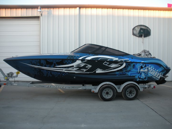

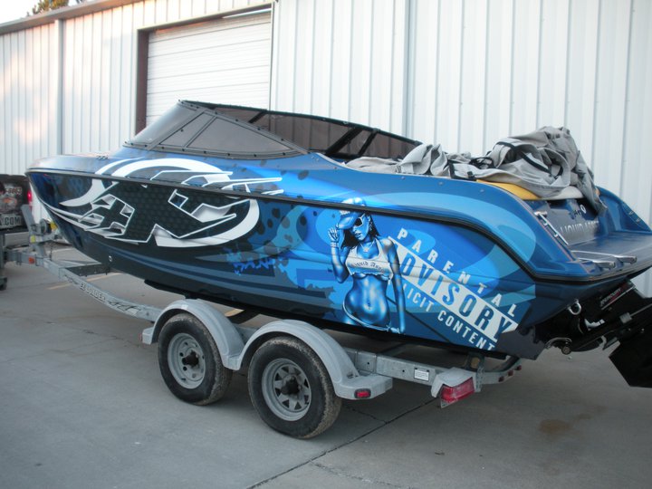

some new wraps
Wraps ink
one of my latest creations

That does look sharp!! Nice work!
With all the copyright threads going around these days I have to ask...did you have permission to use that XXX logo?
Wraps ink
Thanks, the wrap should last at least 3 to 5 years maybe longer if it stays covered in the winter...this one will also be in fresh water so no salt or corosion...its wrapped woth 3M Ij180cv3 with 3M8518 laminate
XGSSDT
Looks great but I have a couple of questions. In my understanding, aren't you suppose to stay away from products that have any type of air release technology when wrapping anything that would be in the water so water does not get into it and cause failures? and.... Isn't IJ180cv3 one of these products?
mzick
You have to cut the vinyl back 1/2" from the bottom edge of the side of the boat. You also have to make sure that all exposed edges are sealed w/ 3M 3950 edge sealer. The wrap will only last as long as the customer takes care of it. They scrape the boat against docks, stumps, or hit other trash in the water, all bets are off.
