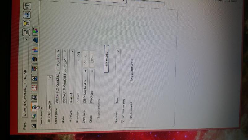

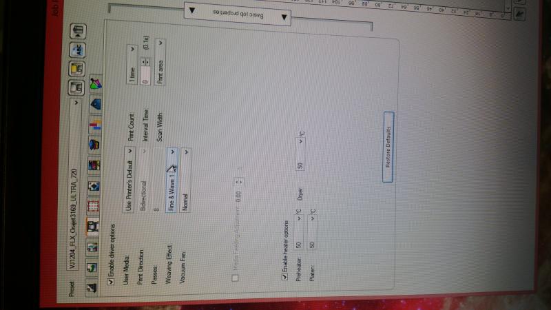

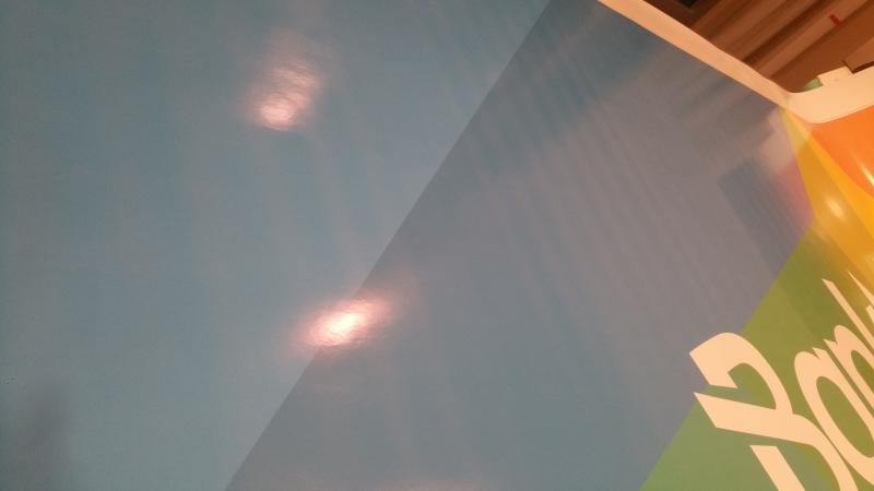

Attached is a picture of my first real issue that I am unable to address myself. I haven't come across any pictures that look similar to the white large horizontal banding type issue that I am having. I am running flexi 12 and attached are screenshots of my settings. I cleaned the encoder and the round clear disk to the left of the printer and I do the regular maintenance and have felt comfortable troubleshooting and fixing everything up until this GEM. I did a micro print and noticed that -2 looked better than neutral so I have incrementally decreased the micro adjustment to -4 and it seems to have decreased the width of the white horizontal white line patches but it hasn't gotten rid of them and I am not sure if I am on the right track or if maybe I need to adjust the Initial change in conjunction with the micro change. My initial print = 255mm, initial chance = 250.0/250mm and the feed length is 255mm and again the micro change is set to -4.....effect is fine and wave1 . Does anyone know if i am on the right track and if not can someone please point me in the proper direction. Thanks Paul
