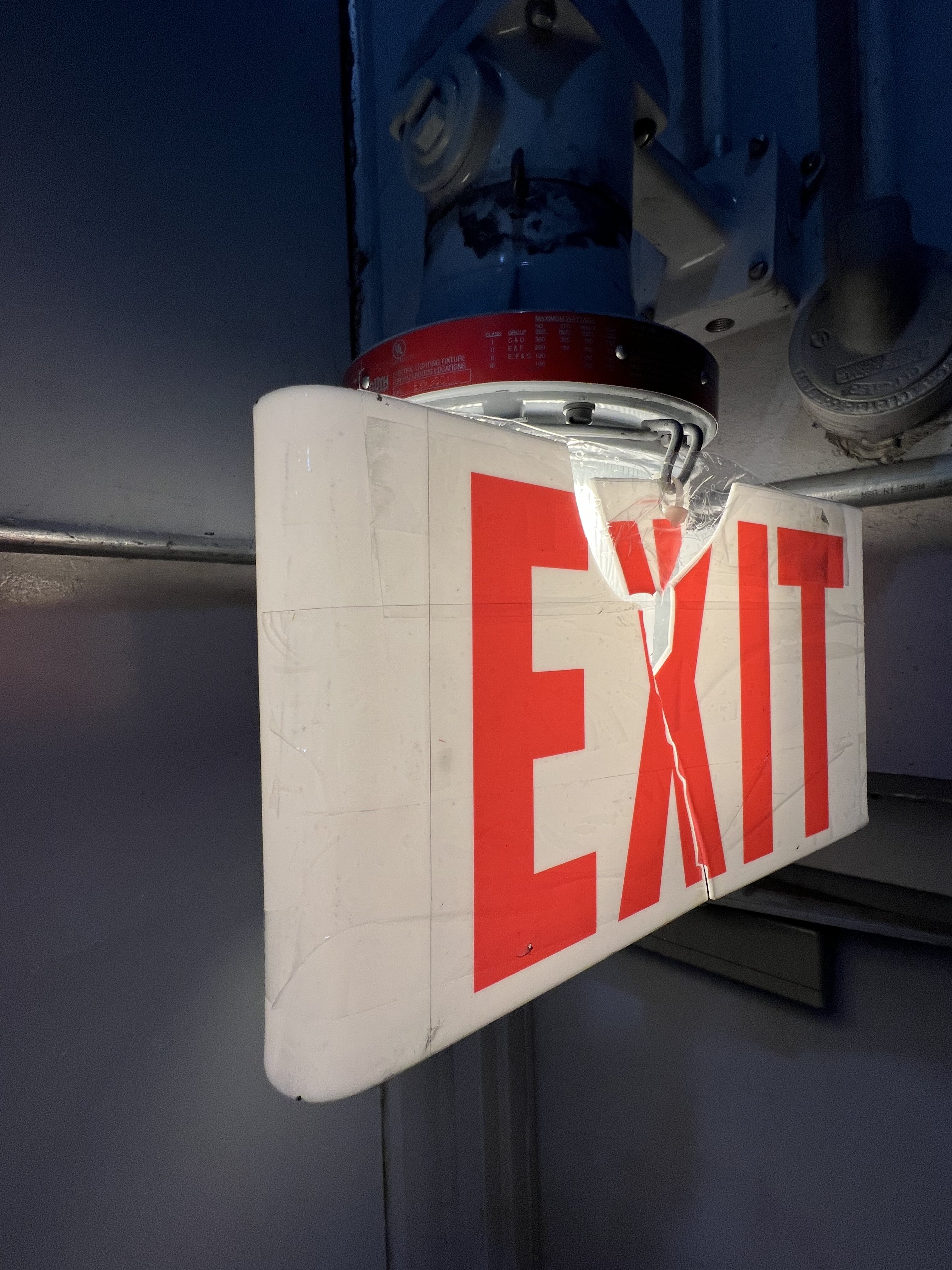

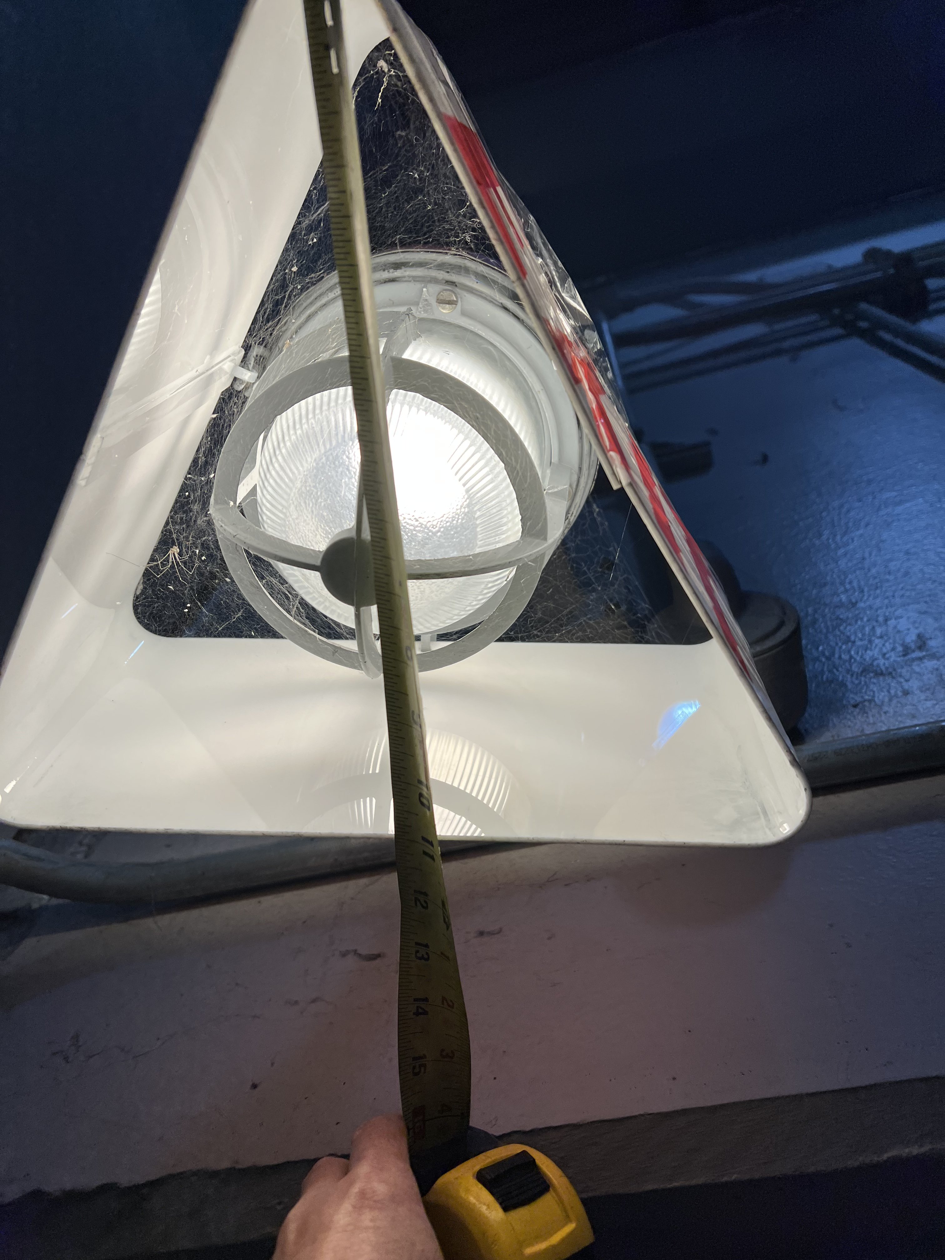

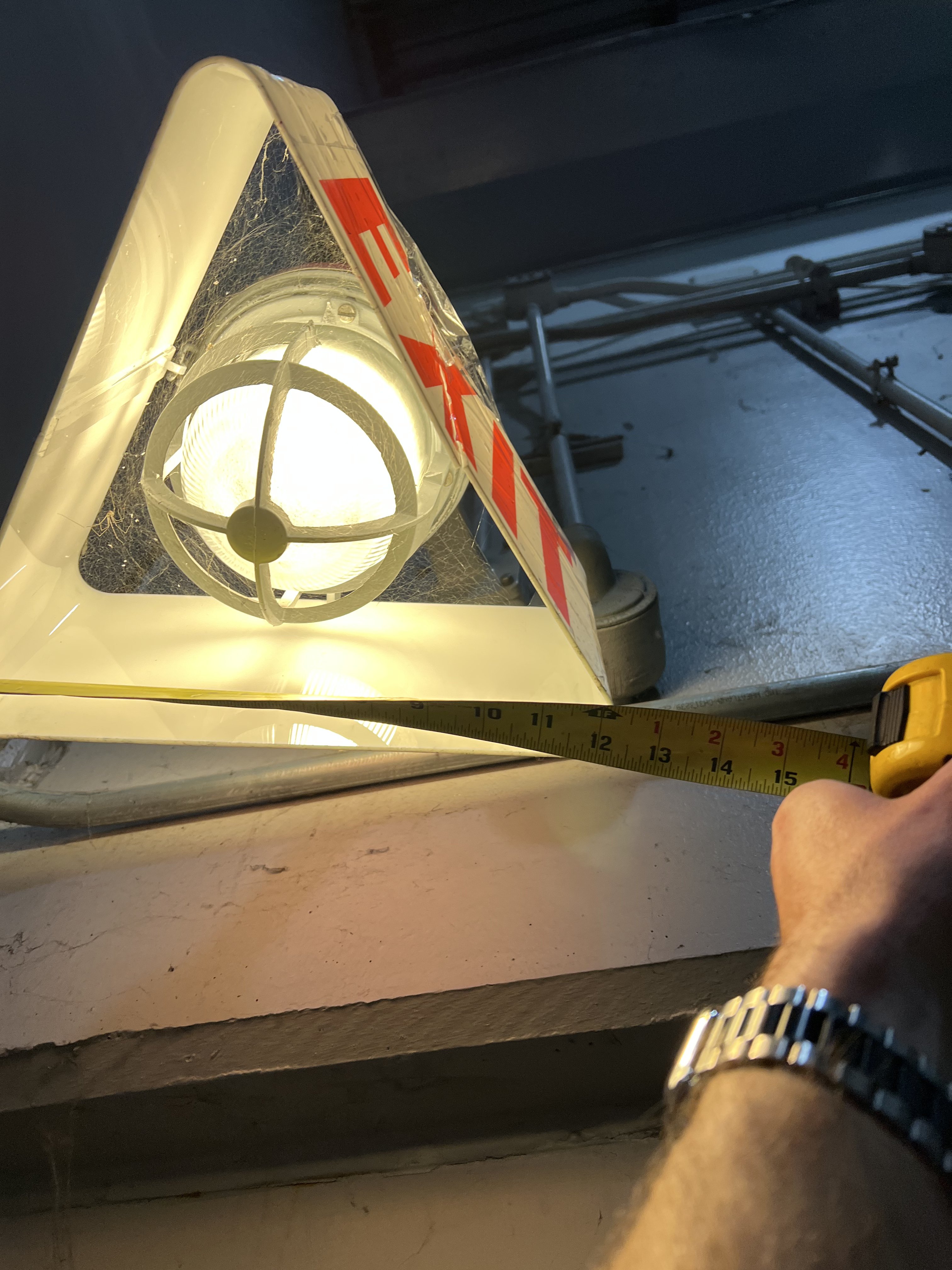

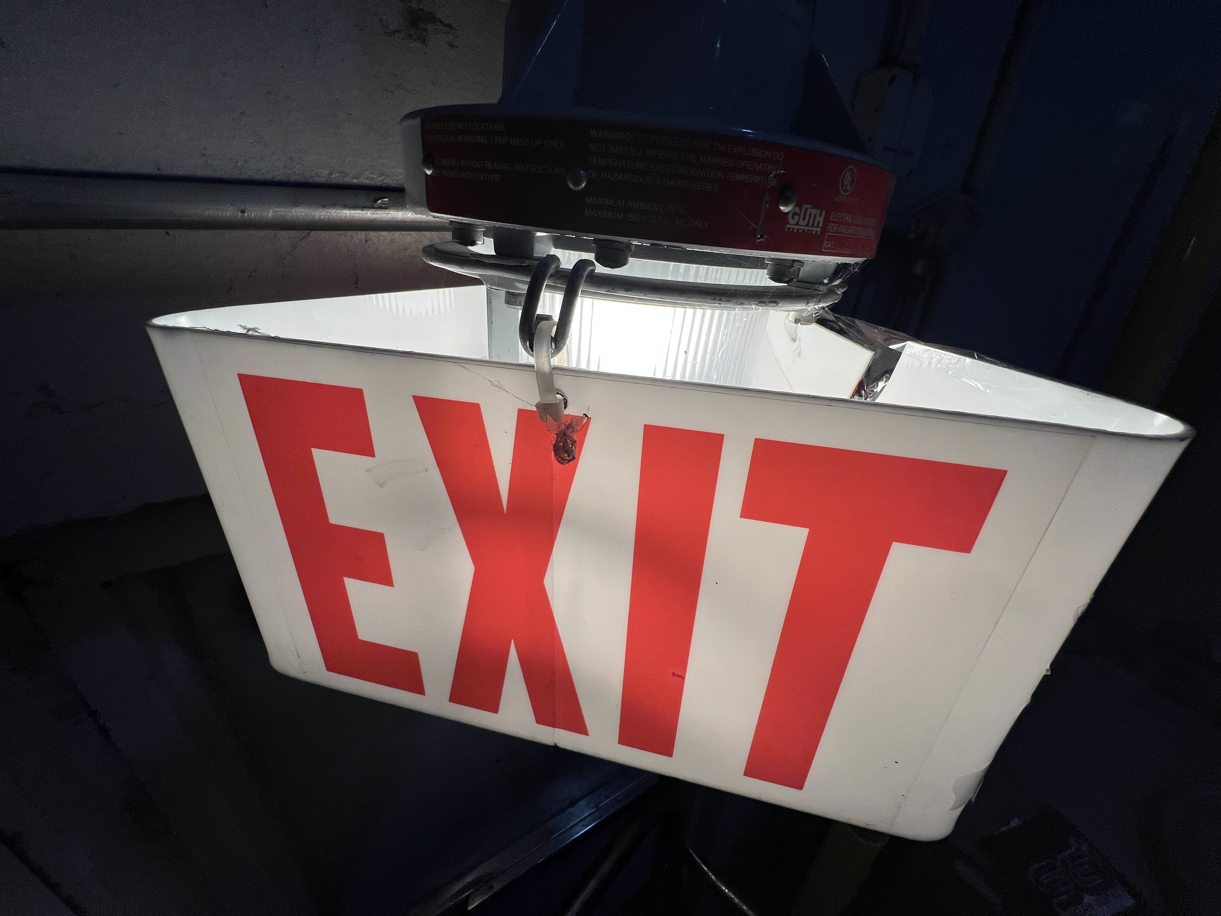

Good morning, trying to find a supplier for these style of signs. I found a company that supposedly makes them but they haven't returned my messages. If anyone has a source for these or can produce them please let me know.

Those are explosion proof fixtures. The sign would likely need to be UL listed even if it is not self lit. You can buy explosion proof exit signs, they are $$$
Yeah, they are pricey, not even worth me ordering and marking it up for my customer. I'll just send them straight to the source.

Explosion proof. It's a lighting fixture in a class 1 division 1 area. Everything has to be explosion proof meaning, the conduit and boxes can contain an explosion inside of the bodies without igniting the potentially explosive atmosphere that it is in. The conduits have seal offs to prevent the internal explosions from migrating through the whole electrical system and each box is machine fit which allows the gasses to escape from an internal explosion without igniting and/or blowing the stuff apart. It's all threaded rigid pipe.
The concern would be the material used for the sign melting or burning because it is right on the light fixture. Every electrical component is UL and would assume that the sign would also need a UL approval for that use.
