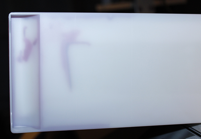

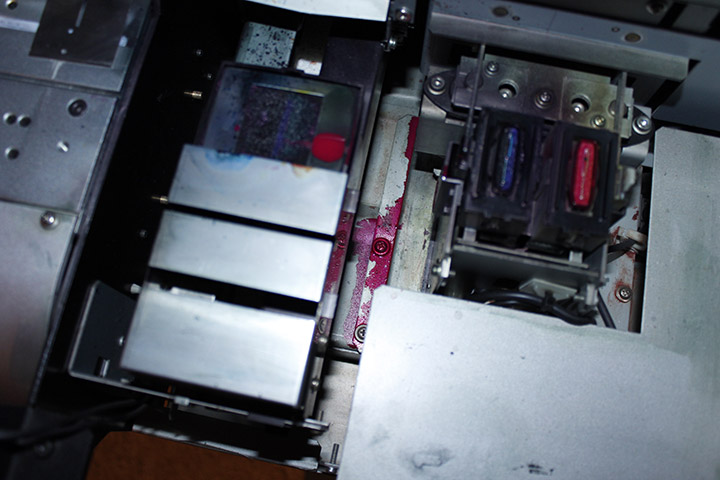

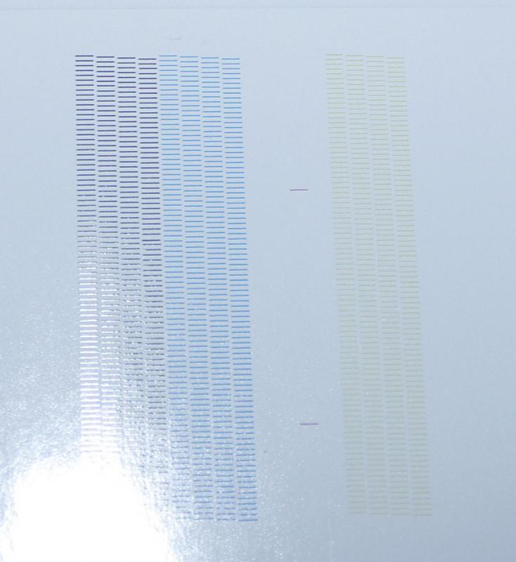

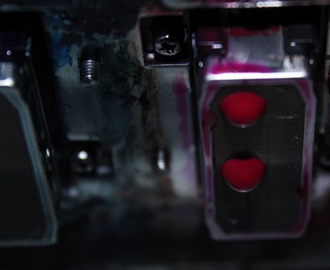

Printer suddenly started leaving drags of red spit. Stopped printer, went into cleaning/inspection and took the following images. (Print test image was after cleaning) What's wrong?

Removed rear cover over the tanks and see there is no ink in the Magenta line. Didn't get a warning that cartridge may be getting low, however, still has juice in it and the tab hasn't popped out yet.
Is it a faulty cartridge, pump issue or other?
