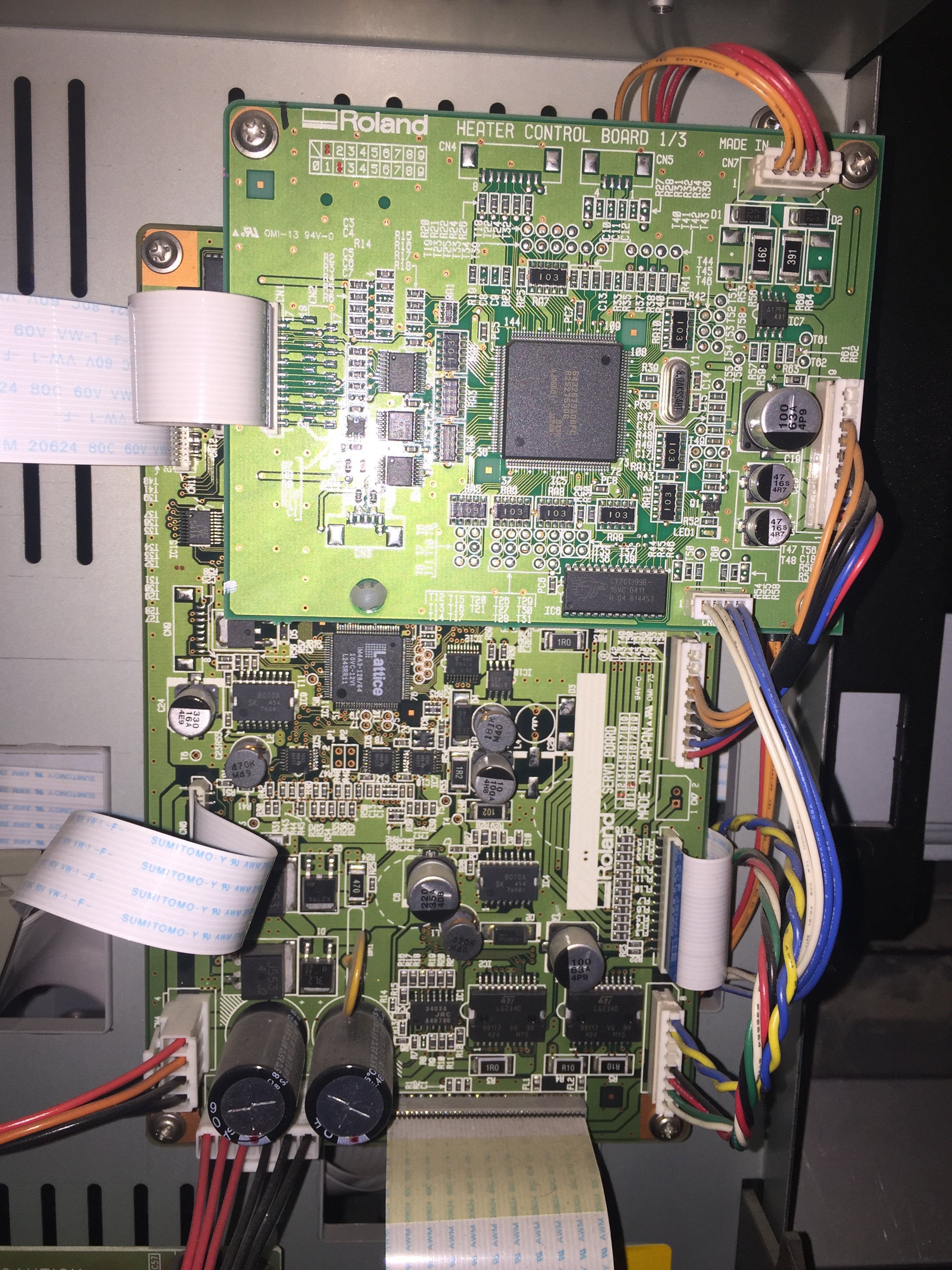

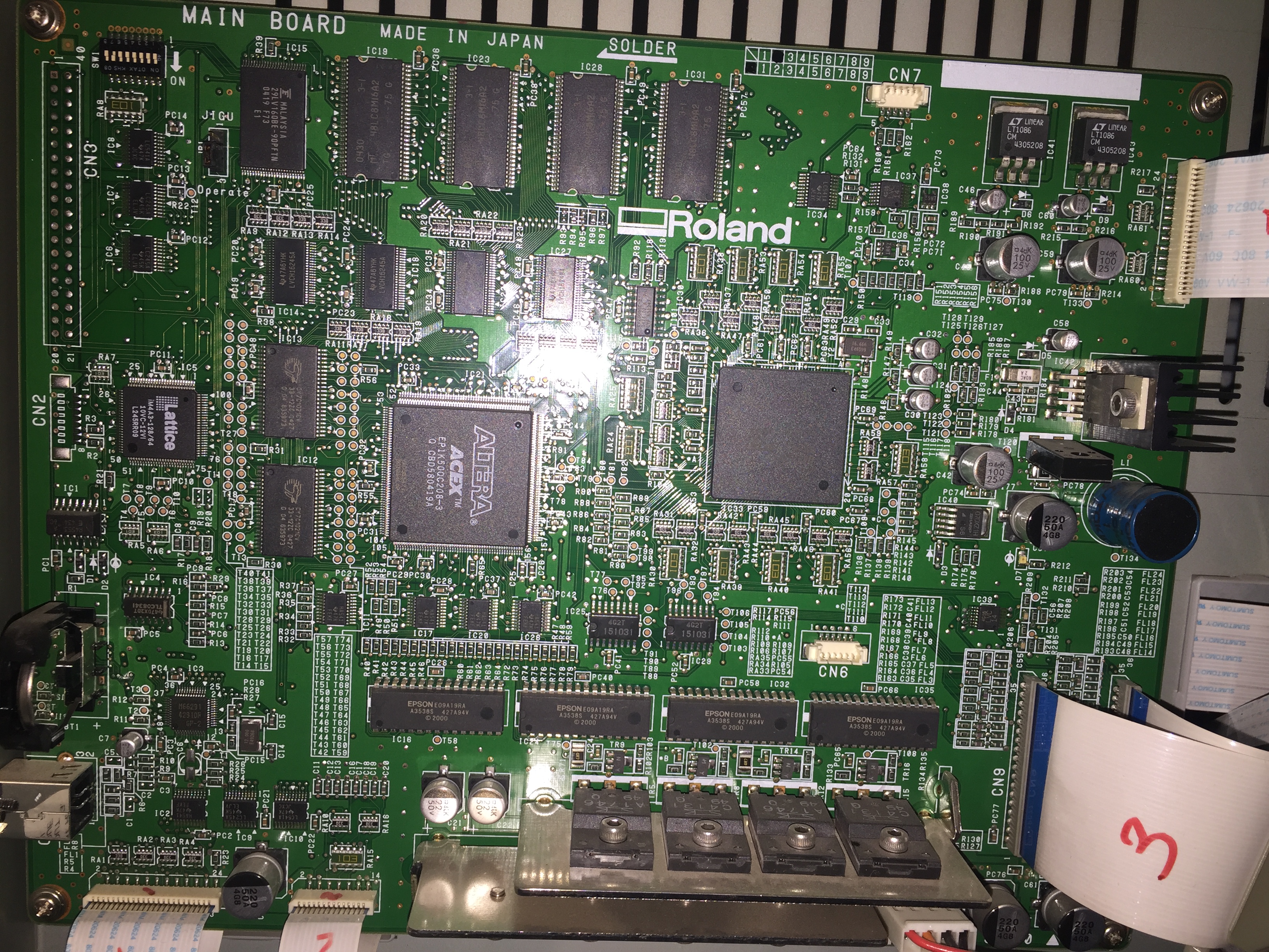

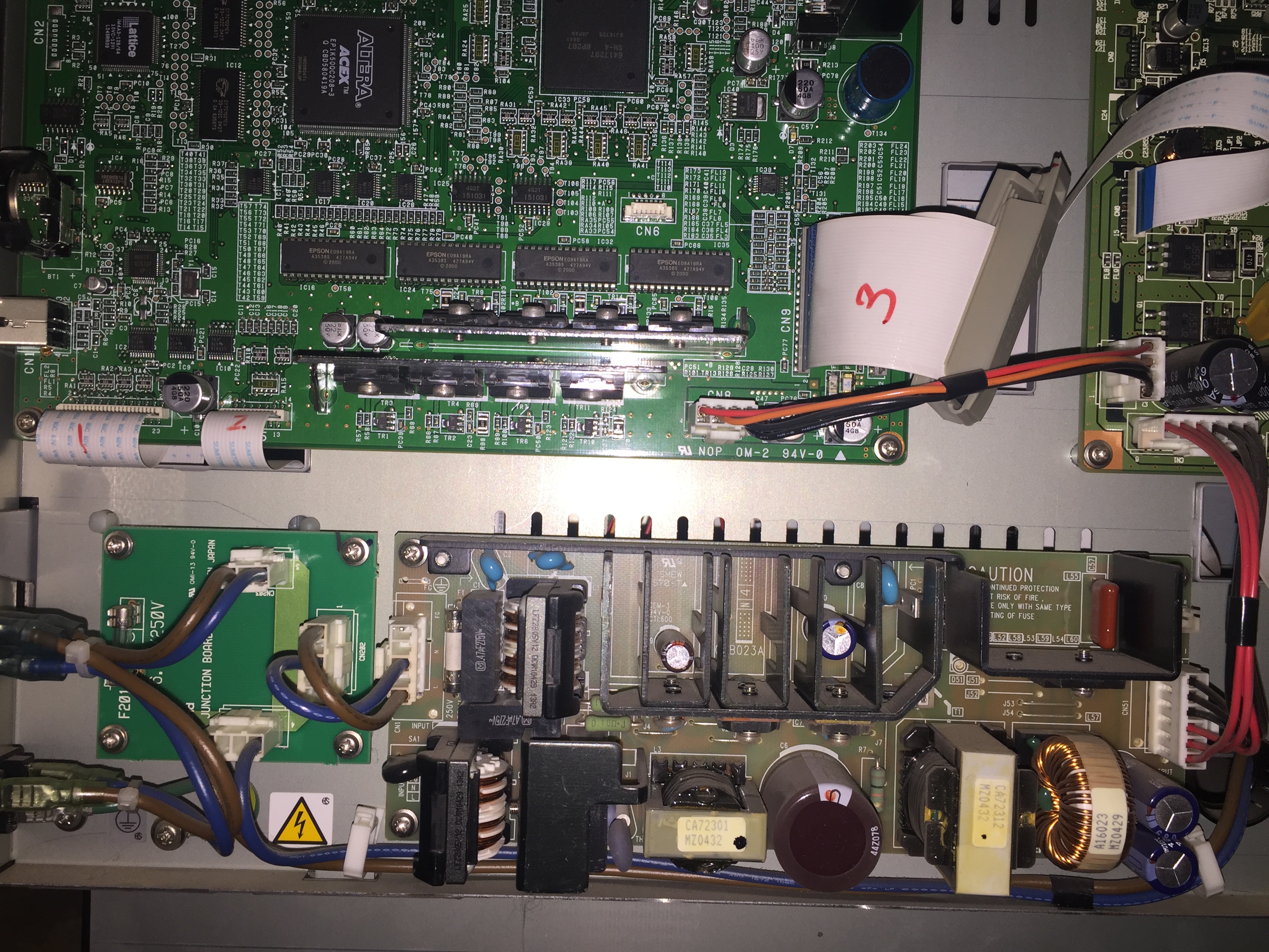

Having issues with printing, just replaced print heads and not getting ink to pump through. Was told it maybe a blown fuse, but I can't find where the fuse is. Posting pics of my main board below...any help would be cool.

View attachment 137704 View attachment 137705 View attachment 137706
The fuse is located right near that ribbon cable with the number 3 on it.
Some fuses are soldered on the main board and some are plug in fuses. In either case the fuses are very very small in size which make them hard to work on. You do not need to remove the fuse if you follow the instructions below.

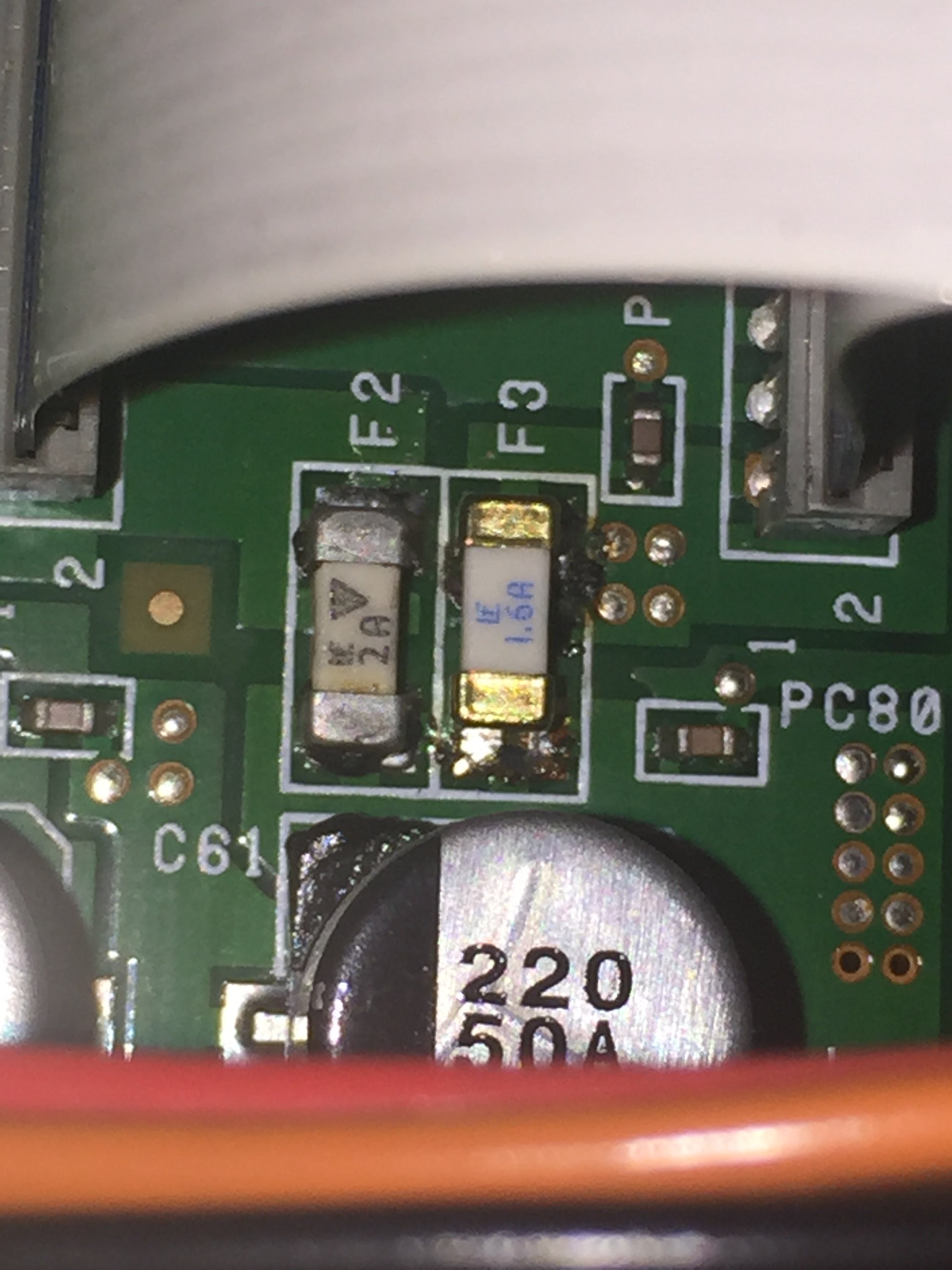

Jim, Thanks for the good work around. I now see them, it looks like they have been replaced before and soldered in( see pic below). I don't have my meter with me tonight to check. But will see if they are blown once I do.
Thanks again,
Luis
