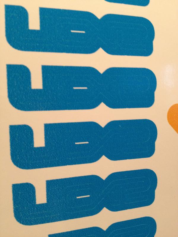

Typically we do pretty well with our printer, but lately I've noticed this problem we're having appeared out of no where. Anything we print along the far left and far right edge of the media (any media) appears extremely grainy for the first 1", and then the grain smooths out.
I've attached a picture of the far left edge of a print to show you...it's very grainy towards the edge and smooths out, it does the exact same thing on the right edge of the media. This little print is only about 2" Wide, so it goes away very quickly.
I've set basepoint to the center of the media to see if it only happens right when the nozzles start to spray, but it seems the problem is nonexistent unless we're printing to the very edge.
Called Roland, they said clean the encoder strip - did that already, got a little better but still bad.
Any other ideas??

This is a bit of a wild stab but can you feel any change in temp on the platten as you get to the two sides? Any chance the heat strips are falling away from the underside (if they have strips on that printer) or just not as hot on the edges?
Might be hard to tell by touching but I know that on my printer I get grainy prints untill the heat is at about 115 to 120F. At 110 F it still looks grainy on some media so if there is enough of a temp change on the ends it may be the cause.
You could try a simple test with another media that you know prints well with little heat. For me Oracal 751 prints nice with little to no heat as well as matte vinyl. If it prints nice to the edge on one of those you may have your answer.

The one I have problems with is oracal 3641 and to get it to print without grain I need my temp reading at 115 to 120F. I have a home made heat strip and a cooking probe for a temp reading so my 120F may not be your 120F.
I have read that most crank up the heat on mid grade vinyl so I would think about that 120F range. If you start to get puckering (risking a head strike) then drop the heat back a bit. Higher grade vinyl seem to print better with less heat.
It may be possible that your heat strip is a bit warmer in the center of the printer and unless you run it on the higher temp, the sides don't get quite warm enough.
I would try to find a way to read the actual temp on the surface of the platten to see if you do have even heat. What your print shows is possibly that the center is up to temp but the sides run a little lower temp.
For some media your 100 F print temp may be low. Try 115 to 120 F.
