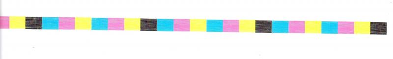

Space between black and cyan
hapycmpr
I just replaced a colored head in a Mutoh Falcon Jr. What adjustment do I make to close in the gap between the black and cyan on my nozzle test print. Blown up Pic enclosed.
CRD
Start from page 155 from the servicemanual.
Page 161 uni directional MD adjustment is your key to the problem.
Also do some test print with CYMK from the RIP.
In flexi turn on the CYMK border printing.
Check for vertical mechinical gap between black and yellow
Teh machien testprint does not fully show mechincal vertical adjustment between black and yellow!
