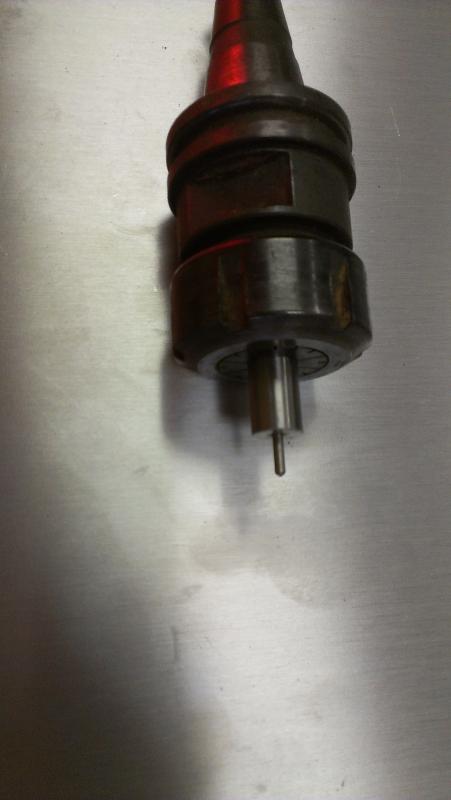

Spring Loaded 120 Degree Diamond Drag.jpg How do I calibrate and set the depth on a Spring Loaded Diamond Drag for Multicam? We have this bit at our shop, so I imagine that someone in the past has used this as well as the pen plot. I don't think we've used it this decade.

I zero to the material by slowly lowering till the spring is about half compressed and setting ZZ at that level. Seems to work... I inherited the bit with a
cnc I bought on route to where ever I am today. Gene
