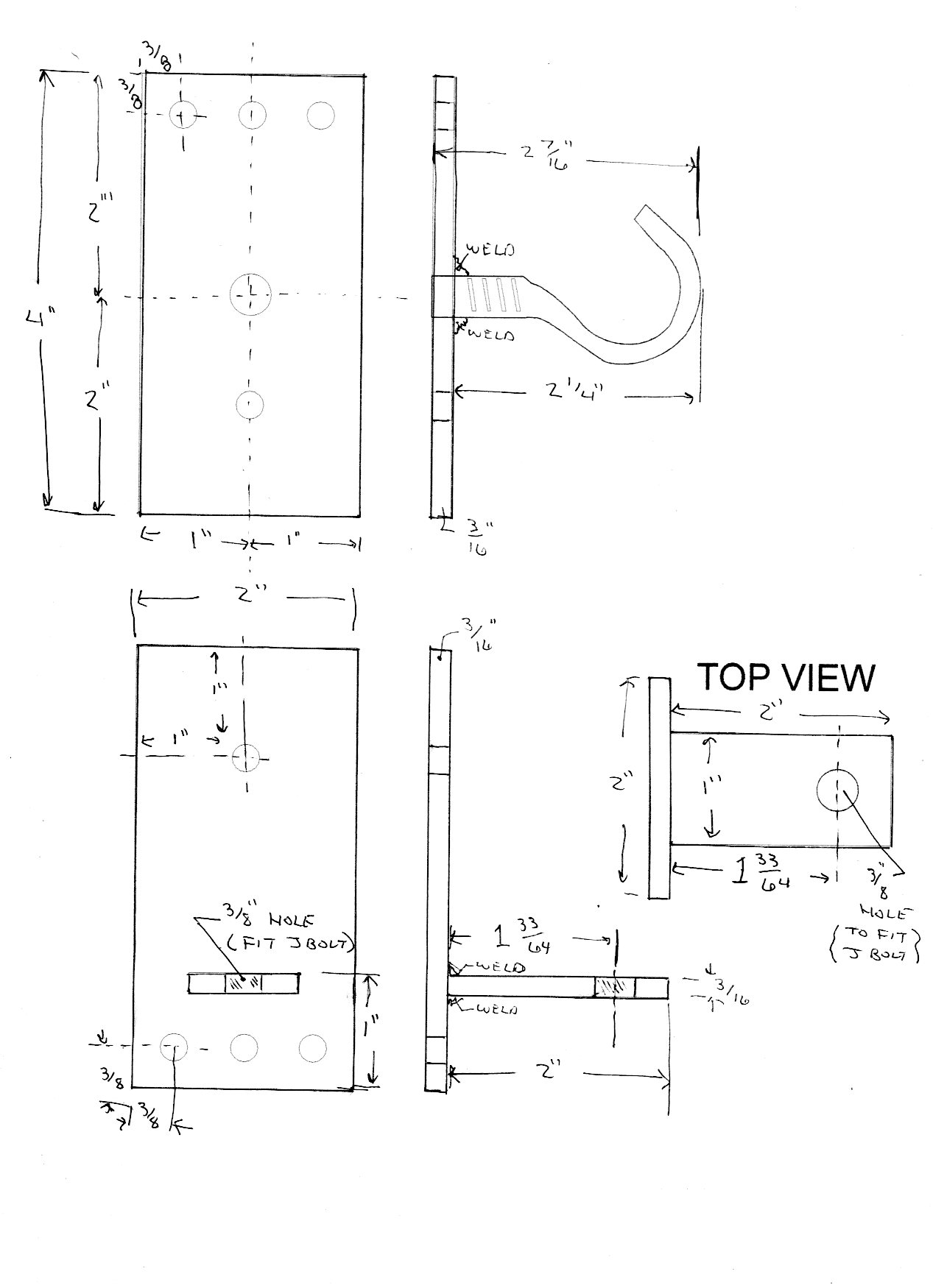

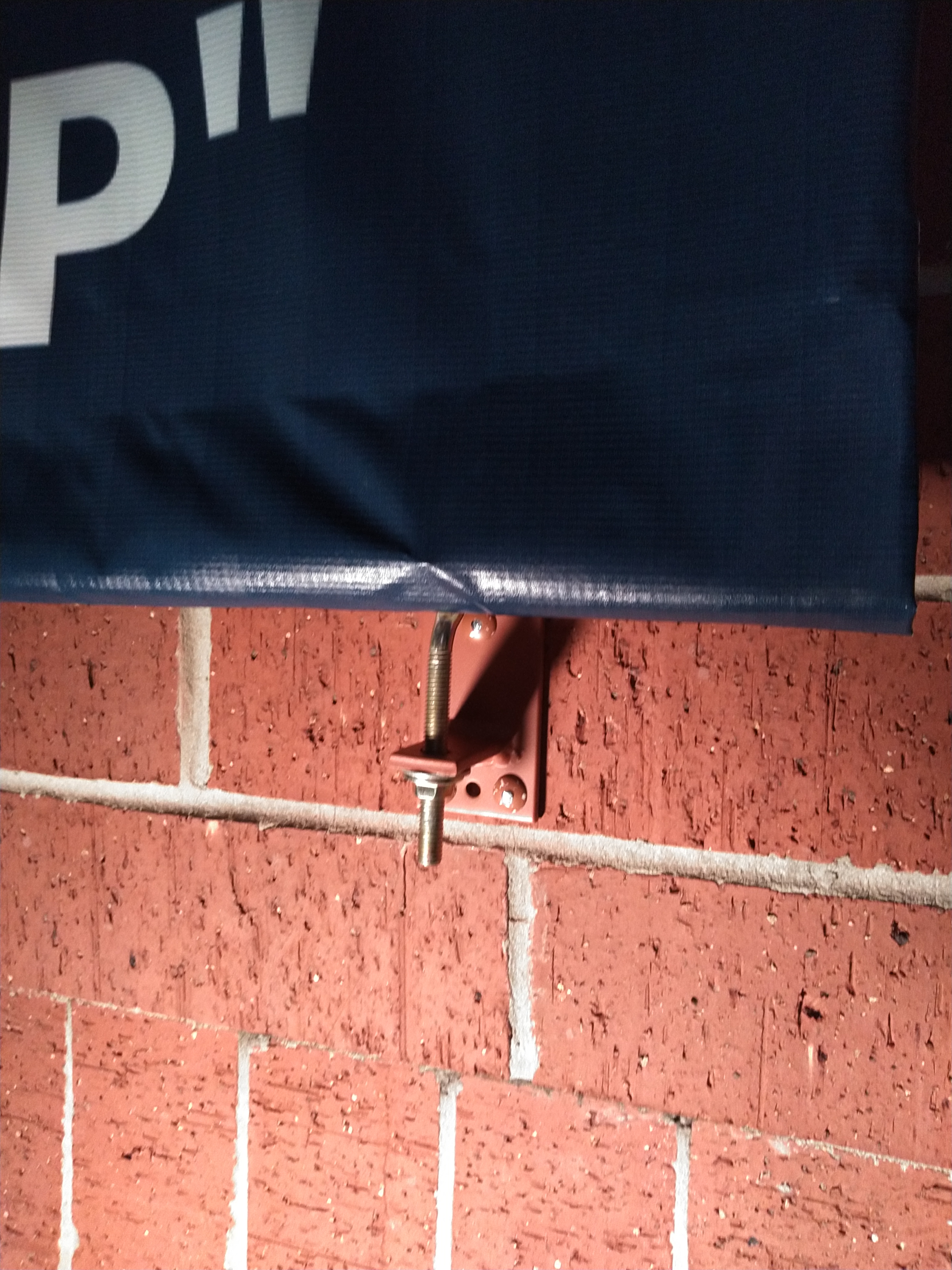

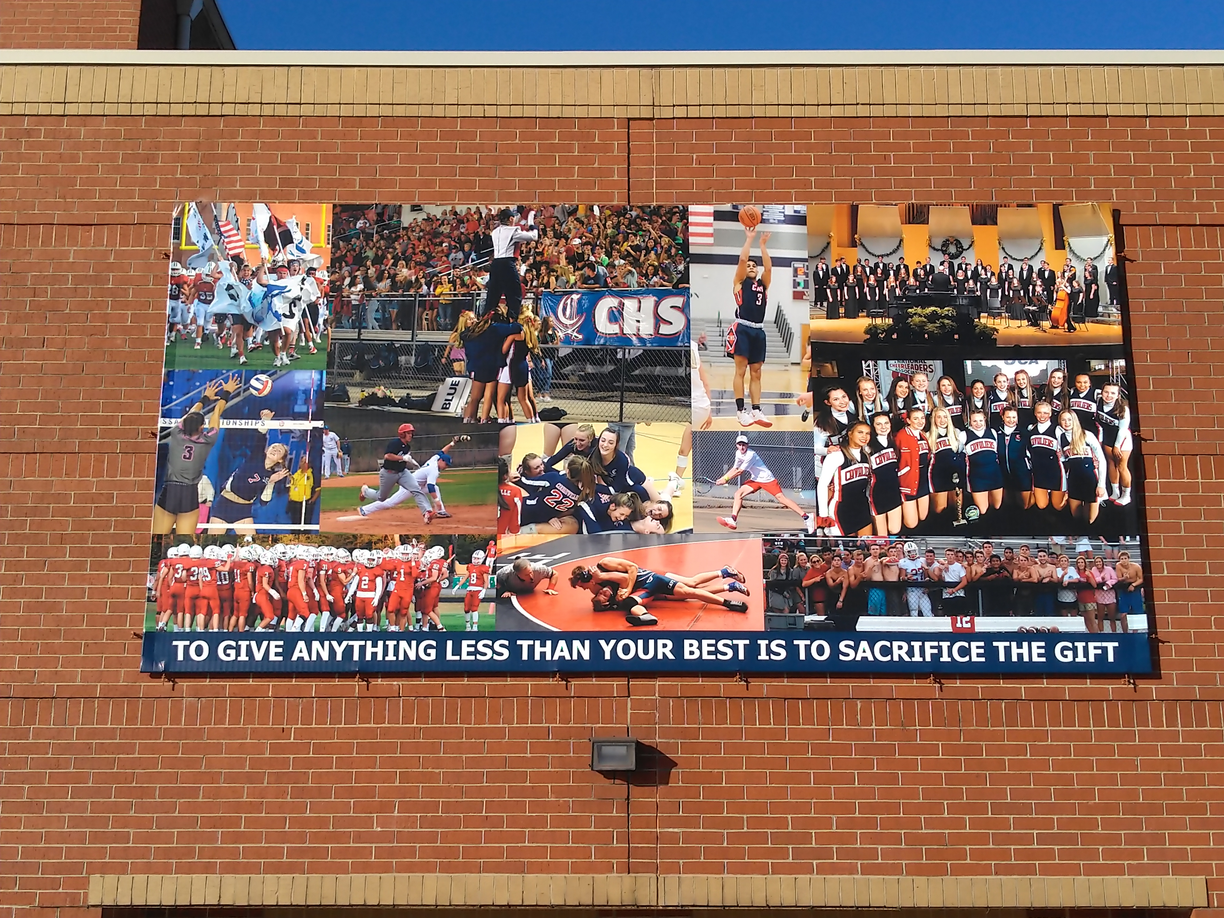

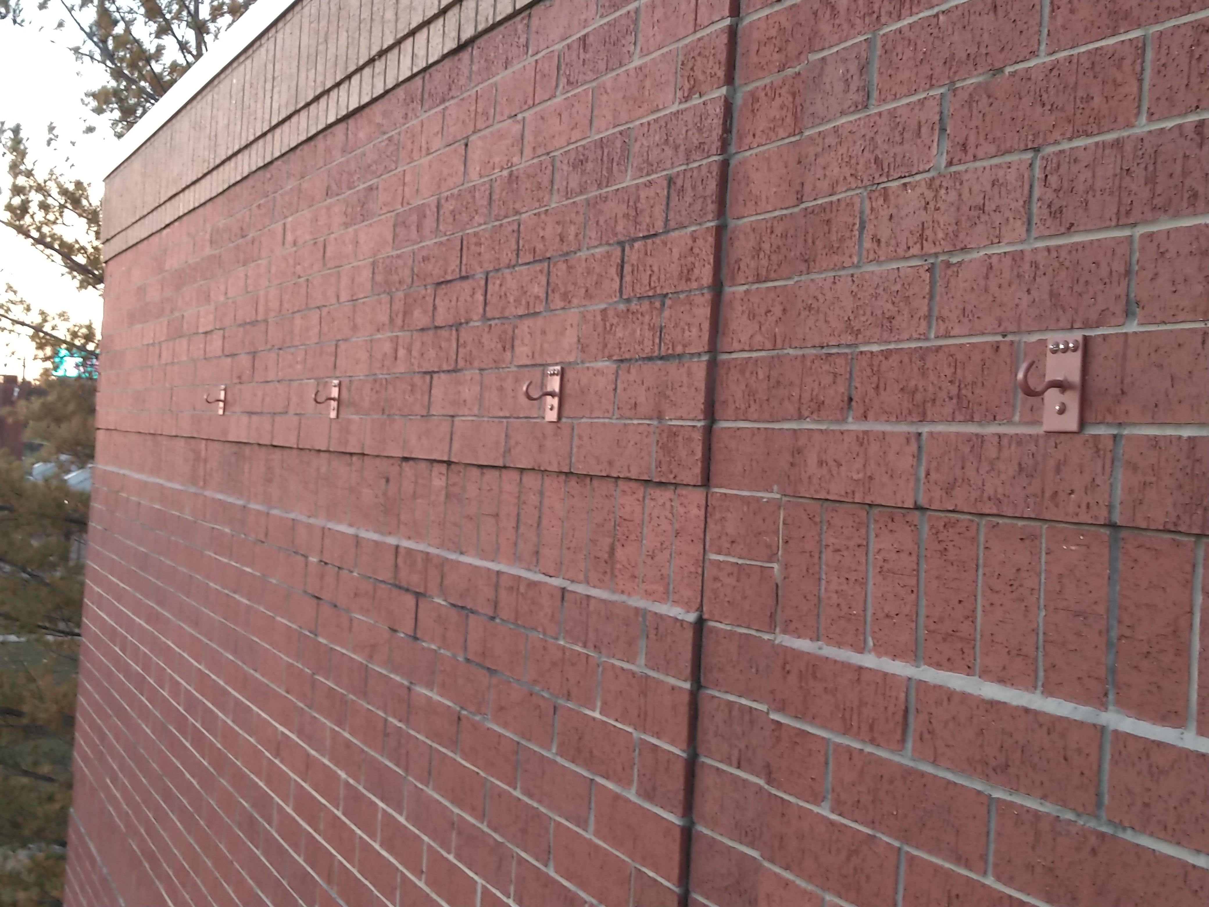

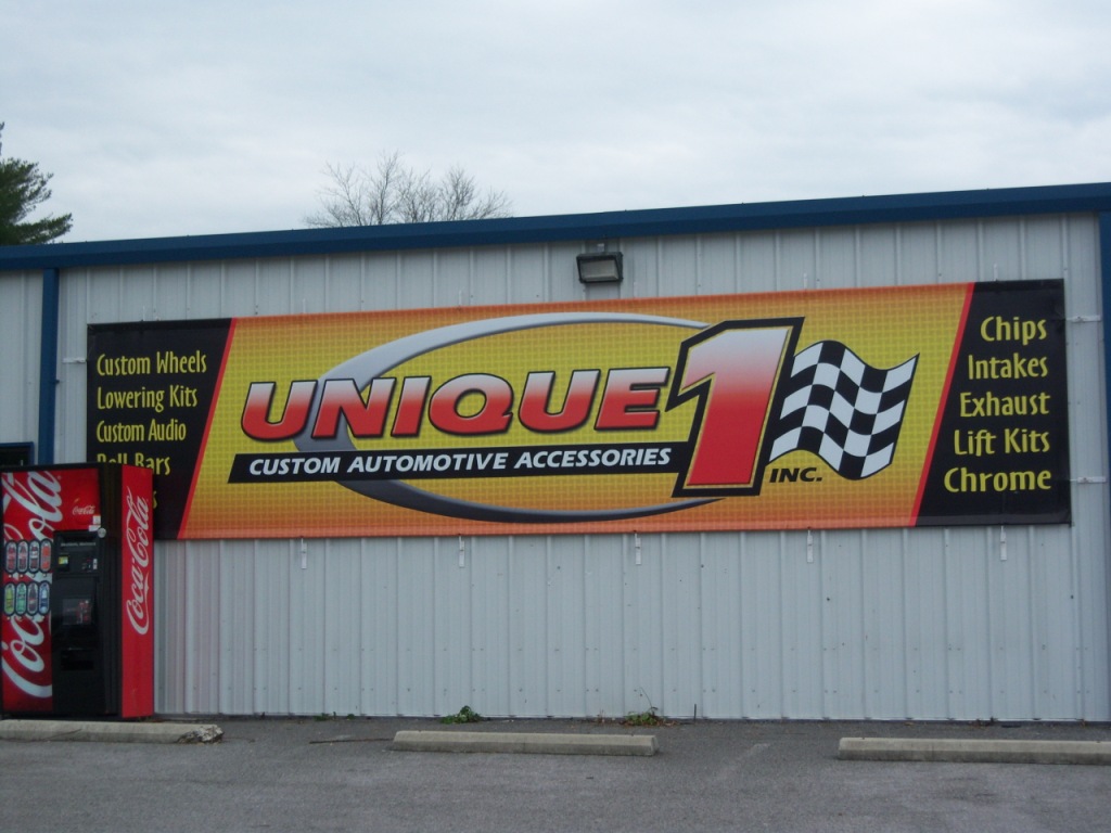

Forget the springs: I tried than crap 30 years ago. For a large wall vinyl use pole pockets. There are numerous large format wholesale printers (Circle Graphics) to choose from. I should patent this system, haha. I've been using it for years and as you can see this 12' x 24' is tighter than Dick's hat band, (whoever Dick was). Static brackets on top and one side and tension brackets on the bottom and the other side. If you have any questions, I'll do my best to answer them.

We've done a similar setup, but we CNC'd some .25" aluminum for the hangers. Where'd you find these wall mounted hooks?
