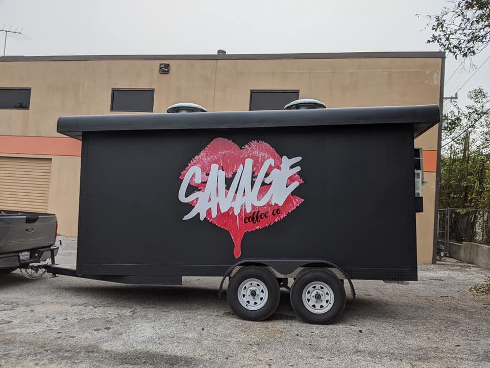

There was another question like this recently. I did a coffee truck about 3 or 4 years ago that I wrapped in 3M Matte black. I then overlayed graphics using Arlon 4500GLX with a 3420 satin lam.
No problems as far as I know of. I've seen the trailer a few times and it still looked pretty good.
