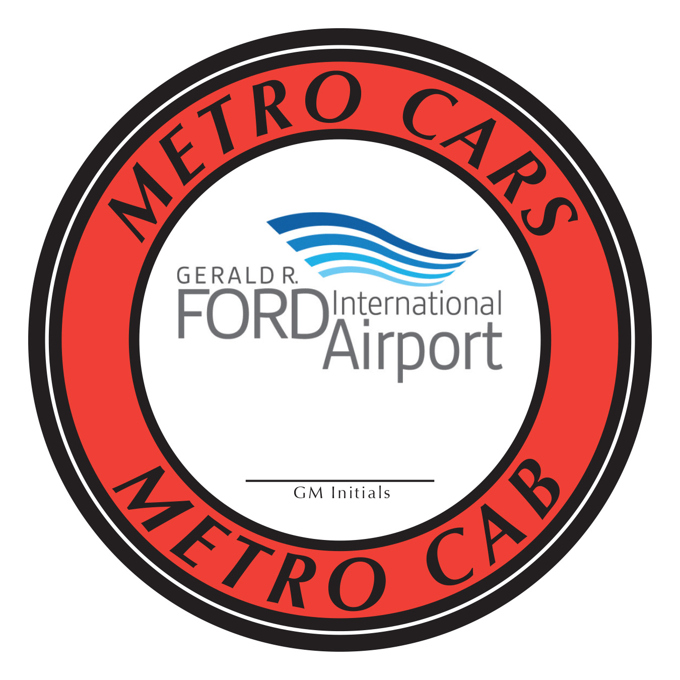

I recently did a run of 4" circle white clings. they had a heavy .5 "red & black border with a white center. these were to go on the inside of the windshield. the white center stuck just fine but the printed border would not stick
