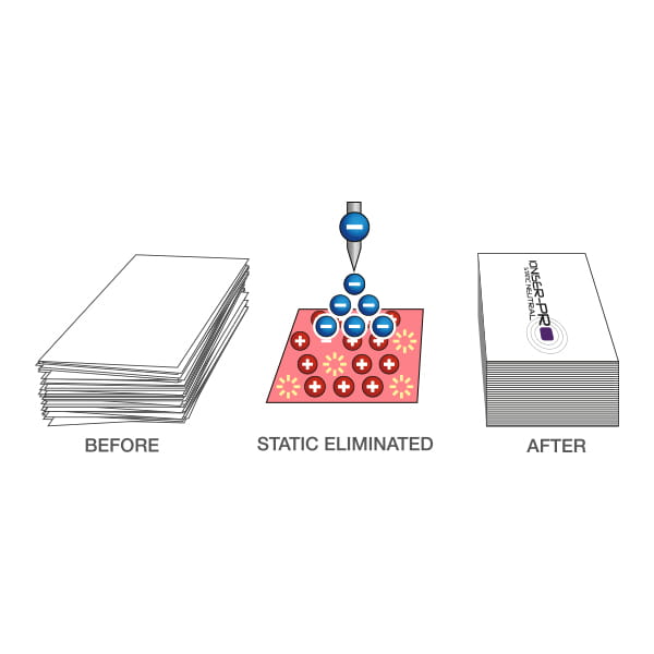

Back when I dealt with pallets of coro. sintra, and other static prone materials, we used those ionizing anti-static guns. We had a couple variations, one was just a blow gun attached to an air hose that we could use anywhere, the CNC even had an air hose with one attached, and big units that had their own transformer we used at the flatbeds. The one with the transformer really paid off, because when you blew the sheet off on the pallet, any static that returned from moving it to the bed, you just blew it off again, it also removed any dust or debris that would be attracted because of the static. Only takes seconds to do, vs the time it takes to wipe sheets down. If you do have to wipe sheets down with alcohol or adhesion promoter, you can use them to dry sheets off, and remove static at the same time just before printing. They run anywhere from a few hundred for the air hose ones to well over a grand for the transformer models, which work way better. And you'll need clean air (we just used really good separators and filters on air lines from the shop). If you only do a few sheets here and there it can be a hefty investment, but if you do a lot on a daily basis like we did, they might be worth looking into.
This is the company we went through for all this, ours were older versions. They have anti static everything, ionizing room fans, anti static bars for equipment, cords, copper tinsel: https://amstat.com/static-eliminators/anti-static-guns/
