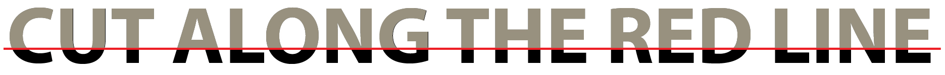

Another good way if studs are not involved.................
Layout the letters on your computer screen and cut to the red line. Use the bottom piece, taped on the wall as your template and when all the letters are sticking on, remove the template.
