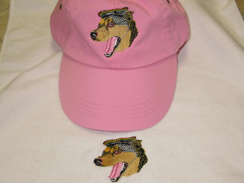

Then I came across Embird. It is sold in modules. I bought the basic program ($165) and the design Studio (digitizing) module ($150). Later, I added the font conversion program ($145) but I started out by buying their pre-digitized alphabets (which cost $15 each and work with the Studio module). They have a Sfumato module which digitizes photos and a cross-stitch module. (I haven't used either of these yet.)
Photorealism digitizing should be done manually and done to the size that you need it for. Every single module that tried to automate that process has yielded less then desirable results, if known how to do it manually. Some are better then others, but none are perfect. Post conversion cleanup is often worse then just flat out digitizing it from the start.
