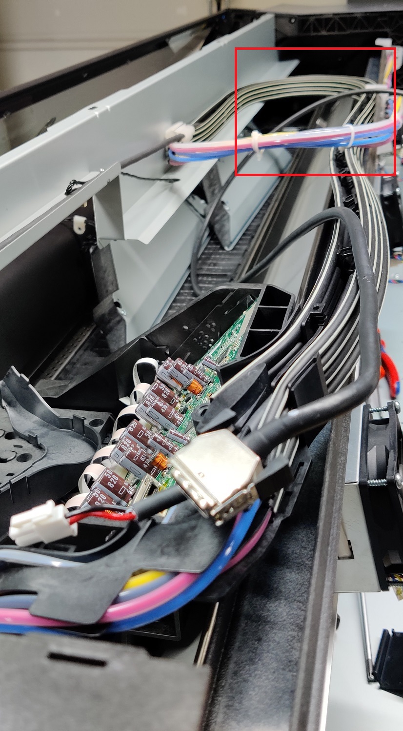

Open the window and reach up towards the top panel, under that you will have the trailing pack with ink tubes and cables. Lift that down (it's in a U shaped channel), open it a little bit and inspect the trailing cable (fat data cable) for any damage. If you can see the wires from inside, it's broken and it needs to be replaced.
2ET72-67020 Trailing Cable
It's this cable in the picture that's taken out. You want to check especially that spot where the U-motion rocks the cable back and forth.

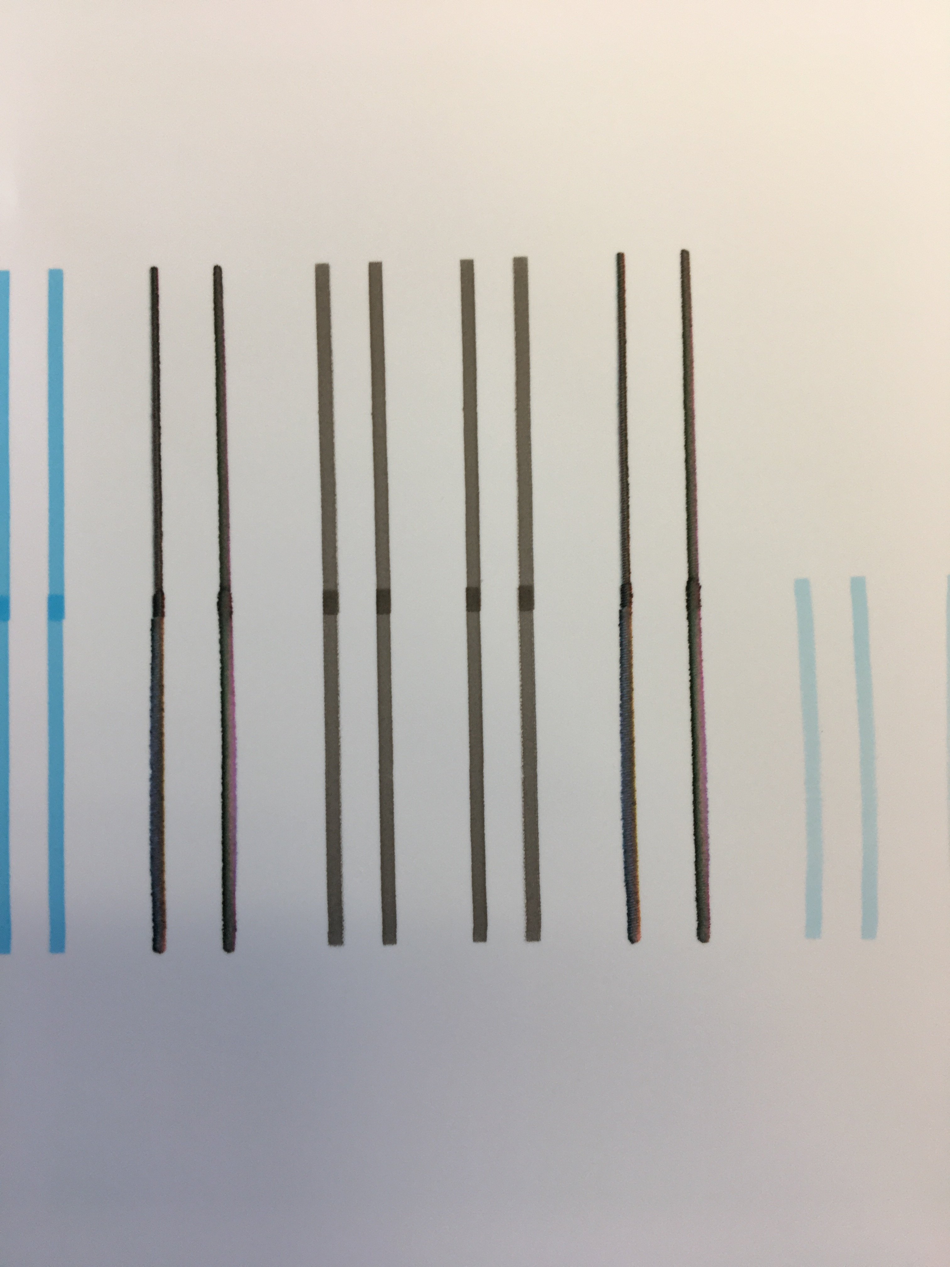

Thank you for your feedback! After looking into it the training cable looks fine. Everything is in the place that it needs to be in. The vertical line has completely gone away but I am having issues with my alignment still. Here is a picture. Going to try a printhead alignment to see if that fixes it.

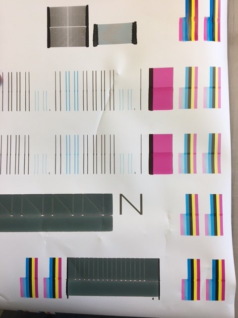

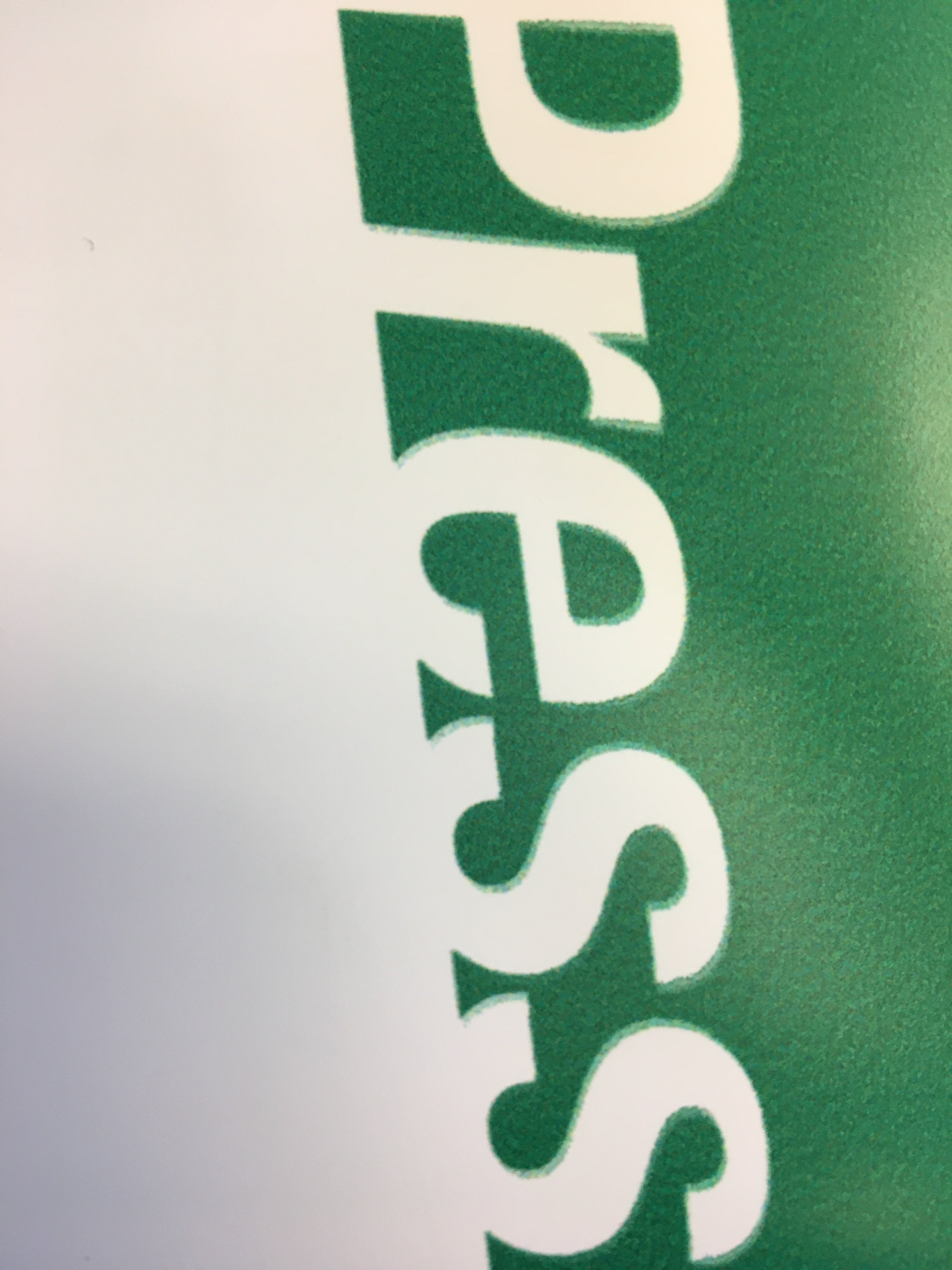

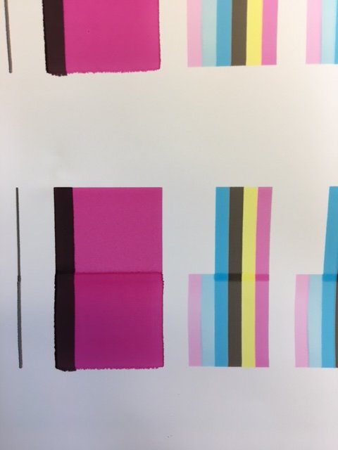

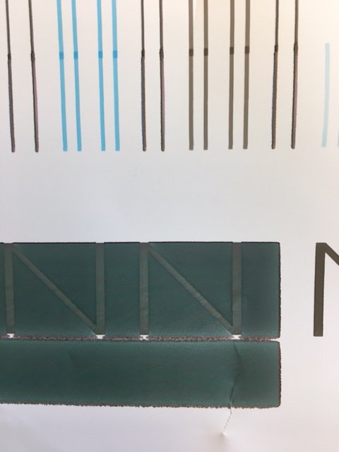

Ran a print head alignment test and it looked like this. Checked my print heads and my optimizer was bad so i replaced it. Ran another test and it still looks the exact same. Any thoughts?
