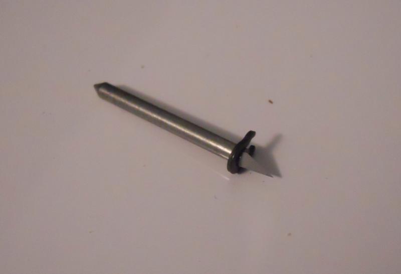

I just got my brand new Roland VS-300I and so far I love it ! Since I make a lot of ATV graphics the sales man was nice enough to give me a blade for the think lamination .. Problem is I really never used a blade like this before and I''m not too sure of how to set it up .. Also notice it has a clip on it ?? Any advice would be great .

I have a 300v -- and had issues getting enough pressure cutting the convex and the super thick laminate. Is the ring for shipping and tip protection?

I'm thinking the same-that the circlip was for transport protection of some kind.
We have a blade like that, made for thick sandblast mask.

Thanks for the help , I did contact the sales guy and he did confirm that the clip does need to be removed.
Info for other people :
Offset 1.00
The blade is a Roland ZEC-U3100
This 60° high performance blade is used for cutting the thickest materials.
It is excellent for use with sandblast, reflective and heavy floor laminate materials. The Roland part number ZEC-U3100 is compatible with all Roland vinyl cutters and printer/cutters.
