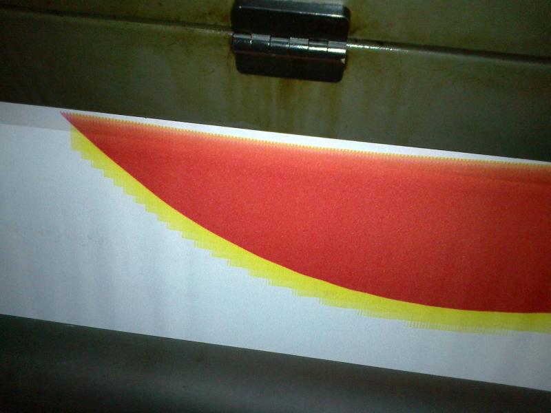

Since this morning my prints began to look like the attached. yellow prints all over the place, it comes inside the text around the objects all over. can anyone suggest the possible cause? really stuck with it. the print head was replaced two months back.

Is this supposed to be a part of a red curve?
I have never seen that before.
It could be a wiring issue as you have had the print head replaced.
Maybe it has come loose.
I'm struggling on this one!

it was indeed head cable issue, didn't take it apart yet, just gave it some gentle pushes, and it has begun behaving.
