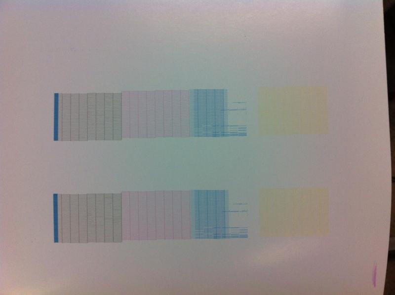

We've recently had our Mimaki JV3 160SP completely crash. We sent our mainboard in to Mac Media and they quickly fixed and sent back to us. The printer has been working well all week, except for the fans which I fixed by replacing the cable from the IO2 to the Mainboard. After replacing the cable I got a very strange test print. Here is the pic.... photo 3.jpg

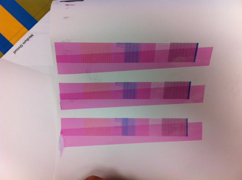

I pulled ink through the magenta head and after a while I got this test print.... photo 1.jpg

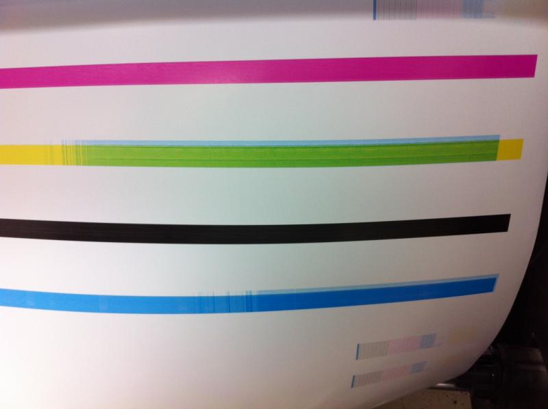

I am almost positive it is not a cyan head issue. To confuse matters even more I tested the heads one at a time and I got this.... photo 2.jpg
Why in the world did the cyan show up in the yellow test print?

have you checked encoder strip? because that looks like wrong information going to the printhead...
check it via service menu, encoder strip.. check all values must be alphanumeric data and not 0000.
